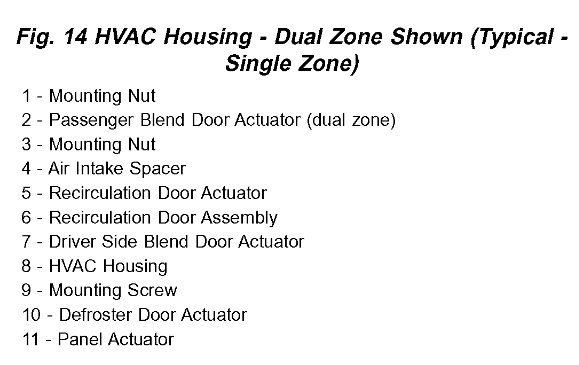

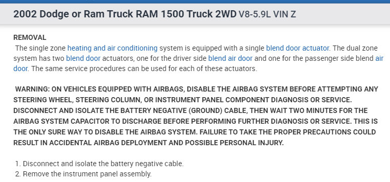

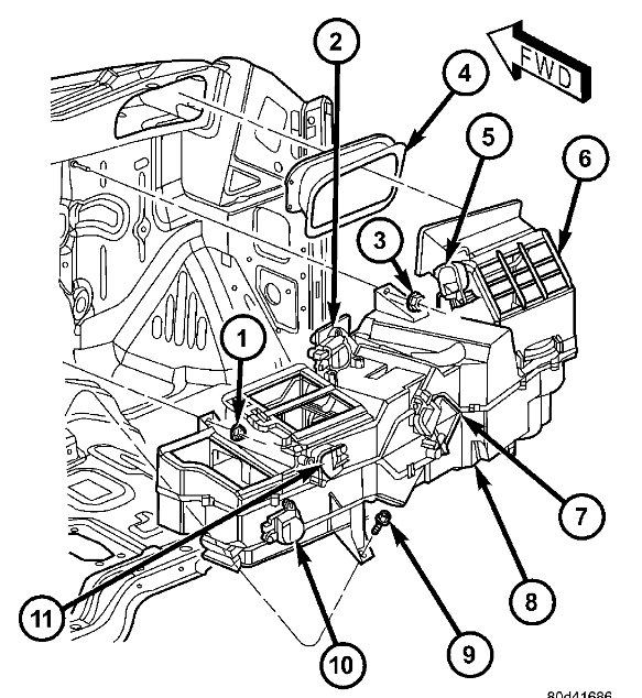

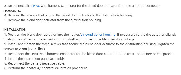

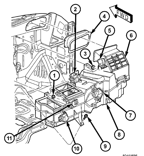

Hello, I'm Danny.
Yes, it sounds like you are having trouble with the blend door actuators.They are small electric motors that open/close a flap to direct air through the specific vents.Here is a tutorial showing how to replace:
I've attached step-by-step instructions below for replacement and also their location.There is a driver and passenger side actuator.Hope this helps and thanks for using 2CarPros.

There's not a clicking sound in the dash when the trucks running or I turn any of the controls. The actuators look like they turn like they are supposed to. How do you recalibrate the system?
