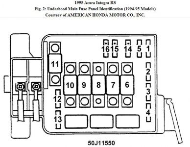

The fuse keeps going off and the car does not start.
Thursday, January 26th, 2017 AT 6:26 PM (Merged)
KHLOW2008
  • 41,814 POSTS
Hi acuralover95,
I would like you to indicate to me which fuse is blowing from the two diagrams below and the rated ampere.
https://www.2carpros.com/forum/automotive_pictures/192750_FuseBoxHood95Integra_1.jpg
https://www.2carpros.com/forum/automotive_pictures/192750_FuseBoxDash95Integra_1.jpg
