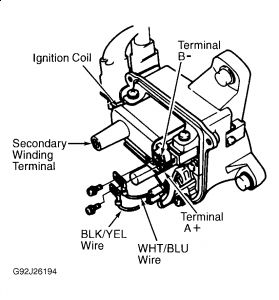

Working on a friends car. She had it in one of the "import shops" here in the town we live in, and they diagnosed the problem as a fuel pump. I am trying to get my own shop up and running, and she decided to bring it to me. I confirmed the fuel pump was not working, got her a new pump, filter, strainer. Got everything in and have fuel pressure through the fuel rail, but would not fire. Pulled two spark plugs, and turned it, no spark. Checked for voltage on the Black/yellow distributor wire and have 12.6 v for igniter run, and ignition starting. Pulled distributor cap, checked the points and rotor, look good, cleaned them up a little. Tested the igniter coil, and have 0.7 Ohms resistance on the primary, 13.9 on secondary. I am thinking it might be something unplugged that the shop who first looked at it did, but I cannot find anything unplugged. Please give me a few ideas on where to look or test next. By the way, check engine light does come on and shut off after two seconds when key is turned.

If that is the resistance you got between terminals A and B, that is perfect. The secondary resistance between terminal A and the secondary tower resistance should be between 12,800 19,200 ohms at 68 degrees, so it sounds like the coil is good. Here is a picture if it helps:
https://www.2carpros.com/forum/automotive_pictures/249084_coil_2.jpg
Now, is the igniter working properly. Follow these directions to check it:
1) Remove the distributor cap and rotor.
2) Disconnect the black/yellow, white/blue, yellow/green, and blue wires from the igniter .
3) Turn ignition on. Check for power between the black/yellow wire and ground. If voltage does not exist, check for an open between the igniter and the ignition switch. If there is power move on to number four.
4) Check for power between white/blue wire and ground. If no power exist, check the wire for damage. If there is power, move on to next step.
5) Unplug the PCM wiring harness and check for continunity in the green/yellow wire between the PCM and the ignitor. Also, check continunity of the blue wire between the ignitor and tachometer.
6) Replace or repair wiring as necessary. If there are no wiring problems, replace the ignitor.
Let me know if this helps or if you have other questions. These types of problems can be difficult but I think the ignitor is the problem. Let me know what you find. Keep in mind, if they removed the PCM wiring harness, it may not be properly reinstalled.

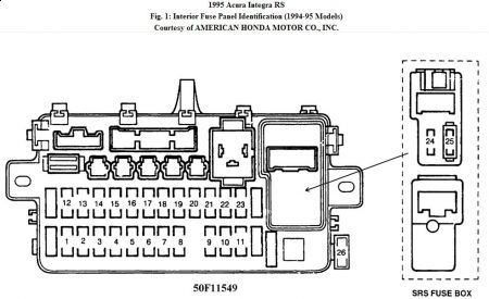

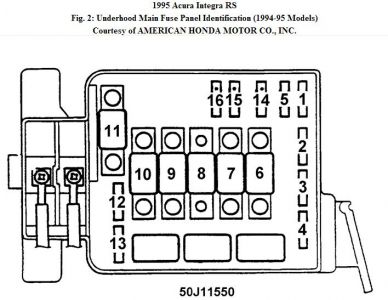

Hello, My car is not starting up, my engine cranks but it does not start, there is spark and when I turn the key to the on position the check light engine does not come on and also I do not the hear the fuel pump prime. But when I open the tank I hear the pressure relieving. Please and than you for the help.

ANDREWZDANAME
If you want I could upload a picture of the dash fuse box and hood fuse box.
Thursday, January 26th, 2017 AT 6:25 PM (Merged)
Check all fuses with a test light.
No check engine light is a clue for a bad PCM.
ANDREWZDANAME
Bad PCM? I looked at the fuse diagram that under the dash and the fuses that say 7.5 amps have fifteen amp fuses if that is normal. But they all work.
