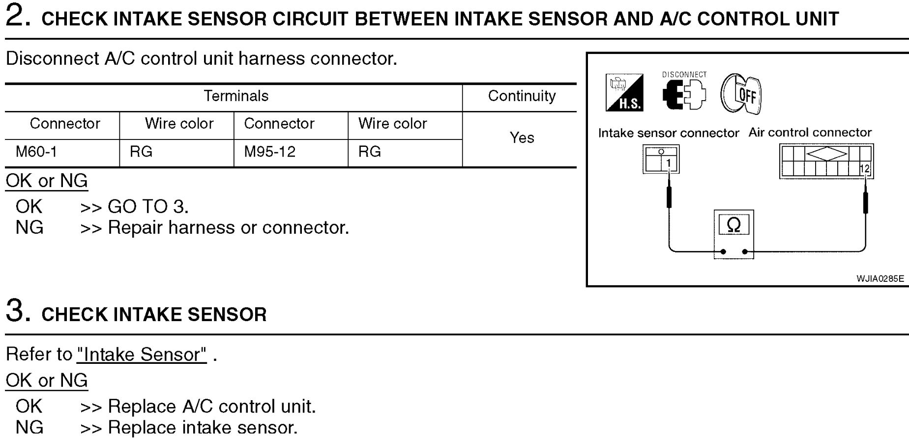

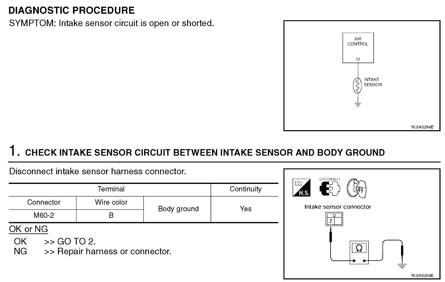

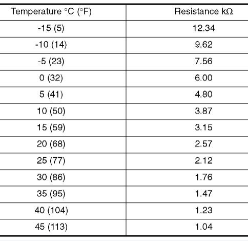

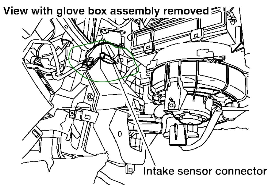

The connector for the sensor is outside the case above the blower motor. With it unplugged you can test for the resistance using the table. If it isn't correct then it gets replaced. That could be tricky as the sensor is actually set on the evaporator core. The book tells you to remove the core to replace it but if you could reach in there through any opening and get to the core you might be able to just stick the new one in there and connect it up. I know of one person who reached in through the cabin filter opening.
To check if it's freezing up would involve seeing the intake side of the core.

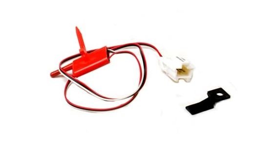

A1953
  • 40 POSTS
Hello again,
Steve, I gained access to the car again. Couldn't read the resistance charts when I magnified them, so I bypassed the thermistor.
A/C seems to work fine with thermistor bypass. So I guess I will just replace that. Do you have a good source and if we run the A/C without the thermistor to control, is intermittent use okay?
