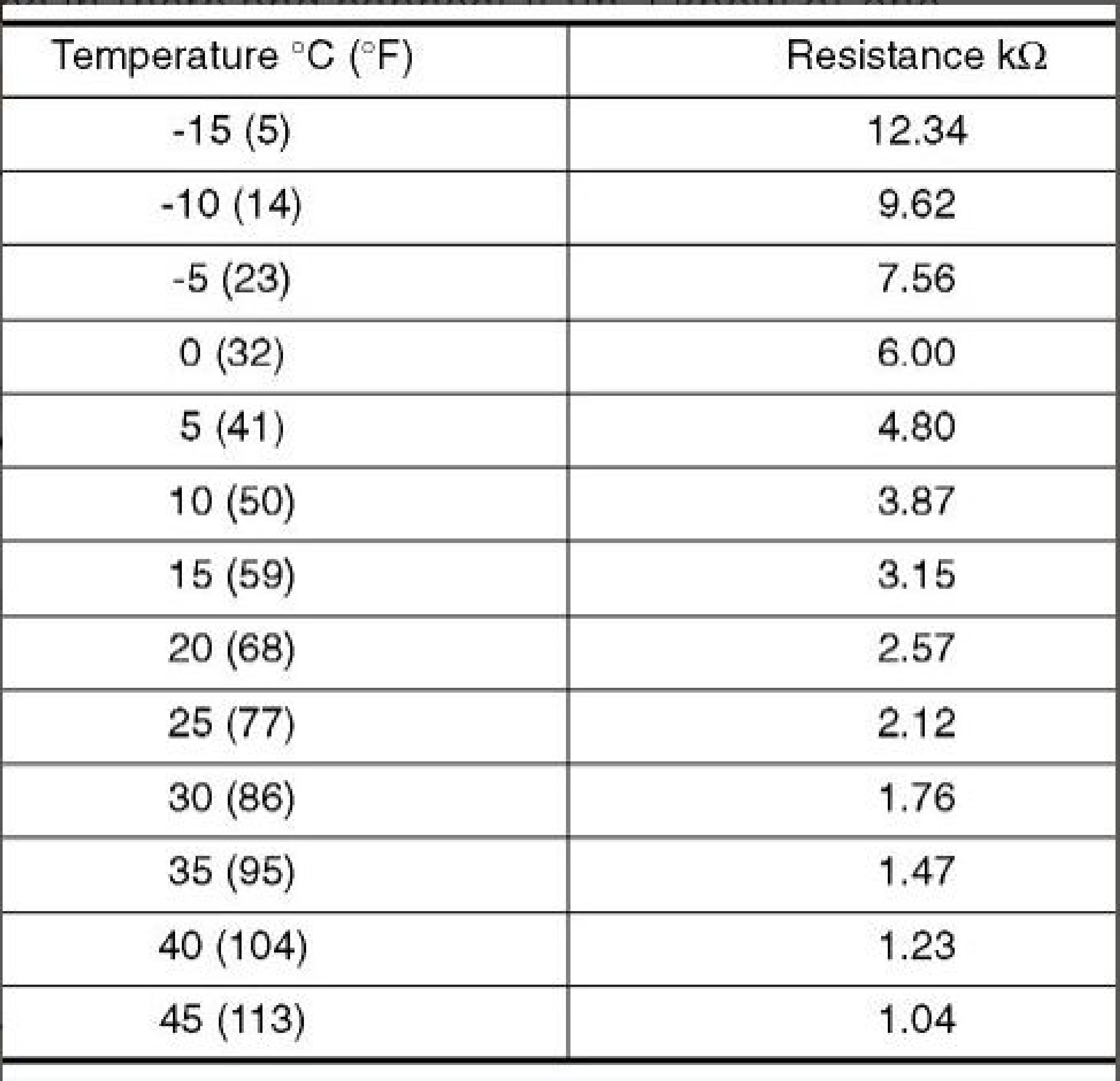

Try this chart. Should show up very large if you just click on it. The thermistor controls a couple items to keep the core from icing up, You might be able to run without it but that isn't something I've ever tried as having the core freeze up isn't a good thing.

That worked to read the table. Thank you. I will check the resistance out and let you know what I find. If the resistance is correct, and the evaporator is icing up that often, what might be the cause of that?
Understood about running the A/C without the governance of the sensor. Just running it intermittently.

Finally got to try for resistance.273 @ 80 degrees so I guess I will replace the thermistor. Still using A/C intermittently and still working well. Thank you again for sticking with it to the end. That was quite a puzzle.
