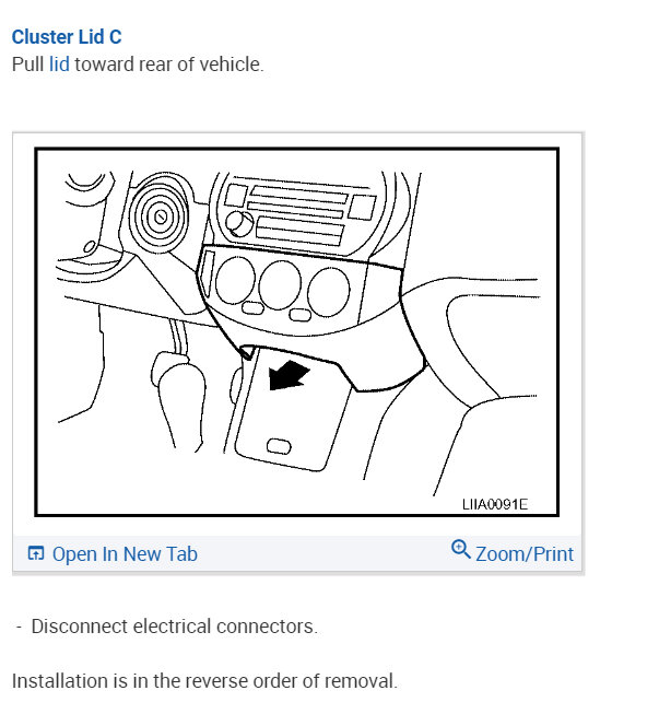

The compressor clutch does not engage. The A/C fuse is good but there is no power to the control side of the A/C relay. I suspect it is the climate control module as the temperature adjustment knob spins freely (more than 360 degrees) with no resistance. How would I confirm it is climate control module? Thank you.

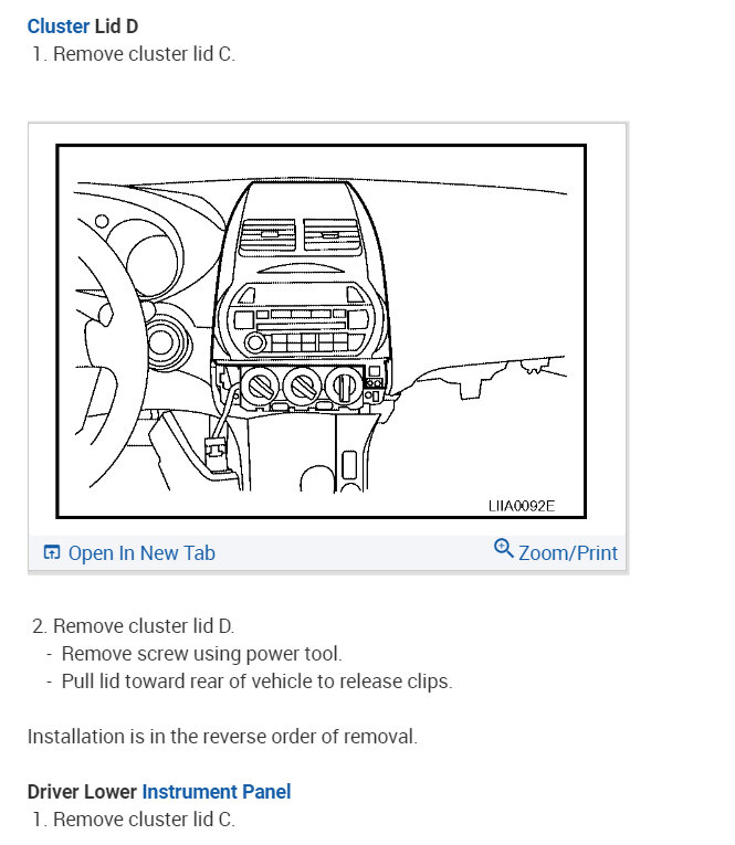

The fact that the knob spins 360 degrees means the HVAC controller is bad, here is how to replace it. Check out the images (below). Let us know what happens and please upload pictures or videos of the problem so we can see what's going on.

Thanks for the reply. The controller is no longer supplied by distributors. I will need to go to the wreckers and will get back to you.

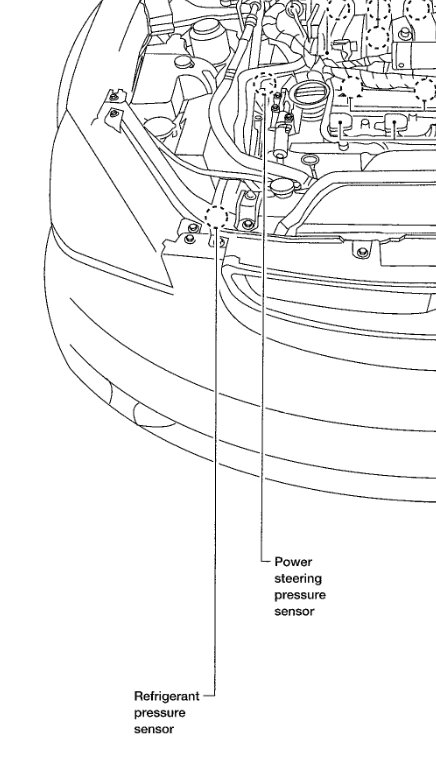

The A/C controller appears to be working correctly. When the A/C is turned on the compressor clutch engages. I am assuming the next step is to check the low-pressure system. Can the pressure be confirmed by using a small can of refrigerant? Also, should the low-pressure sensor be checked? I could not find this sensor on the low-pressure line. Thank you.

Yes, you can check the low side with the recharge can, here is a video to help and I have included the low side pressure switch location as well:
https://youtu.be/uZrQCGwXfek
Check out the images (below). It does not say if it is the lower or high side pressure switch so let me know if the sensor is in the high side line. Please let us know how it goes.

This pressure sensor is the only sensor visible for the system. It is located on a fitting attached to the condenser. The line from the compressor goes into the fitting at the top. A small line from the bottom of the condenser goes into the bottom of the fitting and then exits the fitting just below the compressor line. The sensor is located between the entry and exit points of the small line. It appears to be monitoring pressure on the line exiting the condenser.
What are your thoughts as to the problem and what to do now?

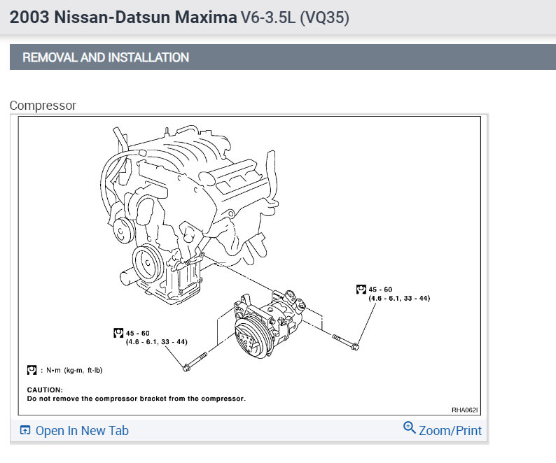

The low pressure was about 20 PSI before adding refrigerant. One can of refrigerant brought the pressure up to about 28. The system seemed to be running perfectly, blowing cold air. But thinking the pressure needed to be about the middle of the blue zone (35 PSI) I added more until the pressure was 35 PSI. The compressor started making noises (continuous groan) and was cycling on and off. Using the gauge hose, I bled the pressure back to about 30 PSI. The system cycling stopped but the compressor is still making a noise. Other than the noise everything seems to be working great. Should I bleed more off to quiet the compressor? Is there something else you'd suggest?
Sorry, but I don't have a high-pressure gauge. The compressor appears to turn on normally when the ac control is turned on.

Knowing the high side pressure can tell us more, if the pressures are correct and the compressor is making noise it may have too much oil in the system or the compressor is going bad.
Here is a generic guide to help you step by step with instructions in the diagrams below to show you how on your car:
https://www.2carpros.com/articles/replace-air-conditioner-compressor
Check out the images (below). Please let us know how it goes
