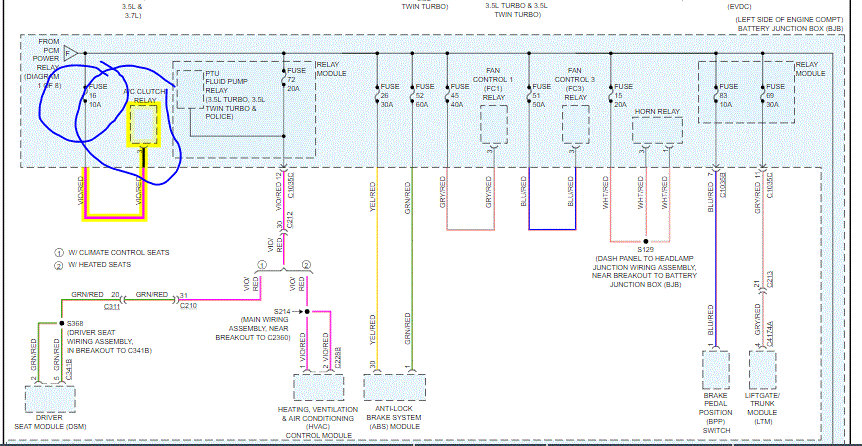

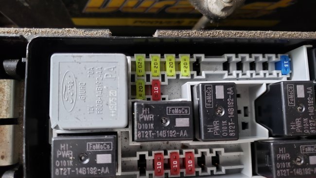

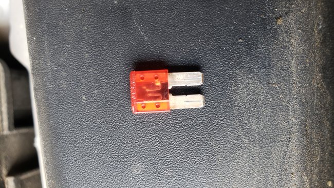

Fully charged, doesn't appear to be any leaks. Fuse was blown. Replace fuse. Fuse is blown immediately again. Compressor? Something else?

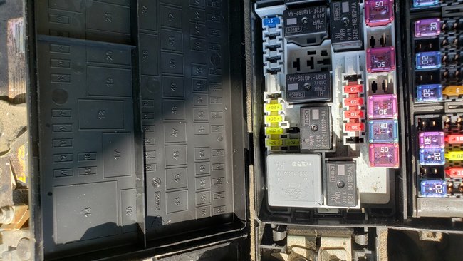

Can you tell me the fuse number or post a picture of the location?
Disconnect the A/C compressor and see if the fuse still fails.
Thursday, September 10th, 2020 AT 12:28 PM
TRAEN
  • 9 POSTS
16 - A/C clutch. Definitely blown.
+3
Thursday, September 10th, 2020 AT 1:27 PM

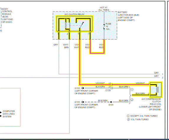

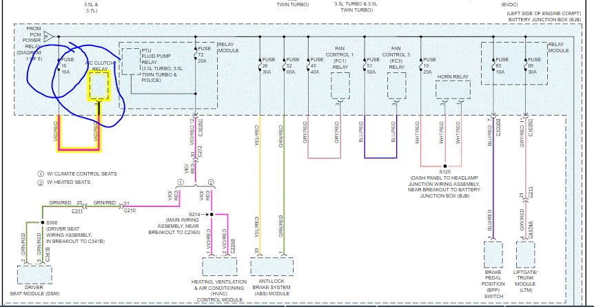

Okay, it only controls the clutch relay.
Did you disconnect the clutch as I suggested to see if it fails?
I attached the diagram for you.
+1
Thursday, September 10th, 2020 AT 1:32 PM

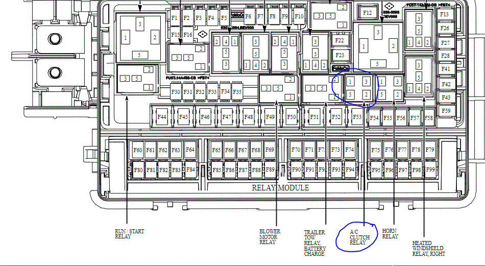

I also attached the location of the relay and a wiring diagram for you.

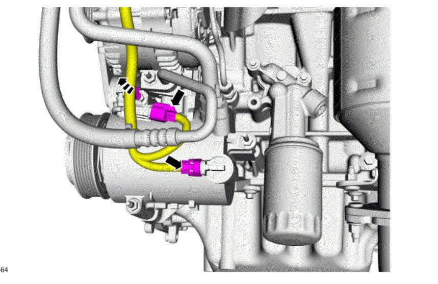

Yes, remove the connector at the compressor clutch and install a new fuse.

I disconnected what I believe to be the clutch relay in the photo. It did not blow the fuse.
-1
Friday, September 11th, 2020 AT 7:39 PM
I asked you to remove the connector at the compressor, not the relay.
The reason is this, if the relay has stopped the short, it means there is an issue between or at the relay down to and including the compressor.
If you remove the connector at the compressor and the fuse fails, then we have to check wiring up to the compressor.
If the fuse does not fail, the compressor needs to be replaced.

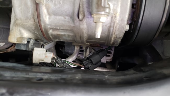

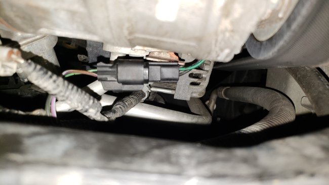

Please remove the connector at the compressor and re test. I attached a picture of the connectors.

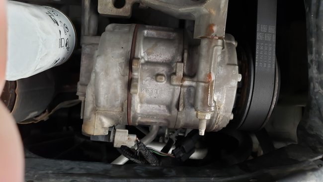

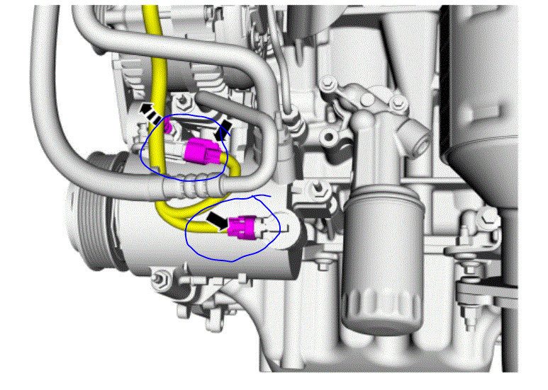

I reconnected the relay. Put a fuse in slot 16. Disconnected compressor wiring. Started vehicle. Turned on air. Fuse is not blown. Also included a photo that there is some oil underneath the compressor.
Saturday, September 12th, 2020 AT 2:07 PM
TRAEN
  • 9 POSTS
I'm not 100% confident I disconnected the wiring correctly. Please check that picture I included. The black connector, which I think is the relay, is connected but the gray connector at the compressor, furthest from the clutch, is disconnected.
Saturday, September 12th, 2020 AT 2:12 PM
Good.
You need a compressor for the repair.
You will need the compressor and the receiver dryer, evacuate and recharge the system.

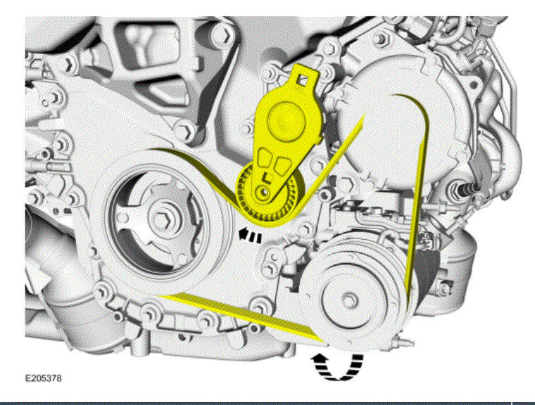

Rotate the A/C compressor belt tensioner clockwise and position the A/C compressor belt off the A/C compressor pulley.

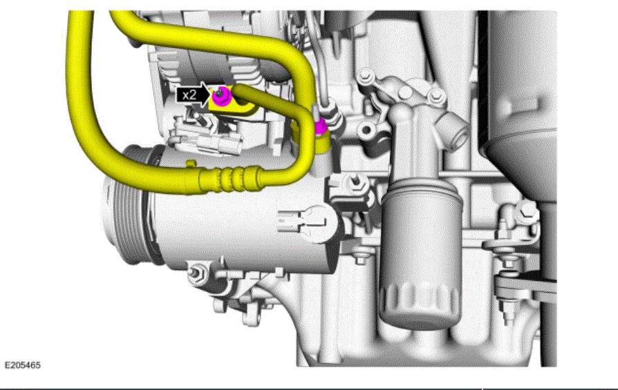

Remove the A/C compressor inlet and outlet line nuts and disconnect the fittings. Discard the O-ring seals and gasket seals.

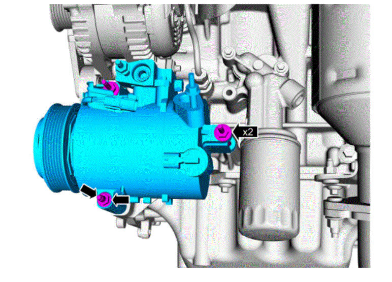

Remove the nut, studbolts, stud and the A/C compressor.

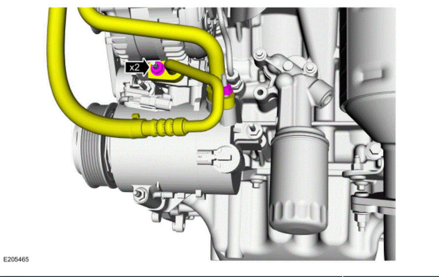

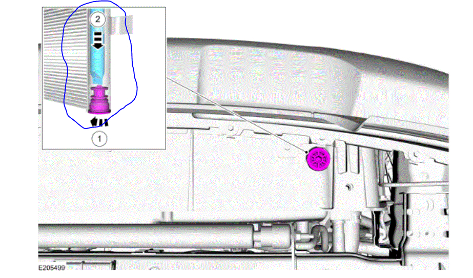

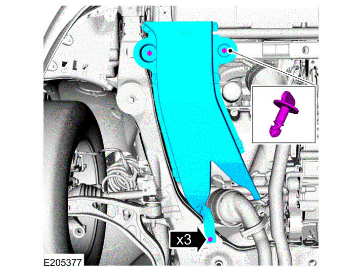

In the e205377, I see a plastic cover that needs to be removed. Does that require removing the front bumper cover and the radiator to access?
Sunday, September 13th, 2020 AT 8:40 AM
No, it does not. It is in the open and has plastic pins that hold it.
