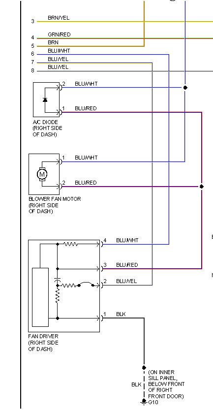

On yesterday at the start of my day it was working. I made two stops. After my second stop I noticed my air was on but not blowing on the maximum level. I can feel the air coming through the vents and my overhead air is working fine.
Thursday, July 16th, 2020 AT 12:06 PM (Merged)
STEVE W.
  • 15,697 POSTS
Do you mean the air is blowing but not as hard as it was ( do all the blower speeds work?) OR that the air is blowing OK but it's not as cold as it was?
Those are different issues. Also do you have the automatic system (set it to a temperature on a digital readout) or the blue/red manual system.

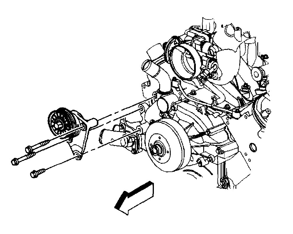

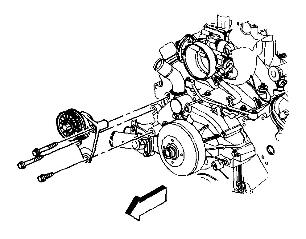

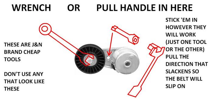

Replaced clutch, compressor and belt and the belt is still slipping. Already burned up one replacement clutch so replaced compressor too the second time.
Thursday, July 16th, 2020 AT 12:07 PM (Merged)
  • 110,194 POSTS
Welcome to 2CarPros.
Have you replaced the belt tensioner? It may not be holding enough pressure on the belt and allowing the clutch to slip.
Here are the directions for replacement:
2003 GMC Truck C 1500 Yukon 2WD V8-4.8L VIN V
Drive Belt Tensioner - Accessory
Vehicle Engine, Cooling and Exhaust Engine Drive Belts, Mounts, Brackets and Accessories Drive Belt Tensioner Service and Repair Procedures Drive Belt Tensioner - Accessory
DRIVE BELT TENSIONER - ACCESSORY
Drive Belt Tensioner Replacement - Accessory
Removal Procedure
1. Remove the accessory drive belt.
Pic 1
2. Remove the drive belt tensioner bolts.
3. Remove the drive belt tensioner
Installation Procedure
pic 2
1. Install the drive belt tensioner.
2. Install the drive belt tensioner bolts.
Notice: Refer to Fastener Notice in Service Precautions.
See: Engine, Cooling and Exhaust > Vehicle Damage Warnings > Fastener Notice
3. Tighten the drive belt tensioner bolts.
Tighten the bolts to 50 Nm (37 ft. Lbs.).
4. Install the accessory drive belt.
