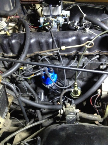

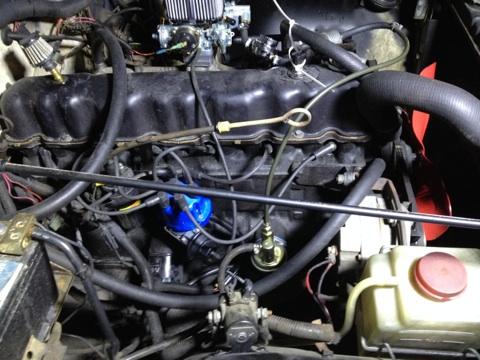

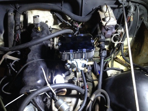

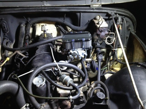

Send me some full view engine pics--left and right sides and a good one from the top. More light would be nice!

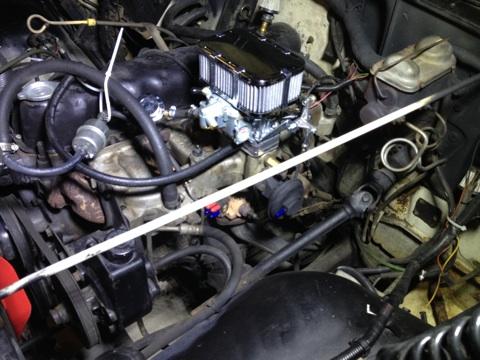

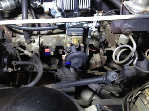

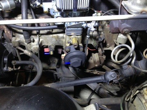

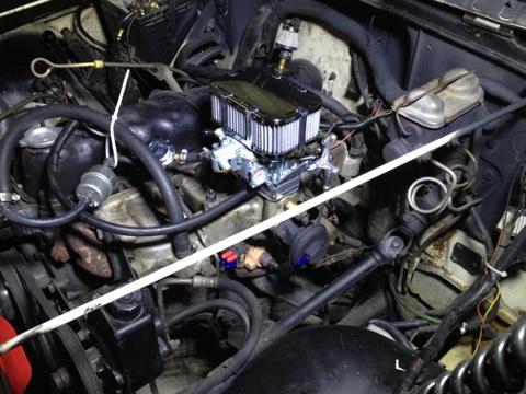

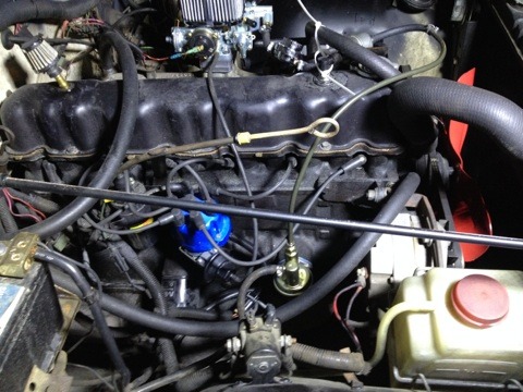

Here are some overall shots of the engine, this was taken late last night but under a really good light.

Lovely!
Gimme a little time
I'm gonna copy / edit/ blow them up and then go over 'em better than the ranger instructors at ranger school went over our stuff. My critique will be just as thorough, I will probably go over to microsoft paint and point out problems. Then i'll post 'em back to you
As in battalion----you can go ahead and start doin' push ups.I know i'll find a deficiency!
I'll be a while---don't give up on me!

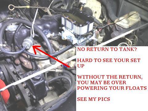

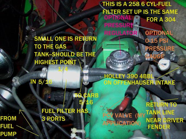

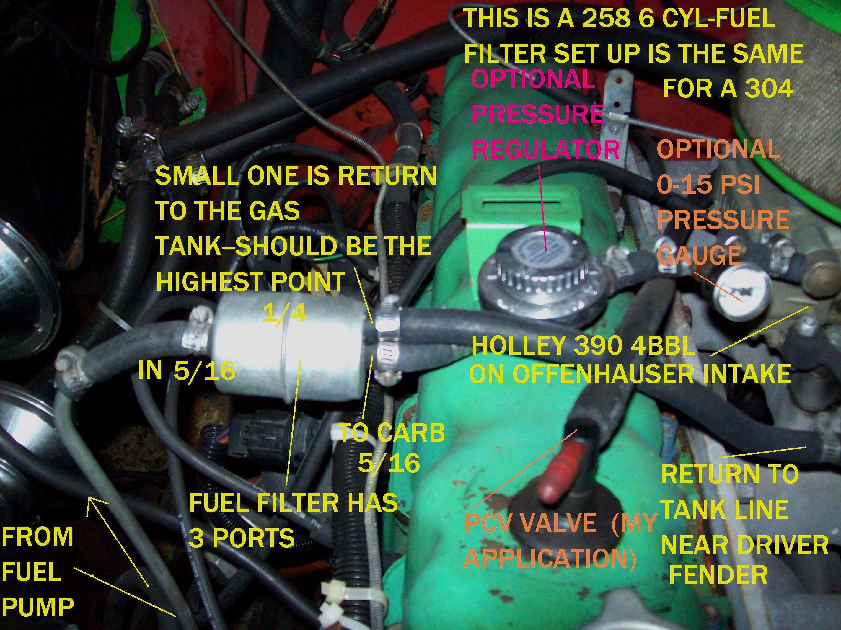

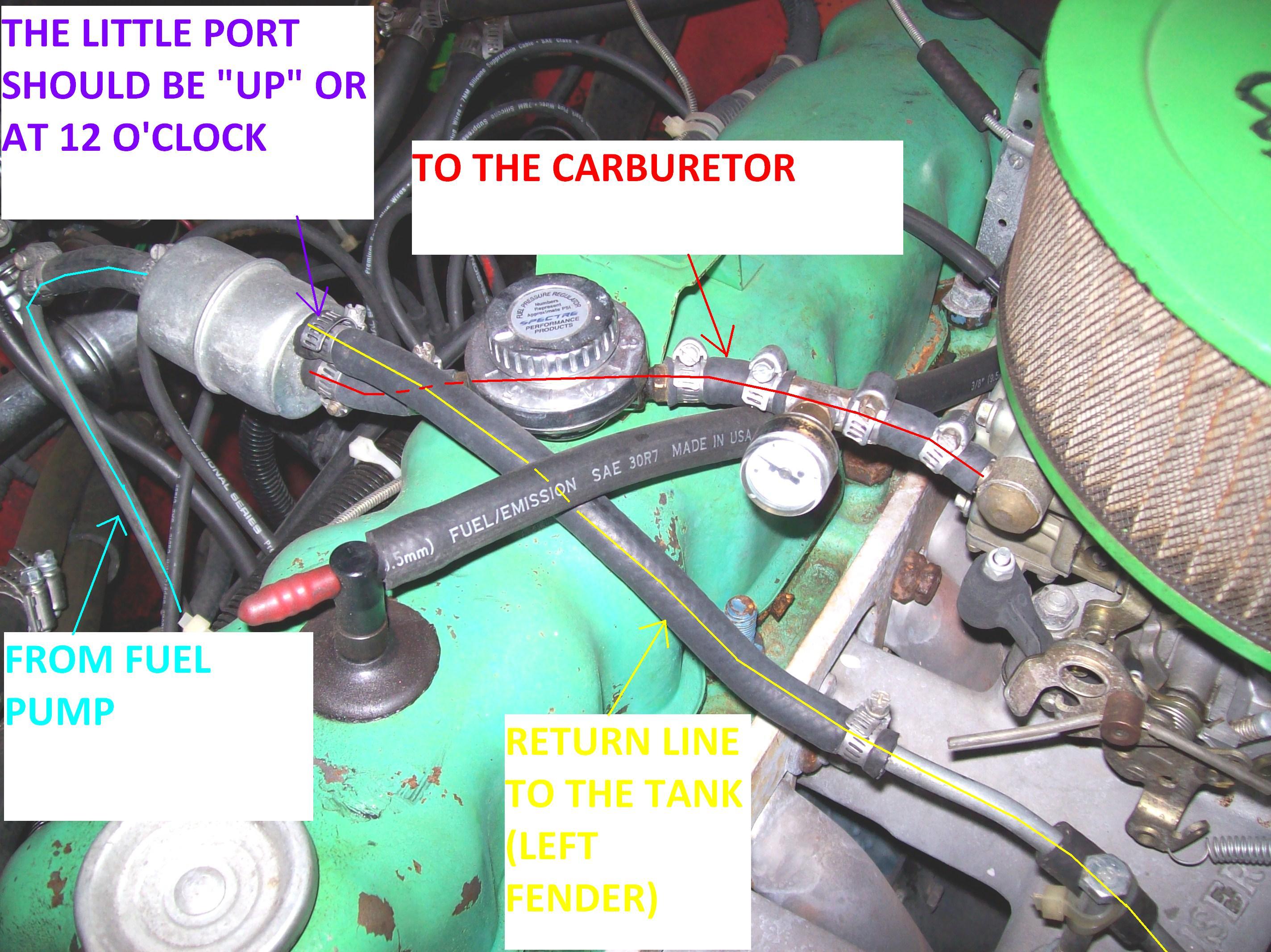

First possible problem

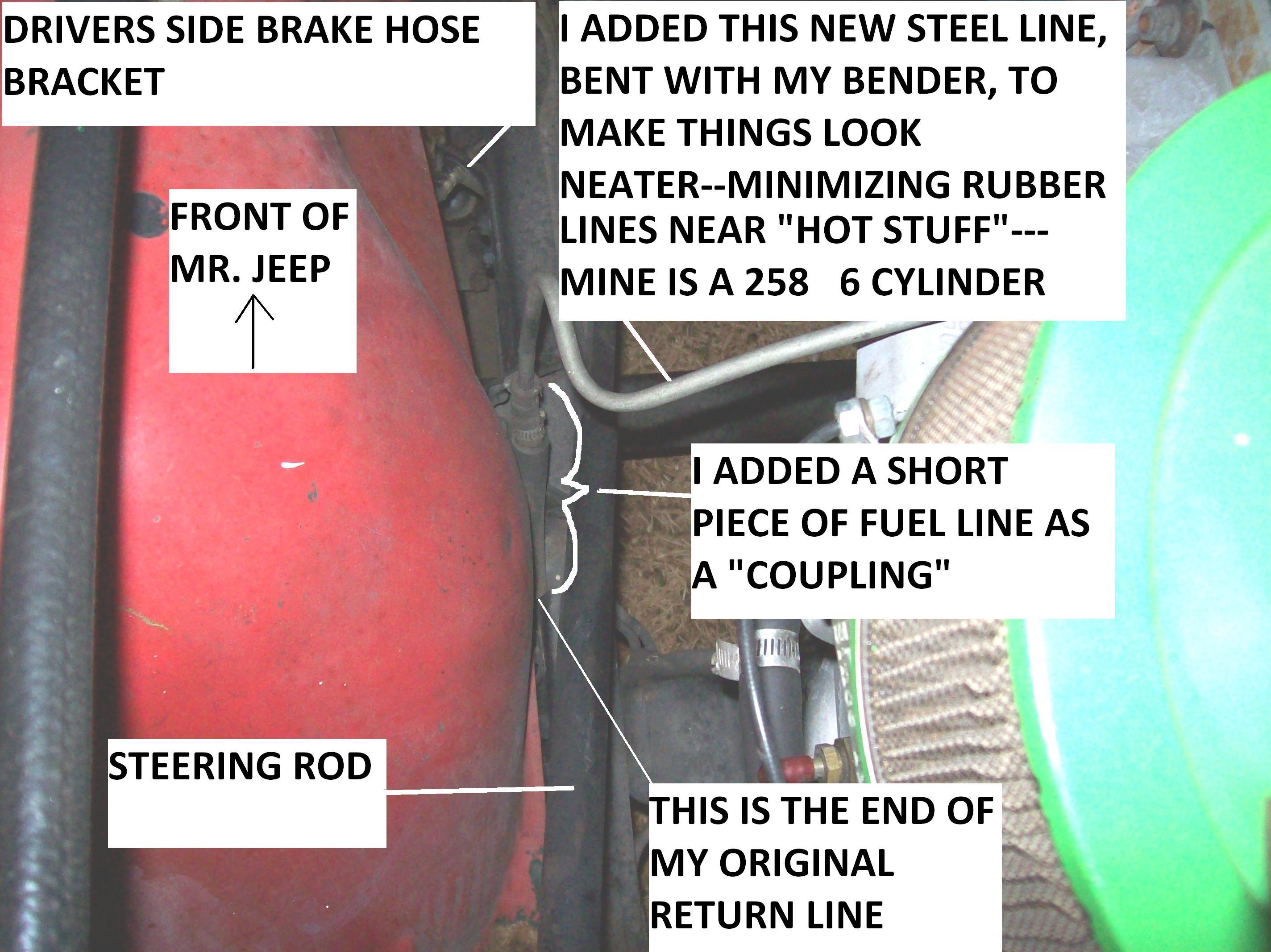

Here's my '77 fuel pics---i have rebent/ installed new lines to make them pertty
Lemme know if you find your return and if it has not been broke off/ eliminated

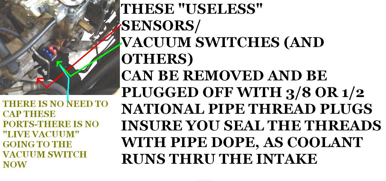

You need to configure back to stockthe regulator will still ok .......see my pics
Lets also change the pcv to a 1979---it sucks in less air volume......you will have to most likely have to re-adjust your mix screw to compensate (this will also affect your idle speed--so adj it too!)......use your dwell/ tach and max out your needle.......i think i covered how to do this in the "stalls when hot" link
Check ot this link----pay attention to the pcv
................and the coil.
....other stuff may not pertain to you
Http://www.2carpros.com/questions/1979-jeep-cj7-stalls-will-restart-after-3-4-hrs-driving-off-raod-on-hilly-terrai

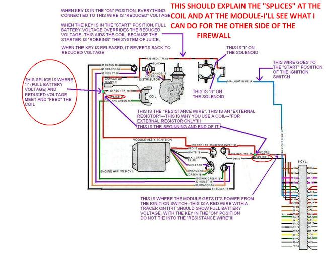

.....i noticed yours was not oem......which is fine, as long as it does not have an internal resistor................., the "high speed lookin' coil" probably ain't much improvement over the stock one

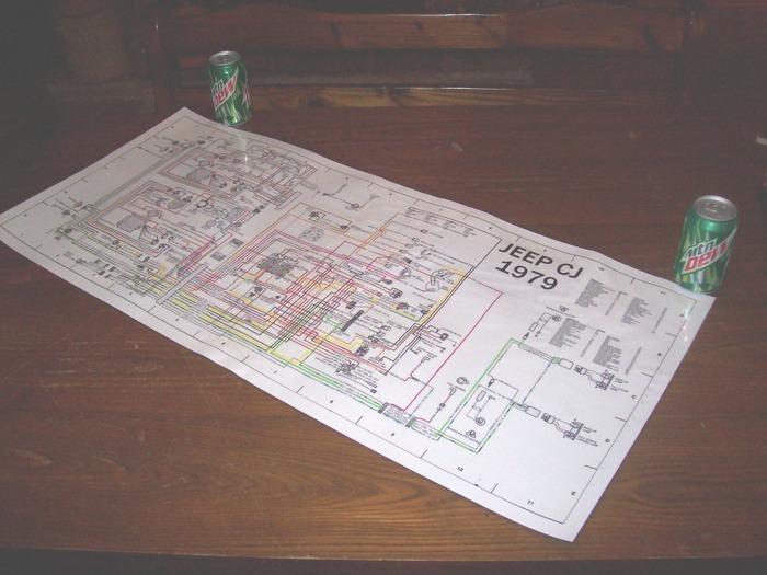

This last pic is from a 1979 wire diagram---it explains the resistor wire

Thanks for the info. I will swap out the PCV to the '79 model today. Its not apparent in the pics but I do have a return line from the fuel filter. It is set up on the top. The two wire ties are holding everything where they are supposed to be. These are temporary as I make something to keep everything away from things that get real hot.
When I popped in the new distributor things went sideways with the Jeep.
Right now I can lean in the Jeep, turn the key and she will fire off but still pumping out black smoke. And it is RICH. I turned the mixture screw all the way in (I know) and it settled some of the smoking down. But it can't stay like that.
It confuses me as the Jeep was running fine til the old Carter crapped out on me. New Weber. Same problems.

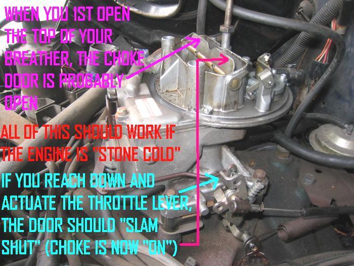

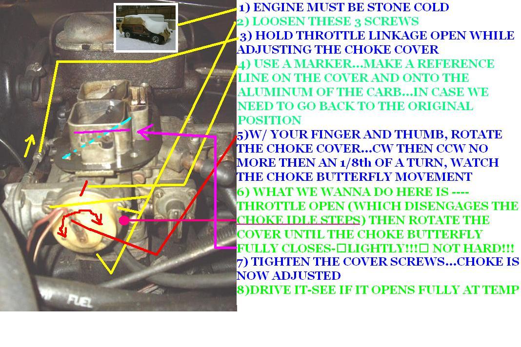

Here's another to look over about the choke
See my 3rd ...."april 13, 2013" answer in this link
Http://www.2carpros.com/questions/1981-jeep-cj7-problem-cj-7-sat-years-started-died-after-about-mile/page/2
