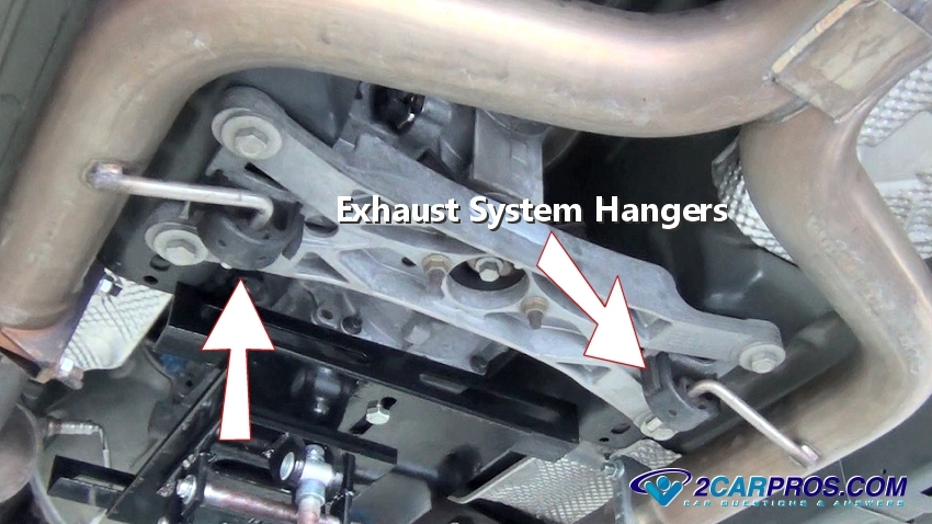

  3. Identify the system hangers which aids in the support of the system under the car frame or body. When removing parts it's good to know what parts with remain at particular points of the disassembly.

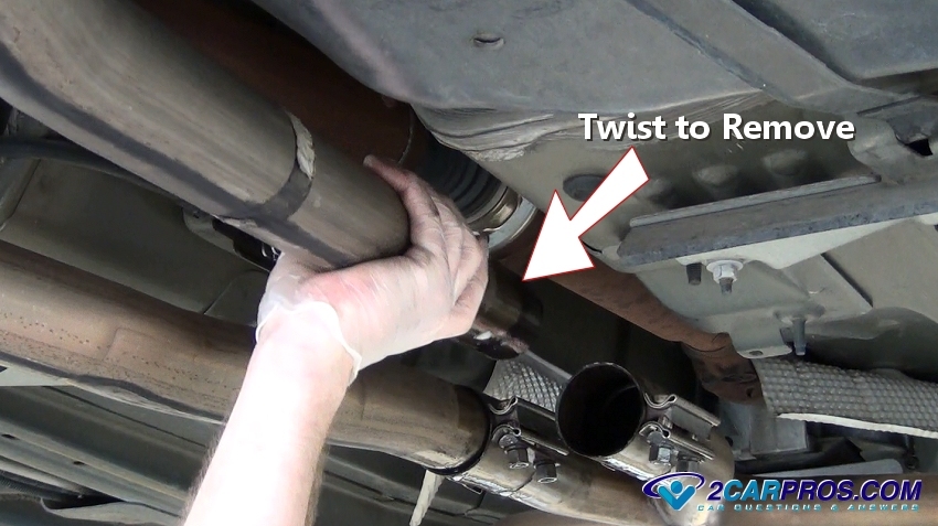

  5. Grasp tubes firmly and twist back and forth while pulling outward to disconnect secondary exhaust or mufflers. A mallet can be used to help jar the tube loose.

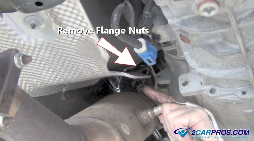

  6. Disconnect the oxygen sensors and then remove the catalytic converter head pipe bolts, be ready to hang onto it. If the converter falls and strikes to ground it can break apart internally which can lead to replacement.

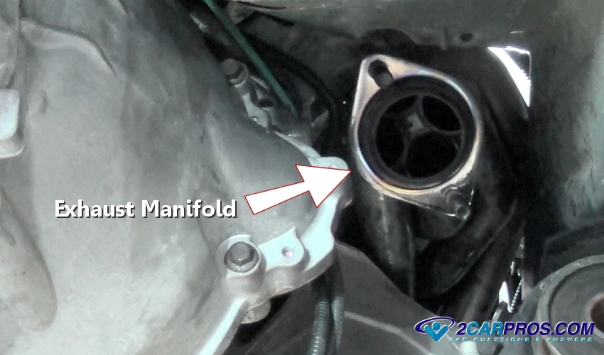

  7. The final item of the system is the exhaust manifolds which if the spark plugs interfere with the removal need to be removed prier. Loosen the manifold bolts evenly to remove the manifolds, these can be heavy.

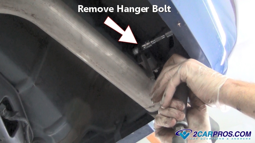

Remove rear exhaust system hanger bolts to allow more room.
remove exhaust hanger bolt
Twist and pull simultaneously to remove secondary tubes.
removing back half exhaust

Locate and remove flange mounting nuts or bolts, the primary section of the system will become loose. The primary system will need to be pulled back away from the exhaust manifolds before complete removal.
remove exhaust flange nuts
Remove primary exhaust hangers.
exhaust system hangers

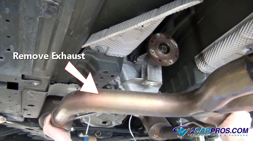

Firmly grasp the primary system and pull outward to remove.
remove exhaust system
Inspect the exhaust manifold flange for damage. (Note: Some systems use a gasket to seal the head pipe to the flange.)
