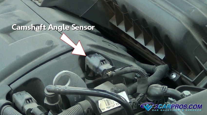

The cam sensor is located in the valve cover near the top of the engine or they can be located at the front or rear of the cylinder head as in the picture below.

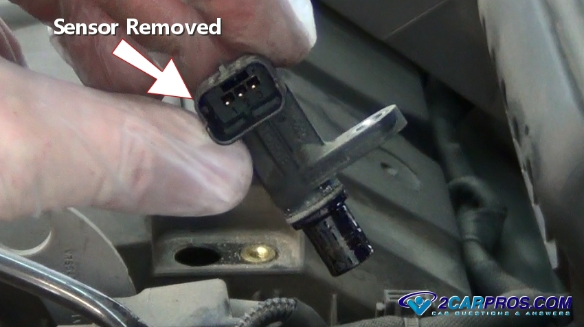

Remove Camshaft Sensor: Locate the sensor by inspecting the front, rear and top portion of the engine. These sensors are in pain sight and will have a two or three wire connector attached to them.
Use a small flat blade (standard) screwdriver or pick to release the electrical connector tab to remove connector from the sensor. Gently pull the connector out from the sensor. It can be a little stuck due to the weather pack seal inside the connector which is designed to keep out moister.

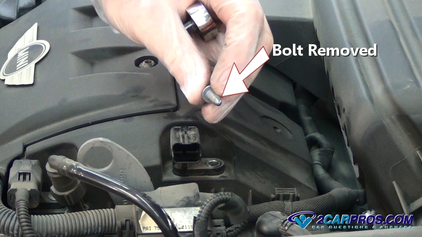

Using a 8mm or 10mm (in most cases) socket or wrench remove the camshaft sensor mounting bolt by turning it counterclockwise. There is usually only one bolt.
Sometime these bolts can be over tightened at the factory which causes the bolt threads to stretch and become weak. Inspect the threads for damage and replace the bolt if needed.
Grasp the sensor and with a twisting motion pull the sensor from the housing. This too can be a little stuck because of the O ring seal which is designed to control engine oil.
Once the sensor is free from its housing or mount inspect the electrical terminals for damage and corrosion which will hinder the sensor's performance.

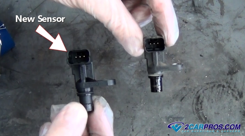

Install New Camshaft Sensor: After the old sensor has been removed wipe it clean so you and compare the new sensor to ensure a proper installation. Be sure the sensor has a new O ring seal to avoid oil leaks once the new sensor has been installed. Occasionally there will be subtle a manufacturer update to the sensor which will change it's appearance slightly.
Use a shop towel to clean the area which will help avoid leaks. Then apply a small amount of engine oil or WD40 to the O ring seal and gently lower the sensor into position. The oil is to help lubricate the seal which will help avoid the seal from getting damaged during the installation.

Insert and start the mounting bolt by hand to avoid cross threading. Avoid starting the bolt while using a socket.
Use a small socket or wrench and tighten the sensor mounting bolt. This bolt does not need to be super tight because is only holds the sensor in place. The specification would be about 2 pounds of torque.
