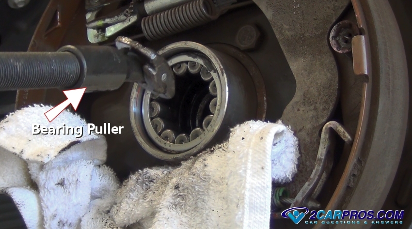

Remove and Install Axle Bearing
Use an axle puller to remove the axle bearing, once installed push the shoe of the puller straight which will help it lock behind the bearing. Then, thrust the anvil outward to start the pulling action, this will take several thrusts to remove the bearing.
bearing puller

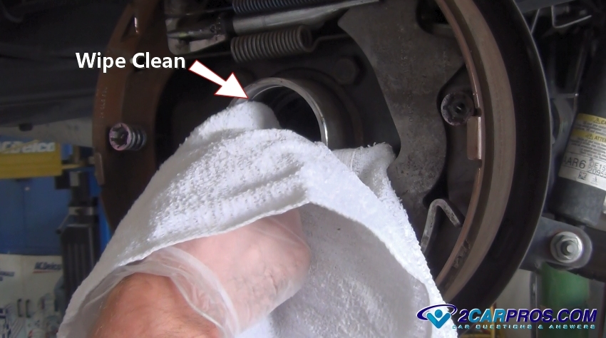

After the bearing has been removed, use a shop towel to wipe the housing clean from oil and dirt. Also check the housing for obvious scoring which can make the new seal leak. If a grove or scoring is present you will need to install the seal using silicone rubber and allow it to fully dry before refilling the differential, preferably overnight.
wipe bearing housing clean

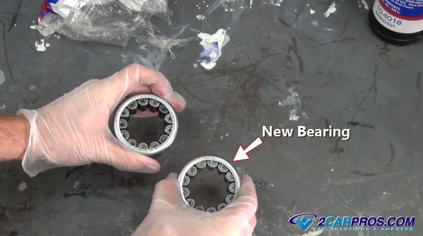

After the bearing has been successfully removed match the old bearing to the new unit they should be an identical match.
new axle bearing
