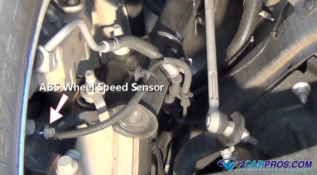

2. Raise the car up to do a visual inspection of the wheel speed sensor wiring, may times road debris or obstacles can tear the wiring from the wheel speed sensor in which case just repair the wiring or replace the sensor.

Since most of the time the problem will be a wheel speed sensor you can test the sensors manually using a voltmeter. Remove the tire to access the sensor and disconnected it, then attach a volt meter and spin the bearing hub, you should get a small amount of AC voltage.

The wheel speed sensor or bearing hub will need to be replaced or wiring repaired. This job is not to difficult and can be done using basic tools and a floor jack.
ABS traction control wheel speed sensor wiring connector
