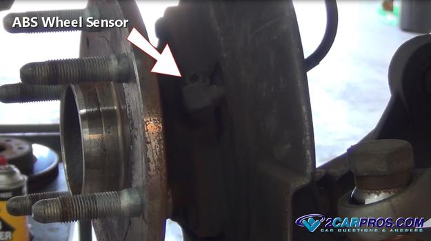

3. Locate the wheel speed sensor near the spindle or backing plate for the brake rotor and remove the mounting bolt which is usually 10mm.
remove abs traction control wheel speed sensor mounting bolt
4. Gently grasp and pull on the sensor body to remove it from its location, it can be a little stuck because an O ring is used to help seal the sensor. Use a flashlight to peer into the sensor port, slowly spin the tire to check the condition of the stator ring teeth.
