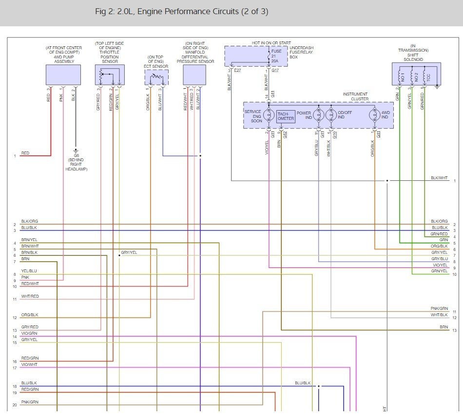

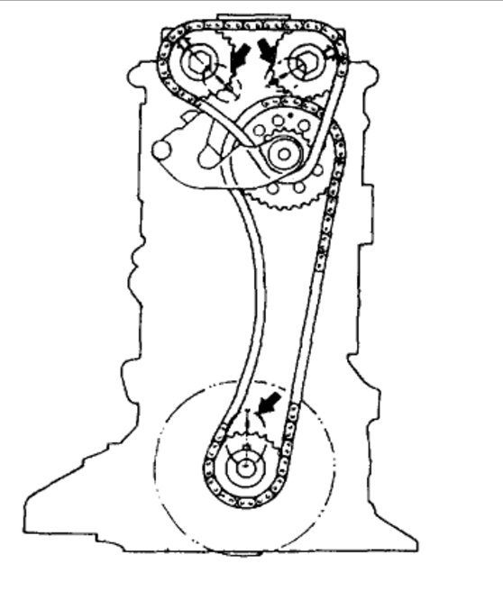

I put a timing chain in this car, someone else had already tried to put the chain on and time it, it did not work. So they brought it to me I took the chain off and timed it myself because it was wrong. I am pretty sure it timed right but I have no fire and no codes. It is getting gas. Is there a ignition module or a coil somewhere that is keeping it from firing?

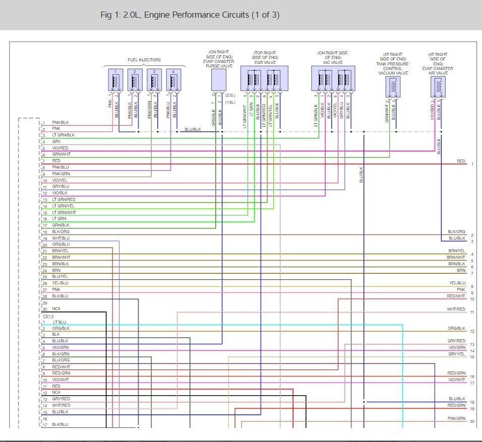

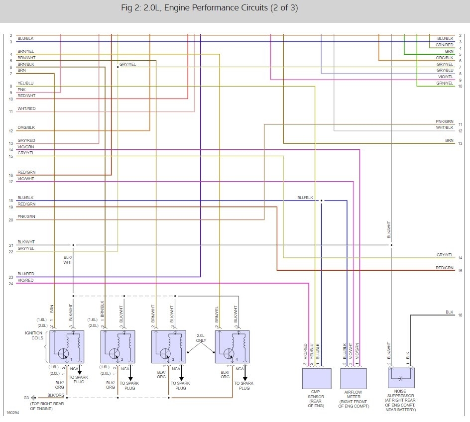

We should check compression to see if there is enough to run this will confirm the timing chain being on as well.

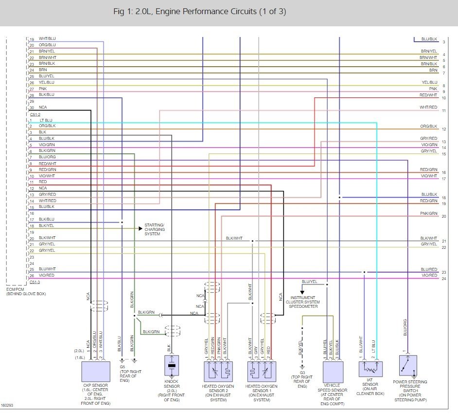

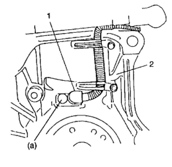

There is a crankshaft angle sensor that needs to work as well. (below) This is what signals the computer to work the ignition and fuel injection.

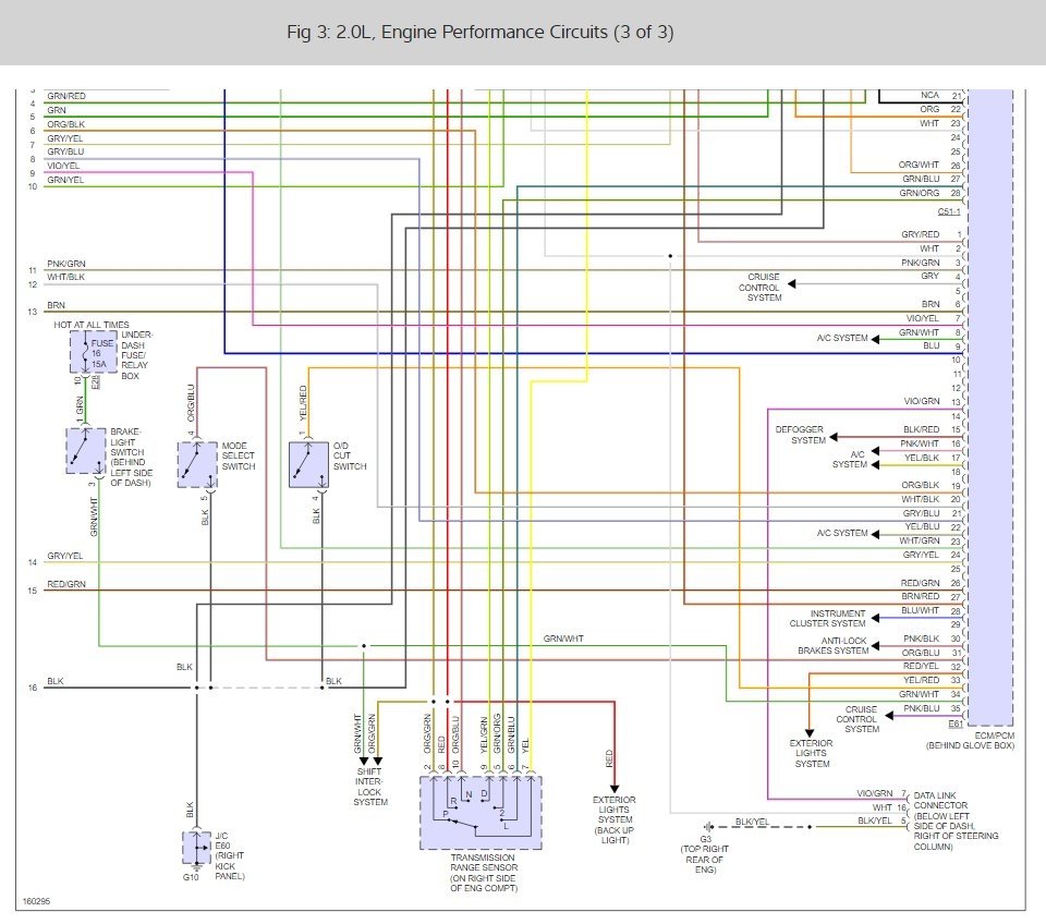

I found the engine wiring diagrams for you well. Use the guide below to test for power at the fuses.
and a timing chain diagram just in case.
https://www.2carpros.com/diagrams/suzuki/vitara/2002
Please run this test and get back to us so we can continue helping you.

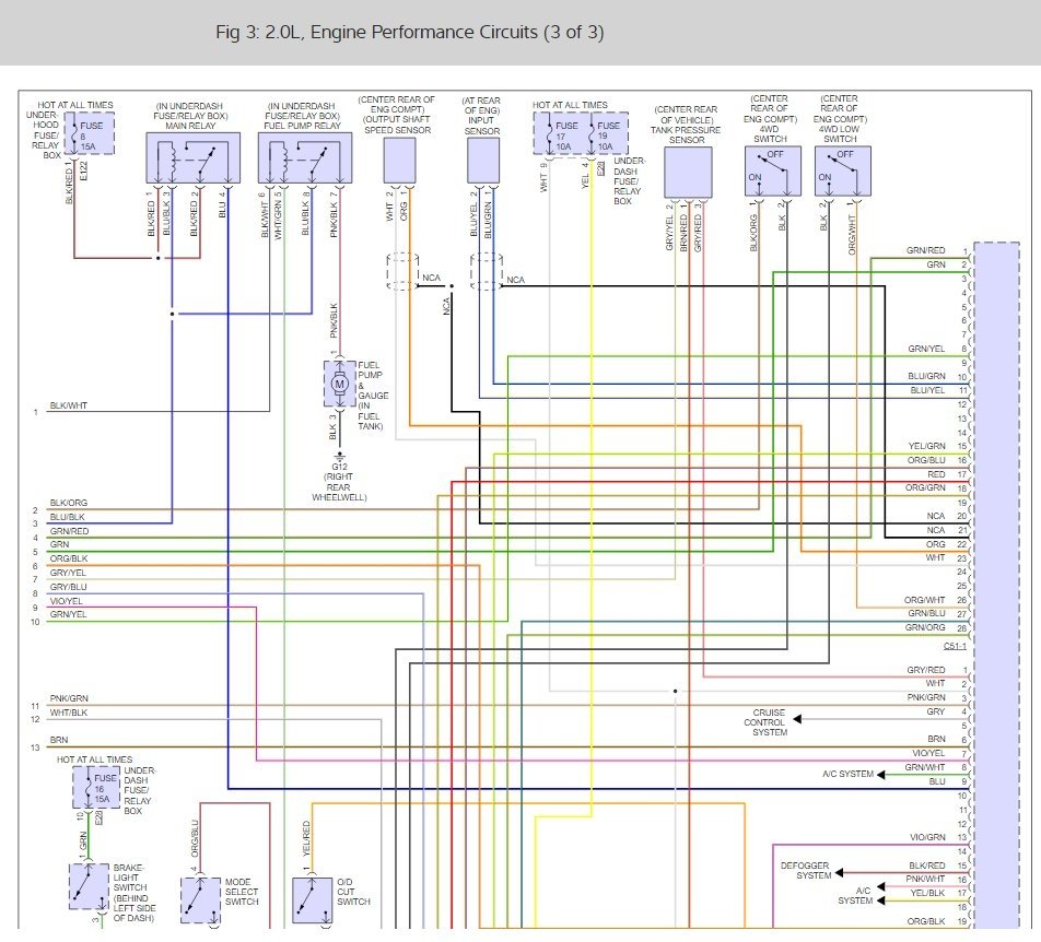

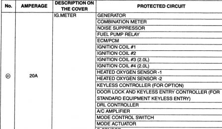

It turns over fine and has good spark but the fuel pump doesn't work so I replaced the pump, strainer, and filter to no avail, no sound from the gas tank at all, there is not a fuse so there must be a relay or two or am I just way off base? Any help would be appreciated and if more info is needed please ask.

It sounds like you have either weak fuel pump or a crankshaft angle sensor that is out.
Here is a guide hat will get us started to see if you have spark and fuel pressure:
and
I posted how to remove one of your coil's leave it plugged in put a plug on the end of the boot of it. Ground the plug and crank it over and look for a blue spark. Let's start there then we will check other thing's.

The problem ended up being the crankshaft angle sensor. Thanks for your time. This site rocks!
