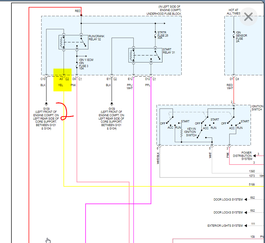

AMBER BERNAL SALWAY
  • 6 POSTS
  • 2007 PONTIAC G6
  • 3.5L
  • V6
  • 2WD
  • 150,000 MILES

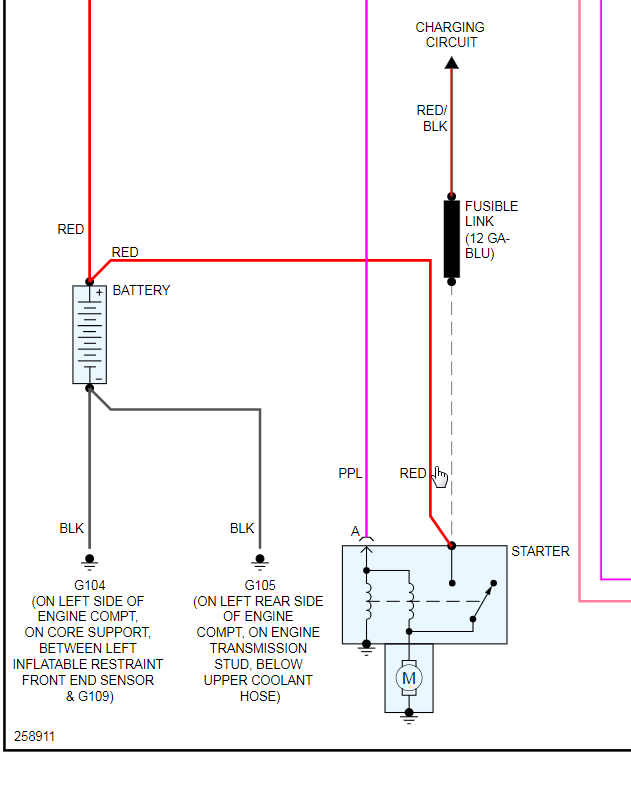

Car won’t crank at all. When hot my husband change the starter and when putting the new starter in my brother in law broke the pigtail and used some butt connectors in its place. Can this be my problem?
Monday, January 4th, 2021 AT 8:43 AM (Merged)
K JENKINS
Kirkman, I know it's been a little while since you posted about your pontiac g6, but i'm having the same issue with my pontiac. Did you ever find out what was wrong with yours and why it wouldn't start? They've replaced the fuel pump and the fuel pump relay and a new fuse box was put in, but it's still randomly not starting. The engine turns over, but it just won't start sometimes. Then other times it's fine. I've found that if I tap or hit the fuse box, it starts up more often than not. If anyone has any suggestions. Please let me know!
That depends. Does the starter have proper voltage on the B+ and signal wire. If you look at the wiring diagram, the red wire should have 12 volts. The pink wire should have voltage when you are cranking the engine. If you don't then you have a wiring issue and butt connectors should be removed first then retested. It is too common for these to fail and the crimp did not actually get the wire secured and so it is an open circuit.
Here is a guide that gives a little more detail:
Let me know what you find and we can go from there. Thanks

The car starts once it’s cooled off, which is every evening about 9:00 pm and first thing in the morning. I live in bullhead city Arizona averages 110 or more all summer months, that being said my issue seems to have something to do with heat. I’m assuming since I can drive to work at 6:50 am and still able to start my car at 10:00 am, now I get off at 3:00 pm drive home and shut my car off it Wont start again until it has cooled down. Strangest thing ever. It makes a faint click sound and all the dash lights come on like their supposed to. As far as my knowledge knows. Thought it could be security issues, got a new key reset it. Set of security alarm and was able to disarm by putting key in ignition. But it still wouldn’t crank or anything. Which led me to believe it is not the security system? Could I be wrong? Started having this problem before putting new starter in which described above, pigtail broke upon new starter instillation. Battery was no good two months later so got a new one. Check all fuses inside and out of car their good. Changed Run crank module, replace starter j fuse. I’m running out of money and most of all patience! Please help me please
And thank you all it’s greatly appreciated!

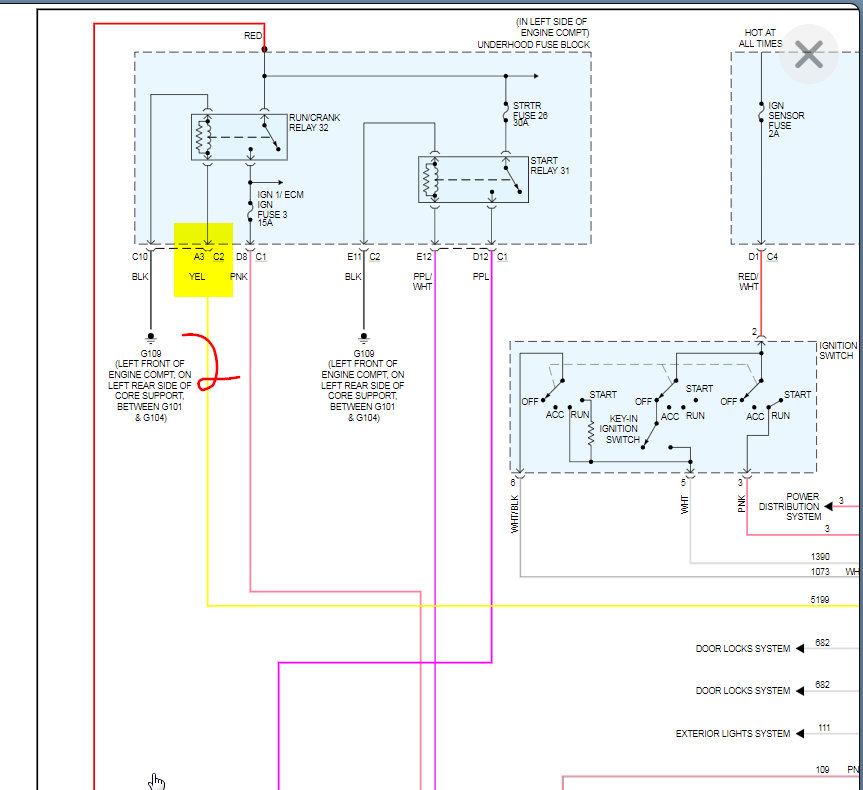

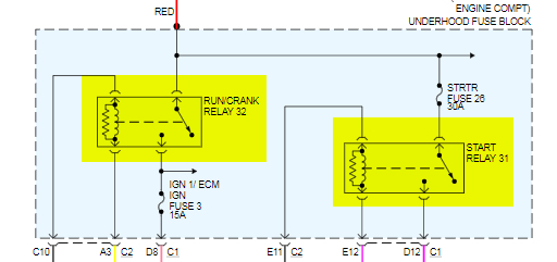

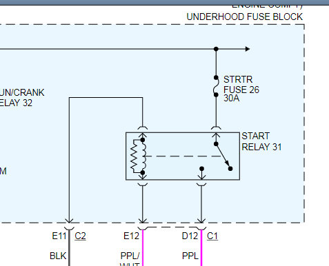

Okay. Just so we are on the same page, when you say all the fuses are okay, did you replace or swap the relays? You said a run crank module, did you mean the run/crank relay? There is a starter relay but that feeds power to the starter relay. Both the relays need to be replaced at this point. IF that does not cure it or it has been done, we need to check voltage at the starter.
It is safe to assume we are not getting voltage but we need to trace it back through the system. Once we confirm the starter has no voltage, you go to the under-hood fuse block and see if there is voltage on the yellow wire that is going into the run/crank relay. If not, I suspect we have an issue in the BCM.
Just so you understand what my thinking is, when you turn the key on the ignition switch sends voltage to the BCM which sends voltage to the fuse block on the run/crank relay, which sends power to the ECM and this tells the ECM that it is ok to start the engine. So it sends voltage to the fuse block again on the starter relay. This relay turns on and sends this voltage to the starter that turns the engine.
The fact that this doesn't start when it is hot, means that one of the circuit boards in either the BCM or ECM has failed and when it is hot, it expands and doesn't make the connection any more. Then when it cools down the metal contracts and makes the connection again. This may sound crazy but it happens more than you would think.
Let me know what you find at the starter and then at the yellow wire with the key on and we can go from there. Thanks

AMBER BERNAL SALWAY
  • 6 POSTS
So much informative information thank you very much, we are going to check these things one by one, is there a certain starting point? We will post the findings and results as soon as we know! Thank you again for the time and consideration of helping me.

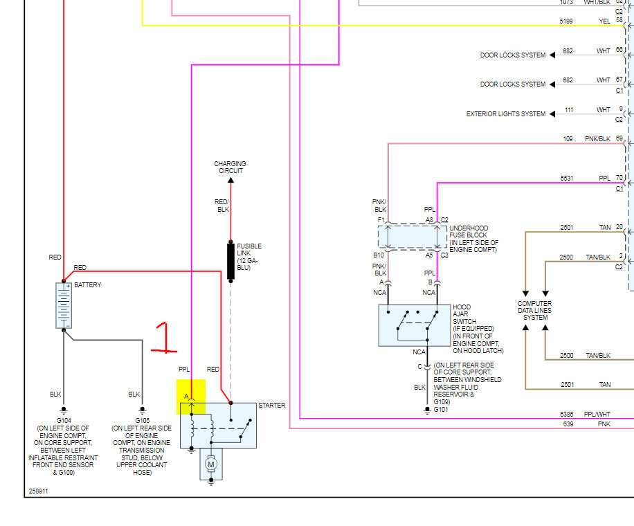

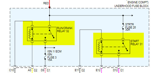

Okay. Sorry if that was too much. Hopefully this helps simply it. Follow the screen shots below. Replace the relays first. Then start checking voltage at the number screen shots when the engine is cranking.
Depending on the results will determine the next step.
