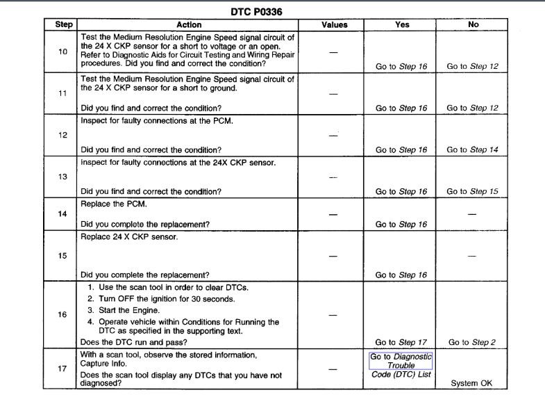

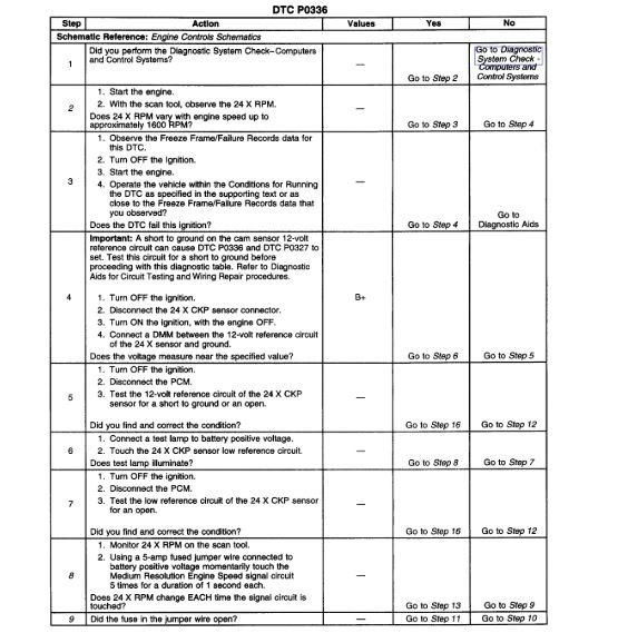

New fuel pump, new wires, new spark plugs. It ran hot stop working then I got the thermostat replaced. Then it started to crank slow. It does read codes p0336 p0440 p0327. Please help
Friday, June 7th, 2019 AT 12:23 PM
8 Replies
Good afternoon,
The 327 and 336 are for both crank sensors. When you crank the engine, does the tachometer move up a little?

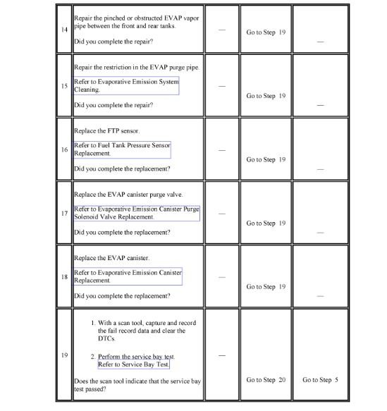

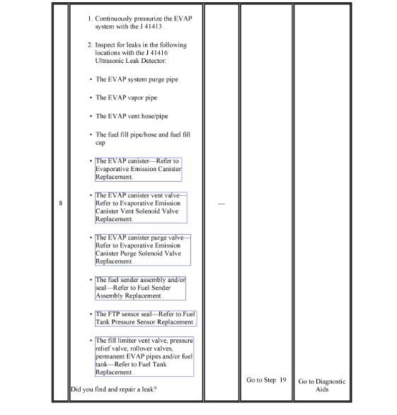

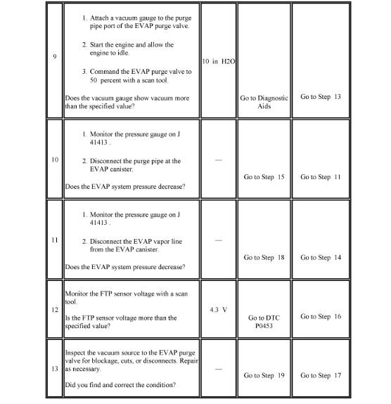

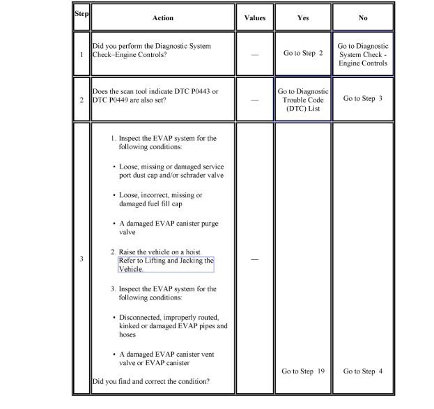

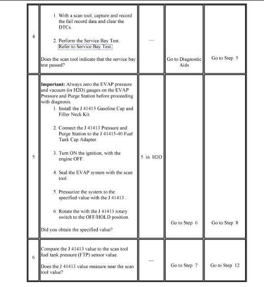

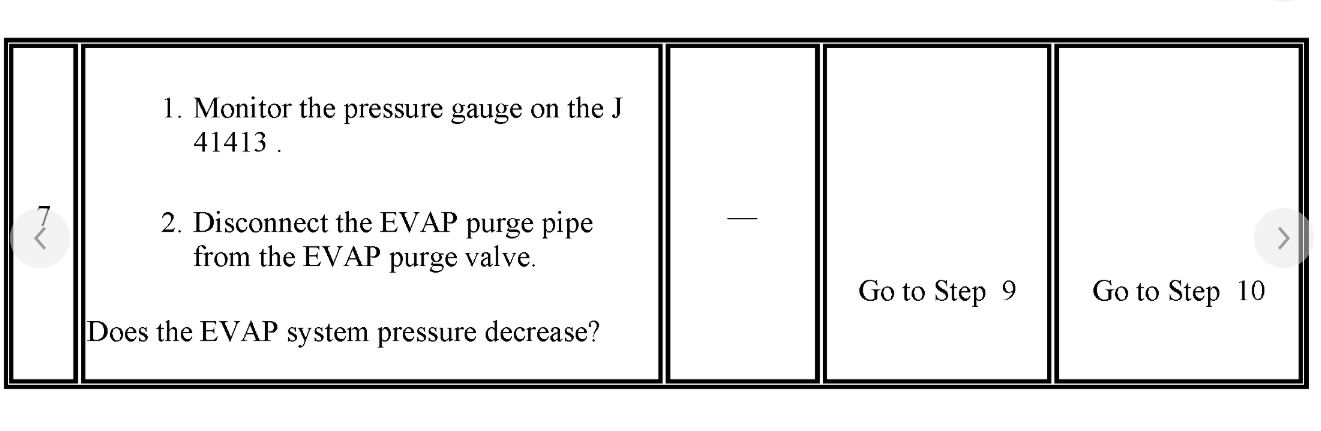

The 440 is for an EVAP leak in the EVAP system. You need to have a smoke test done to determine the leak.
https://www.2carpros.com/articles/evap-system-code-repair

Okay, the crank sensor is sending a signal.
You need to check for spark and fuel pressure next.

It was the crankshaft sensor started right up.
