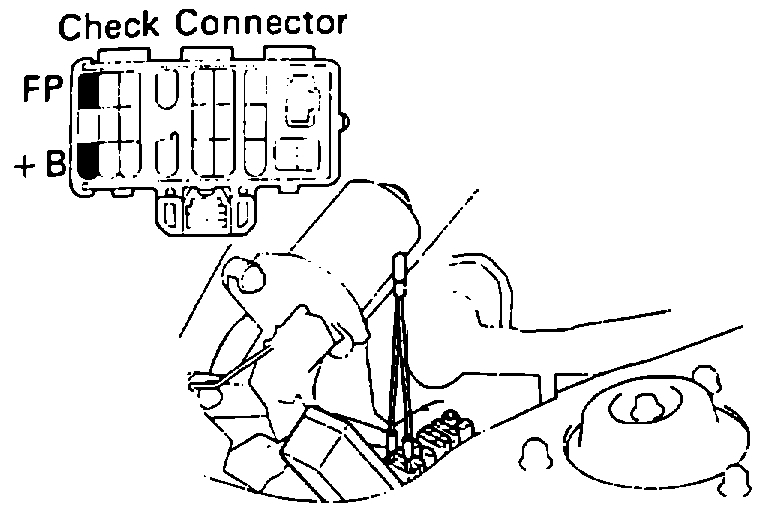

  • 110,192 POSTS
Many things can cause this. However, based on your description, the first thing I would check is fuel pump pressure. If it is weak, this can be the result.
Here is a link that shows in general how this is done:

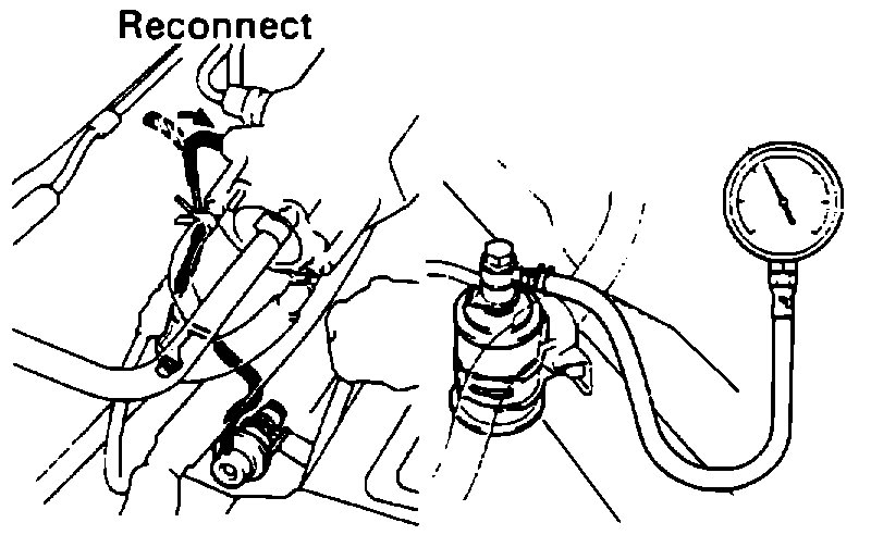

Here are the directions specific to your vehicle. The attached pictures correlate with these directions and the manufacturer's specs are included.
FUEL PRESSURE TEST
Pressure Gauge Connection
Picture 1
- Check that the battery voltages is above 12 volts.
- Disconnect the cable from the negative (-) terminal of the battery.
CAUTION: With Airbag, work must be started after approx. 30 seconds or longer from the time the ignition switch is turned to the LOCK position and the negative (-) terminal cable is disconnected from the battery.
- Put a suitable container or shop towel under the fuel filter.
- Remove the union bolt and two gaskets, and disconnect the fuel in let hose from the fuel filter outlet.
- Install the fuel inlet hose and pressure gauge to the fuel filter outlet with three new gaskets and the union bolt.
Torque: 29 N.m (300 kgf.cm, 22 ft.lbs)
- Wipe off any splattered gasoline.
- Reconnect the battery negative (-) cable.

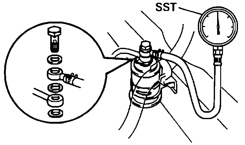

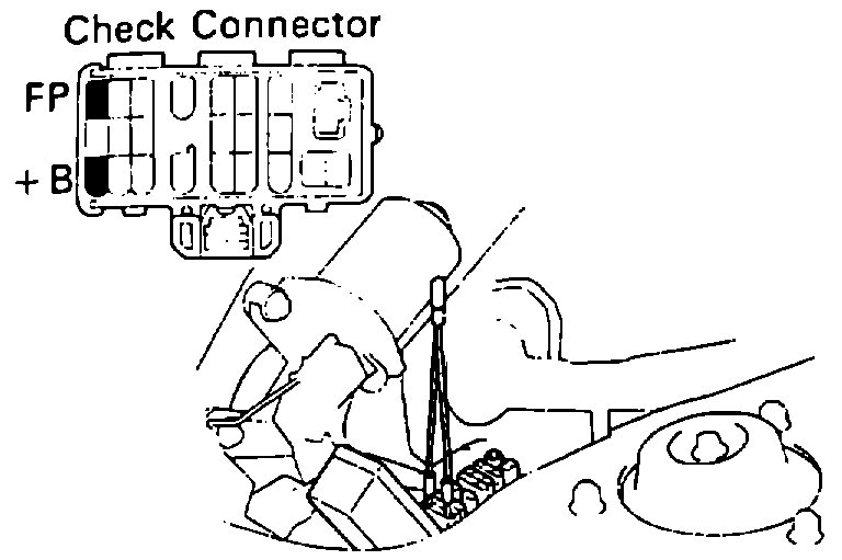

Installing Jumper Wire
Picture 2
- Using a jumper wire, connect terminals +B and FP of the check connector.
- Turn the ignition switch ON.

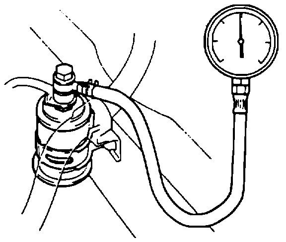

Reading Pressure Gauge
Picture 3
- Measure the fuel pressure.
Fuel pressure:
265-304 kPa (2.7-3.1 kgf/cm2, 38-44 psi)
- If pressure is high, replace the fuel pressure regulator.
- If pressure is low, check the following parts:
Fuel hoses and connections
Fuel pump
Fuel filter
Fuel pressure regulator
- Start the engine.
Checking Fuel Pressure - No Vacuum To Regulator
Picture 4
- Disconnect the vacuum sensing hose from the air intake chamber and plug the air intake chamber outlet.
- Measure the fuel pressure at idling.
Fuel pressure:

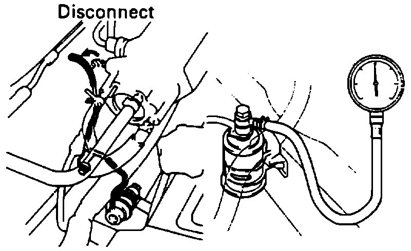

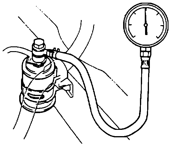

Checking Fuel Pressure - Vacuum To Regulator
Picture 5
- Reconnect the vacuum sensing hose to the air intake chamber.
Fuel pressure:
206-255 kPa (2.1-2.6 kgf/cm2, 31-37 psi)
- If pressure is not as specified, check the vacuum sensing hose and fuel pressure regulator.
- Stop the engine.
- Check that the fuel pressure remains 147 kPa (1.5 kgf/cm2, 21 psi) or more for 5 minutes after the engine is turned off.
- If pressure is not as specified, check the fuel pump, pressure regulator and/or injector.
- After checking fuel pressure, disconnect the battery negative (-) cable and carefully remove pressure gauge to prevent gasoline from splashing.
- Connect the fuel inlet hose with two new gaskets and the union bolt.
_____________________________________________
Check this first and let me know the results.
