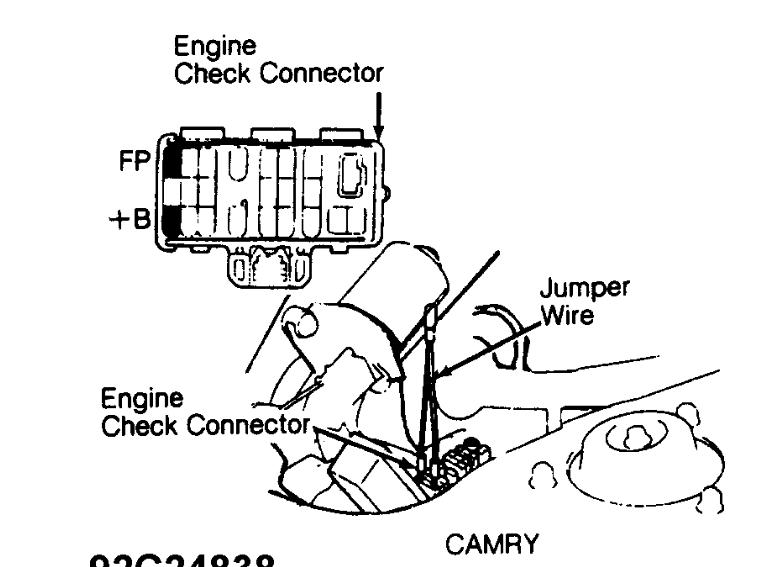

If the engine's condition is in tip top shape-do below to determine if its fuel or spark problem that's if its cranking over and refuses to start
Get a carb cleaner and spray into the carb or the throttle body on an EFI. Did it start and die? If not disconnect a sparkplug wire or 2 and ground it to the engine -have helper crank engine over-do you have a snapping blue spark? If so-you have a fuel problem, check the fuel pressure to rule out the fuel pump/pressure regulator and listen to the injector/s are they pulsing or hook up a noid light.
If both fuel and spark is present-check the valve and ignition timing, this will lead you to problems with compression and valves opening and closing at the wrong time

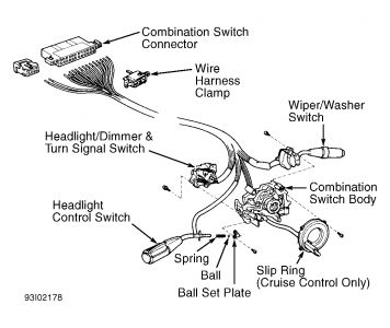

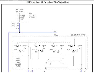

Hi guys! Just purchased a used 92 Camry LE for my daughter to use and discovered the fuse for the wipers was blown. Replaced the fuse to discover that the wipers will not shut off. This car doesn't have the intermittent feature and both low speed and high speed work fine. Washer fluid button works fine. I suspect all of the control is contained at the motor but does the whole motor need to be replaced or is there a separate control module that can be replaced? Could it be a broken wire or bad ground? Help!

Hello -
Congrats on the new car sorry for the problem already. . .
I don't' think it is the motor. . .I think it may be the switch. . ...and don't forget the relay. . ..that could be stuck too.

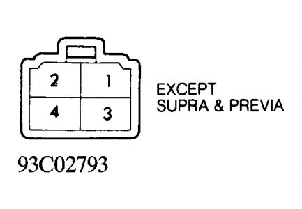

Here are a couple of tests for you to do. . ..I will give you the motor too just because. . .. . .
EXCEPT PREVIA
1. Using 12-volt battery, connect jumper wire from positive battery terminal to wiper motor terminal No. 2. See Fig. 3 . Connect another jumper wire between negative battery terminal and wiper motor body or motor ground wire location at mounting bolt hole. Motor should operate at low speed.
2. Remove jumper wire from terminal No. 2. Reconnect jumper wire to wiper motor terminal No. 1. Motor should operate at high speed.
3. Remove jumper wire from terminal No. 1 and reconnect jumper wire to wiper motor terminal No. 2. With motor running at low speed, stop motor at any position except PARK position by disconnecting jumper wire from terminal No. 2. Install another jumper wire between wiper motor terminals No. 2 and 3.
4. Ensure motor body ground is still connected to negative battery terminal. Connect positive battery terminal jumper wire to wiper motor terminal No. 4. Motor should start running and then stop at PARK position. Replace motor if operation is not as described.

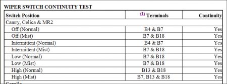

FRONT WIPER SWITCH TEST
With wiper switch in specified position, ensure continuity exists between terminals listed. See WIPER SWITCH CONTINUITY TEST table. See Fig. 11 , Replace wiper switch assembly if continuity is not as specified.
https://www.2carpros.com/forum/automotive_pictures/248015_Test_Chart_1.jpg

Okay not sure if you need it but here is info on wiper switch removal/installation.
FRONT WIPER SWITCH
WARNING: Camry, Celica, MR2, Previa and Supra are equipped with a driver's side air bag, use extreme caution while servicing components on steering column.
Ensure ignition switch is in LOCK position and negative battery cable is disconnected for at least one minute before starting service. DO NOT apply electrical power to any component on steering column without disconnecting air bag control unit. Information labels are attached to air bag components. Follow all notices on labels. Use only DVOM with minimum of 10-k/ohms impedance to check any circuit.
NOTE: Wiper switch is component of combination switch, mounted to steering column. For further information and/or illustrations on removal procedure, see COMBINATION SWITCH under REMOVAL & INSTALLATION in STEERING COLUMN SWITCHES article.
(Except Paseo & Tercel)
1. Disconnect negative battery cable. To access combination switch connector, remove instrument panel lower finish panel under steering column. See INSTRUMENT CLUSTER under REMOVAL & INSTALLATION in INSTRUMENT PANELS article.
2. Remove steering column upper and lower covers. Remove steering wheel. See STEERING WHEEL under REMOVAL & INSTALLATION.

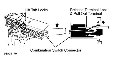

3. Locate wiper/washer switch wire terminal positions installed into combination switch harness connector. See Fig. 11 Lift tab locks on combination switch connector.
4. Using miniature screwdriver, release wire terminal securing tab inside connector. See Fig. 20 . Pull wire(s) from connector and through harness jacket tubing. Remove wiper switch retaining screws from rear of combination switch body and remove switch. See Fig. 21 .

Thanks guys! The motor checks out. I haven't disassembled the steering column yet to verify the switch but I'm convinced now it is the switch. I did some preliminary checking and wasn't surprised to find it difficult to find one. I did located some on EBay though so I may be in luck. You mention that it could also be a stuck relay. Is that relay part of the motor assembly? I didn't see any relays in any of the fuse blocks labeled for the Wipers. Is it safe to assume that if the motor operates fine according to the test then the relay would also be fine?

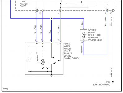

Hello -
Well, sorry about that my friend. . .. . .the rear has a wiper relay. . ...not the front - the wiring shows it located on the left quarter panel. . .. . ..when I was going back and forth doing your pics and reviewing the wiring. . ..I opened the rear not the front one time. . .. . .. . .so. . ..no relay for the front. Again, sorry about that.
I agree with you. . ..it is probably the combination switch
Here is the wiring for the front. . ..it may help you out. . .. . .. . ..
https://www.2carpros.com/forum/automotive_pictures/248015_Wire_1_4.jpg
https://www.2carpros.com/forum/automotive_pictures/248015_Wire_2_3.jpg

No worries. I found the entire combination switch on Ebay for $59 with free shipping and guaranteed to work so I think that's my best and cheapest way out. As soon as I get it and install it I will report back in with the results but I'm betting it will be fine. Until then, thanks a bunch!

MRANCOU1
  • 7 POSTS
Hey there. Just wanted to get back to you as promised. The issue was with the wiper switch. The combination switch I purchased from Ebay finally came in and I had a local garage put it in along with the coil springs the car also needed for an inspection sticker. So, your suspicion was 100% correct! Thanks again. I look forward to getting help from here the next time around!
