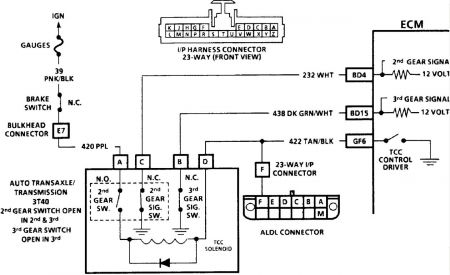

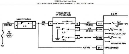

Okay I did have the engine stall out on me again. Transmission still seems like it may have a problem. I postulated that it may be the VSS but I'm not sure yet. I re ran the codes again because I found out the codes I was seeing were just out of power codes. Did re run it I got 12 12 12 27 27 27 and thats it. Not sure at this point, might as well keep at it. Thanks,
Art
Saturday, September 26th, 2020 AT 10:30 AM (Merged)
MERLIN2021
  • 17,250 POSTS
CODE 27 OR 28, GEAR SWITCH CKTS, W/3T40 TRANSAXLE Gear switches are located inside transaxle. Switches are normally closed. As vehicle speed increases, hydraulic pressure applies specific gear clutches and gear switch opens. ECM uses gear switches input signals in calculations to determine control fuel delivery and TCC operation. Code 27 will set if mid gear 2nd switch indicates ground or closed switch for 12 seconds when vehicle is in 3rd gear or if mid gear 2nd switch circuit indicates an open when engine is first started. Code 28 will set if high gear 3rd switch circuit indicates ground or closed switch for 10 seconds when vehicle is in 3rd gear or if high gear 3rd circuit indicates an open when engine is first started. 1. A digital volt-ohmmeter must be used in this test. A test light will not work due to low voltage supplied by ECM. 2. Checks if circuit is grounded through switch. 3. Checks for a good, properly operating switch and checks circuit within transaxle for an improper ground. DIAGNOSTIC AIDS Check for poor connections at ECM pins. Inspect harness for incorrect routing (too close to high voltage wiring) and chafing. Monitor voltage of each terminal while moving related harness connectors. If failure is induced, voltage reading will change. NOTE: Test numbers refer to numbers on diagnostic chart. Page 1 of 1 5/11/2010 ...
https://www.2carpros.com/forum/automotive_pictures/62217_schematic_27_1.jpg

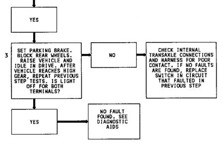

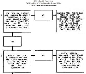

Check PVM ground, black and white wire. here's the chart fpr code 27 troubleshooting.
https://www.2carpros.com/forum/automotive_pictures/62217_37a_1.jpg
https://www.2carpros.com/forum/automotive_pictures/62217_27b_1.jpg
https://www.2carpros.com/forum/automotive_pictures/62217_27c_1.jpg
