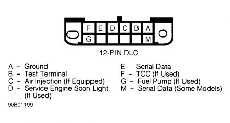

When in park engine idling when brake is applied does it stall or start to idle rough? is brake operation normal?
Find ALDL under dash Jumper from TERM A to B see diagram
https://www.2carpros.com/forum/automotive_pictures/198357_Graphic_572.jpg
paper clip works good. key on but not to run MIL will flash so flash pause flash,flash = 12 post codes
Let me know
