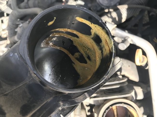

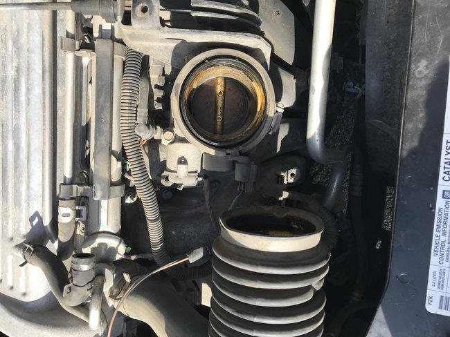

WILL PAUL HOWARD
This was also in the throttle body cleaned it out then tried to restart to see if more came through but it didn’t.

Wow, I don't know what that stuff is, but that concerns me.
Is it hard like plastic or is it soft?
I would check the compression to be sure none of that stuff got to the valves and has them hung up.

WILL PAUL HOWARD
It’s a soft liquid like it’s a mix of water gas and oil feel. It’s my mother in laws car so I do not know much of how it has been maintained and driven. I’ll have the compression checked and also check the the spark plugs to see if there is power getting to them. Thank you for replying and your help.
