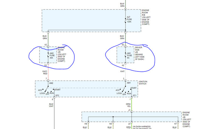

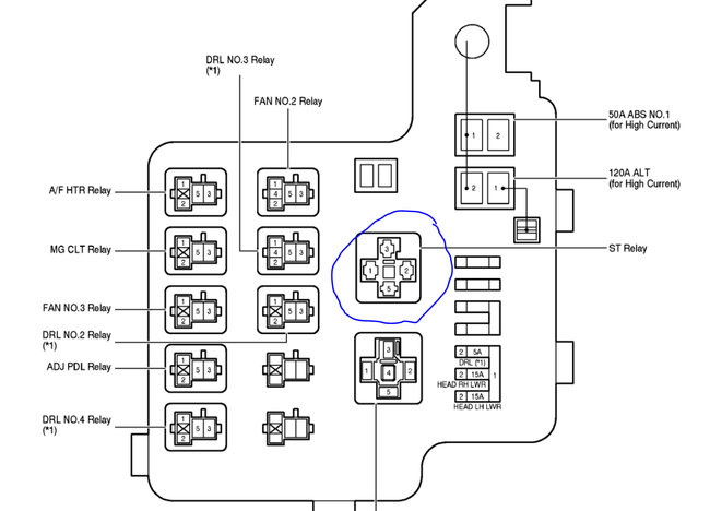

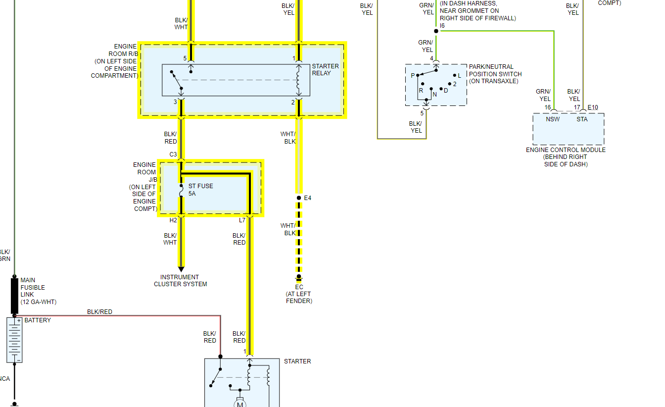

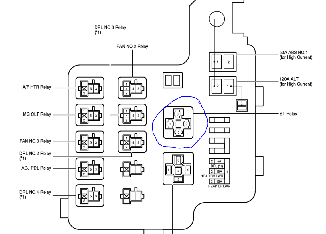

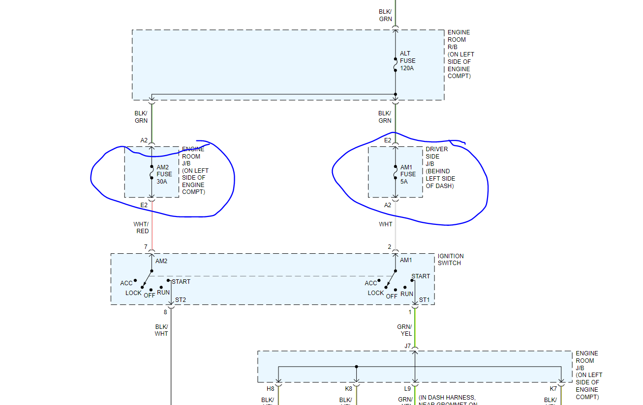

The car has power but will not start.
Saturday, October 31st, 2020 AT 9:55 PM
MECHANIC
52,796 POSTS
Good morning,
Does the engine crank over?
Can you check for spark?
Do you hear the fuel pump run when the key is turned on?
Compression is the last thing needed.
I attached a wiring diagram for you in case the engine does not crank. In that case, we will need to do some voltage checks.
