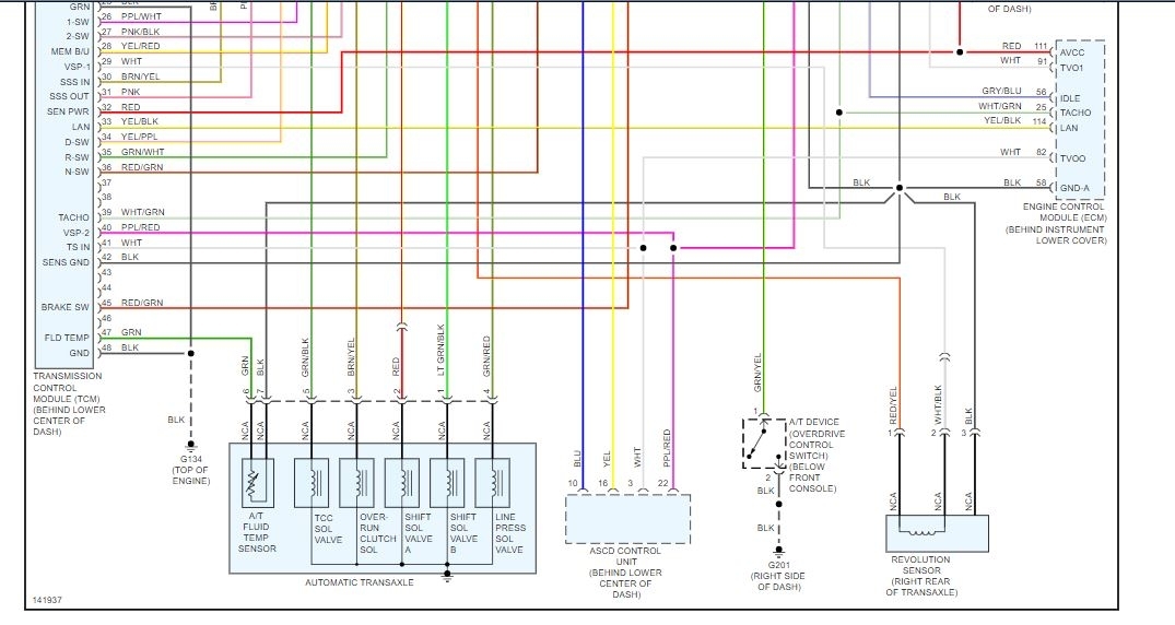

When the car warms up and the weather is warm; 60 degrees or above sometimes the transmission will not change out of Low Gear. I had this same problem with a 2001 Maxima in 2017. Luckily found a shop that was familiar with the problem and was able to fix in 2-3 hours. Cost was $351.00 in August of 2017. That shop is out of business and I cannot find a shop that is familiar with this problem. I've learned that if I park and turn off the engine and let the systems cool down a bit. I can start the car and the transmission changes perfectly. But it does seem the issue is becoming More frequent. Can you help me or refer me to a repair shop in my area (Central N.C).

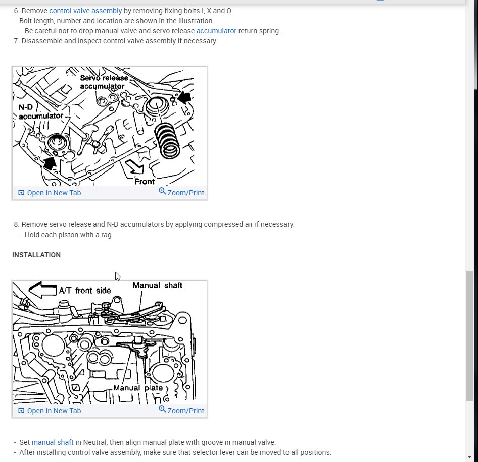

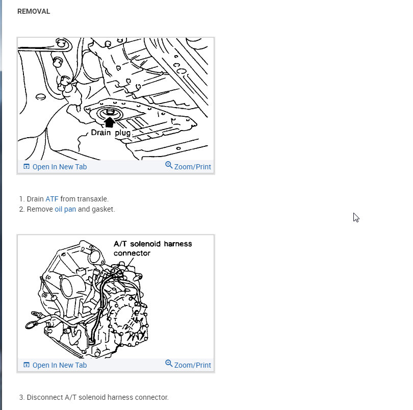

I have seen this issue a number of times in other Nissan's. Normally it is the valve body is the issue. This would actually line up pretty close to the price that you paid to fix the other vehicle.
The valve body is what controls the direction of the pressurized fluid so that each gear is engaged properly. The fact that you shut it off and it starts operating properly points towards the solenoids or valves inside the unit as they are "resetting" when the pressure is relieved when you turn the engine off.
If it were me, I would take the valve body out and check the valve operation but just moving them in the bore to see if they are sticking.
As for a shop in NC, I am familiar with the area and there is a franchise that is all over down there called Christian Brothers. They are very well run shops and would recommend them over any other.
Here is the process of how to replace the valve body in case you need it.
Let me know if you have questions. Thanks

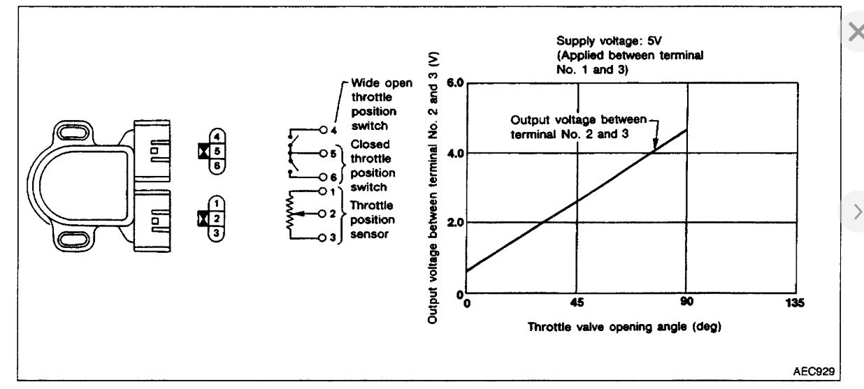

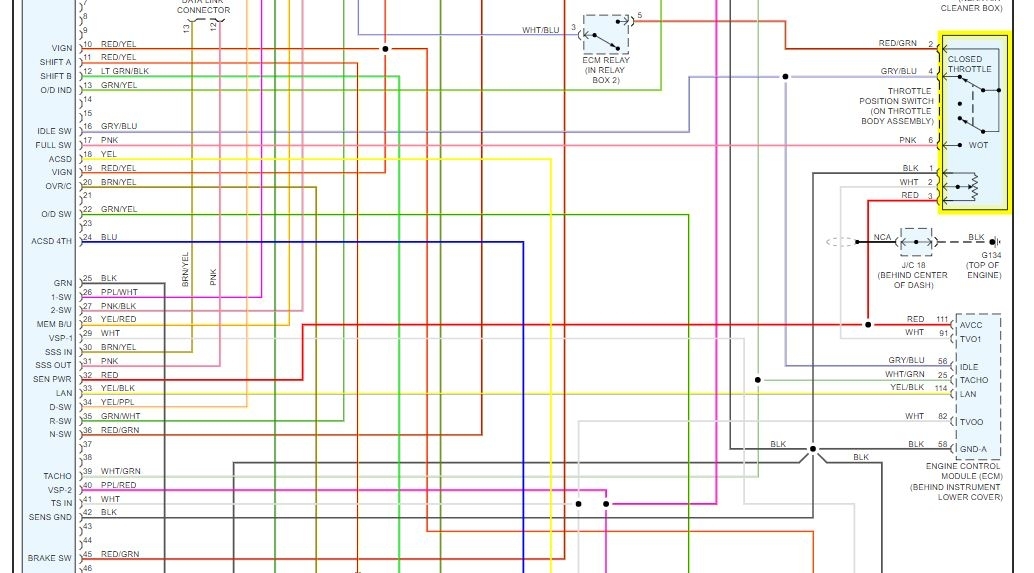

My car stays in second gear doesn't slip just starts off in second and will not shift.

Good morning,
Are there any codes stored in the system?
When was the last time yo changed the fluid and filter in the transmission?
Is the check engine light on? If it is, do you know the codes?
This sounds like it could be valve body related but need information at this point.
Tuesday, August 4th, 2020 AT 5:38 PM (Merged)
JACKY MAY
  • 6 POSTS
It said shift solenoid a an b check engine is on. I changed fluid and screen soon as I got it because it stayed in second gear from the start when I bought it a year ago.
It said?
I need the code numbers so I can look them up and see what the fault code indicates.
JACKY MAY
  • 6 POSTS

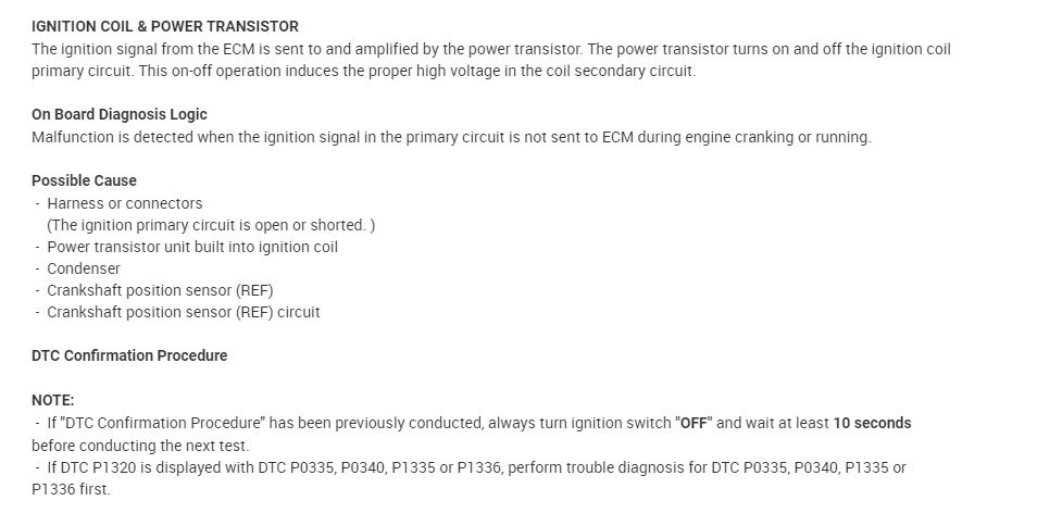

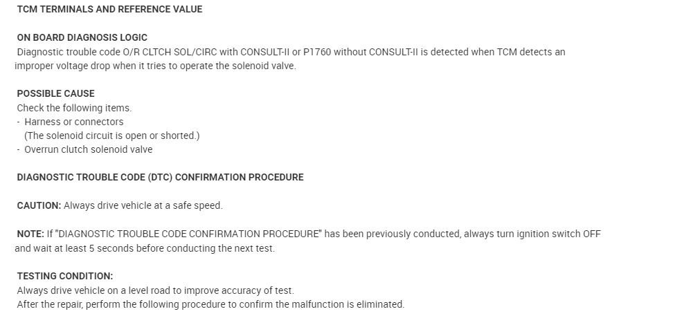

Stored code p0120.

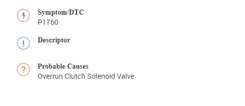

Pending codes p1320 and p1760.
Okay, the 120 is for the throttle position sensor. This does control sifting and shift points for the transmission. You will need a scan tool to monitor the actual voltage when accelerating up and down.
The 1320 is for the engine side. It refers to possible coil issues.

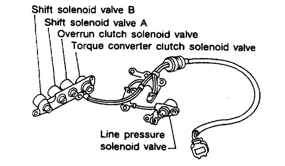

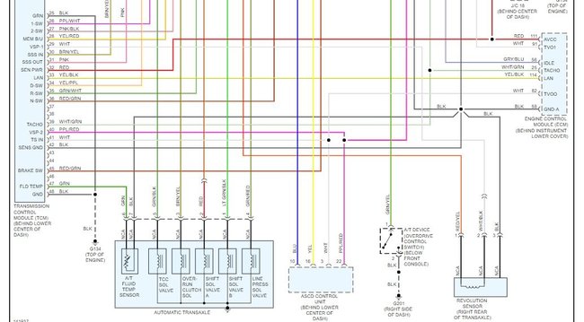

The 1760 is for the over run solenoid in the valve body. It is possible that this is the issue of the throttle position sensor could be it as well.
You will need a scan tool that can read the transmission and activate the solenoids to see if they are working.

I have a new TPS and a new mass flow sensor. I read that could be the problem from 2CarPros.
Okay, can you monitor the operation with a scan tool?
Is the code still active? The 120 code?
JACKY MAY
  • 6 POSTS
Yes, but I don't have a scan tool. I will have to take it to a garage.

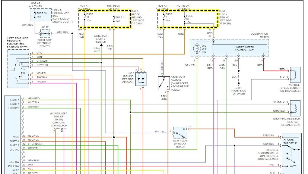

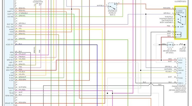

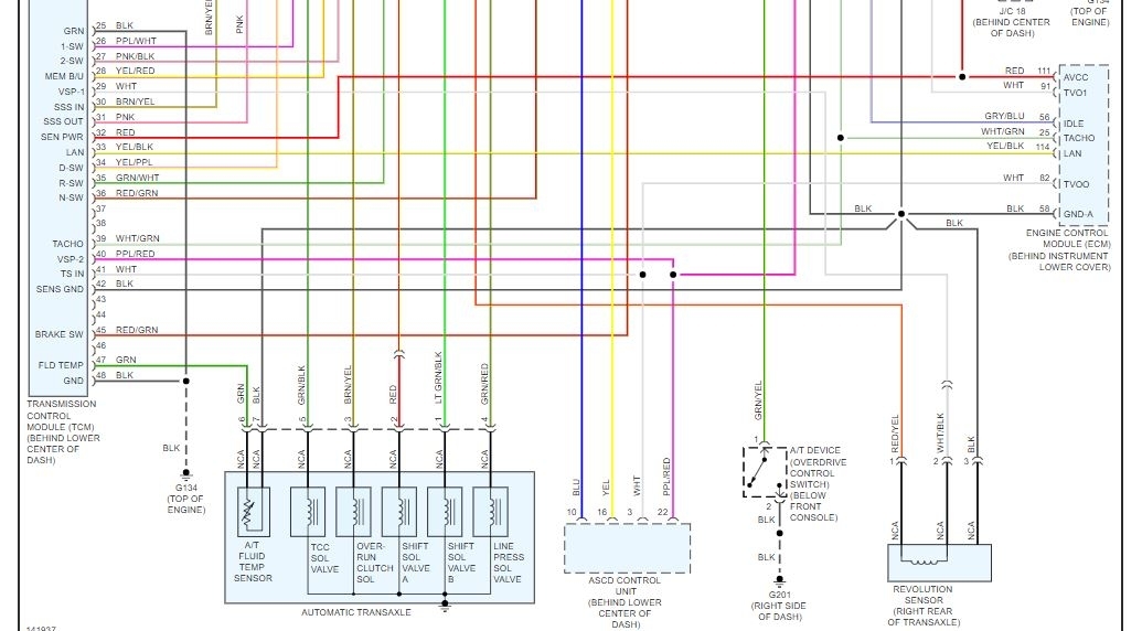

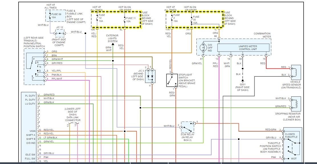

If the code is still active, the TPS was not the issue. It is most likely a wiring issue.
I attached a wiring diagram for you. Verify the fuses are good that I highlighted. This is not a visual test but is a voltage test.
+1
JACKY MAY
  • 6 POSTS
Thank you, I will do what you said. Hope that's the problem.
