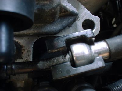

The car starts fine in the morning or when the engine is cold, runs very smoothly. When I stop in somewhere for an hour or two, instead of starting after 2 or 3 revolutions of the starter, it takes 10 - 12 revolutions before it starts. It runs fine after it starts. There are no DTC codes showing when I check it with an OBD2 tester. Any suggestions on what to check?

Check fuel pressure with a mechanical gauge during this hard start period. Remove vacuum line from fuel pressure regulator and check for gas. There should be none. You should also change the fuel filter.

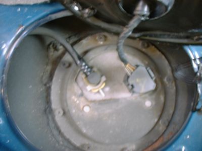

Thank you for the response. For measuring the fuel pressure, the figure attached has a black plastic snap connector, which I assume is the fuel line connection. After I remove the plastic clamp, I tried to separate the line/hose by pulling, but did not want to break anything. Is there something else holding the line to the hose? Also, when I put the fuel pressure gage on, is it ok to put a hose over the formed aluminum bubl on the fuel line and just hold in place by hand while someone else turns it over, or is there too high of pressure to do so (about what pressure should I expect)?
You mention checking the vacuum line to the fuel regulator and seeing if there is gas in it. Does this need to be done when the engine is hot? The 2nd picture looking down on the fuel pump - is the hose you are talking about the one with the yellow clip in the picture? I was concerned about breakinhg the clip or the hose if trying to separate the hose from the plastic 90 degree part that is held in to the pump by the yellow clip.

You generally check fuel pressure at the fuel rail. Some Toyota's do not have a test port, rather, you use a special fitting that screws into the cold start valve fitting at the rail (after removing the CSV).
You check pressure at the rail because checking it at the pump is dangerous and will not tell you what the pressure is at the injector, since you may have an obstruction somewhere in the system between the pump and the rail.
