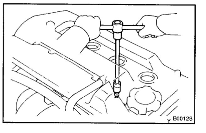

Hi, every so often my car starts but it runs rough for around ten seconds and then goes into a generally smooth idle. Two weeks ago I got a full tank of gas and the problem has pretty much gone away. It comes and goes and the lest time it went away was after the check engine light issue was fixed. I was wondering if it is the gas. It seems worse in the summer.
As far as the engine light is concerned, I fix the problem and the engine light comes back on. The last time it was off for two weeks and came back on.
Now the engine runs pretty good. I can still hear a little what sounds like the engine unclogging but it is much better since I got gas two weeks ago. But the engine light is still on. I am not sure if they are related.
Oct 16, 2020 at 10:06 AM (Merged)
  • CAR REPAIR CONTRIBUTOR
  • 54,354 POSTS
What did you fix to make the check engine light go off? It sounds like the spark plugs are worn out.
Here is a guide to help you get the problem fixed:
https://youtu.be/jvWqrAFQQmg
and
https://www.2carpros.com/articles/how-to-change-spark-plugs
and
https://www.2carpros.com/articles/engine-cranks-excessively-before-starting
Please let us know what happens so it will help others.
