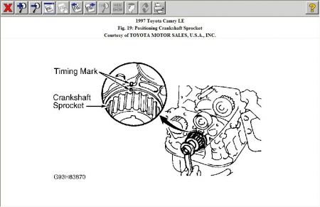

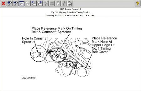

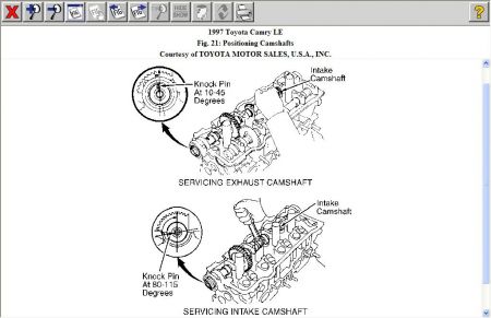

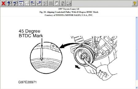

Where is the timing marks on cam n crank shaft
Monday, July 27th, 2020 AT 12:38 PM (Merged)
  • 75,992 POSTS
Hi chee and welcome to 2carpros
Put engine no. 1 piston on it compression stroke/TDC-then align the sprockets-see below
https://www.2carpros.com/forum/automotive_pictures/12900_cam_5.jpg
https://www.2carpros.com/forum/automotive_pictures/12900_cam2_3.jpg
https://www.2carpros.com/forum/automotive_pictures/12900_crank_1.jpg
https://www.2carpros.com/forum/automotive_pictures/12900_crank2_2.jpg
