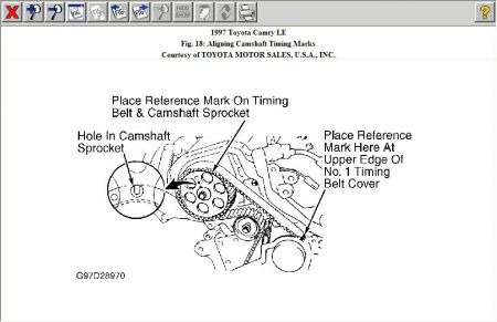

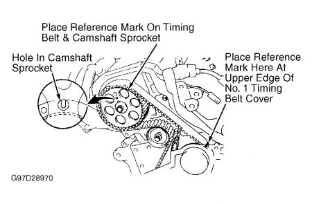

Timing belt marks?
RVSNGL
  • 1994 TOYOTA CAMRY
  • 4 CYL
  • FWD

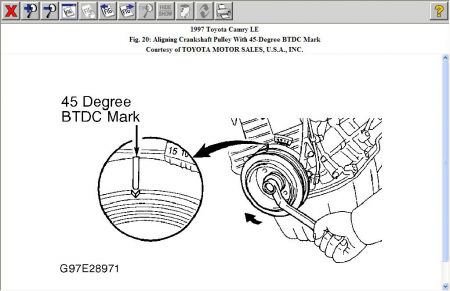

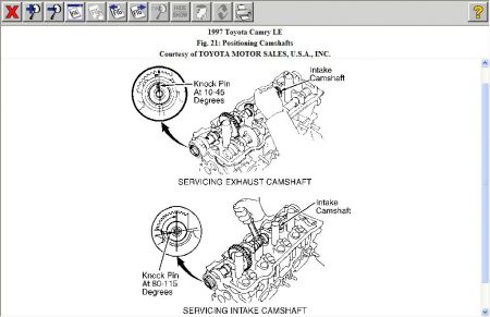

Timing mark diagram for car listed above LE model 2.2 liter.
+1
Monday, July 27th, 2020 AT 12:27 PM (Merged)
  • 75,992 POSTS
Here is a guide and the diagrams below so you can see how the job is done:
https://www.2carpros.com/diagrams/toyota/camry/1994
Cheers

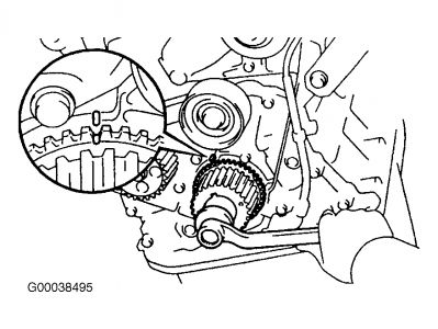

I have three dots on the intake and two on the exhaust. One has two dots and the other is one. Which dots do I put together?
Good morning,
On the 2.2 four cylinder, there is only one cam gear, not two. Can you verify the engine you have?

I am trying to find out which dots to line up on camshafts gears on cam shafts. If someone could point me to a picture would be great. I had the cam shafts out to replace head gasket I never noticed the gears had more than one dot on gears.
I am talking about the two gears on the camshafts under the valve cover this is a 2.2 liter with duel cams there are dots on both gears not sure which dots to line up. This is a 5S-FE engine.
Thanks for any help.
BMRFIXIT
  • 19,053 POSTS
Check this page:
And here is the diagram you are looking for:
https://www.2carpros.com/forum/automotive_pictures/99387_Graphic1_449.jpg

Broke timing belt, removed heads to check valves. All valves o.K. Replaced head gaskets. Exhaust manifolds are back on. Down to dropping cams back in & setting timing belt. Am using a chiltons manual but am confused about service bolt? The internal cam gears do not have holes for this service bolt. Also book is unclear as were to set cams to time belt.
Monday, July 27th, 2020 AT 12:28 PM (Merged)
BMRFIXIT
  • 19,053 POSTS
Check this page see if has any thing that you are looking for
https://www.2carpros.com/car_repair_information/year/1993/make/toyota/model/camry/1993_toyota_camry_timing_belt_diagram_marks.htm

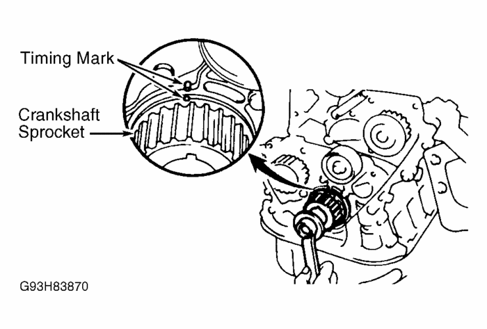

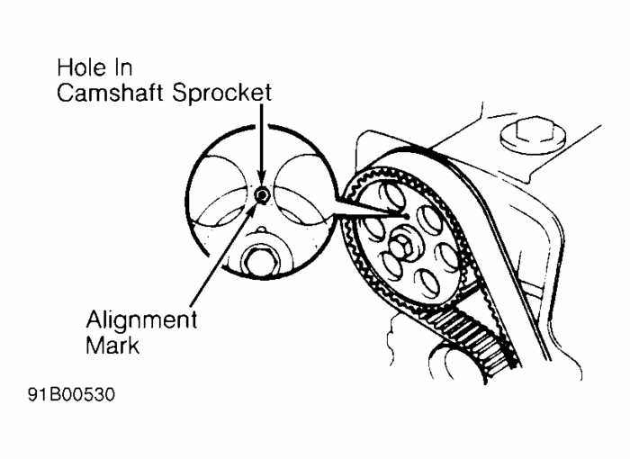

I need to know how to align timing marks
MHPAUTOS
  • 31,937 POSTS
Hi there,
Set crankshaft at TDC (top dead centre) that's the "0" on the timing cover aligned with the notch on the front pulley. Align the cam by placing the small hole towards 12 O' Clock so that with a mirror and light you can view the notch on the front cam pedestal, it is a bit tricky if you have never located it before, but go slowly and you will See it.
Mark (mhpautos)

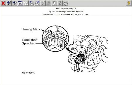

Our Camry had the timing belt brake. I've read that this engine is a non-interference motor. I've replaced the belt and water pump and timed it as I've read to do so.
Now all that being done, it won't start up. There is fire at the plugs, gas, starters cranking fine. I've tried adjusting the cam 180degrees, and it sounds the same.
MHPAUTOS
  • 31,937 POSTS
Hi there, ensure valve timing is correct first.
https://www.2carpros.com/forum/automotive_pictures/61395_celica_1_2.jpg
https://www.2carpros.com/forum/automotive_pictures/61395_celica_2.jpg
Mark (mhpautos)
