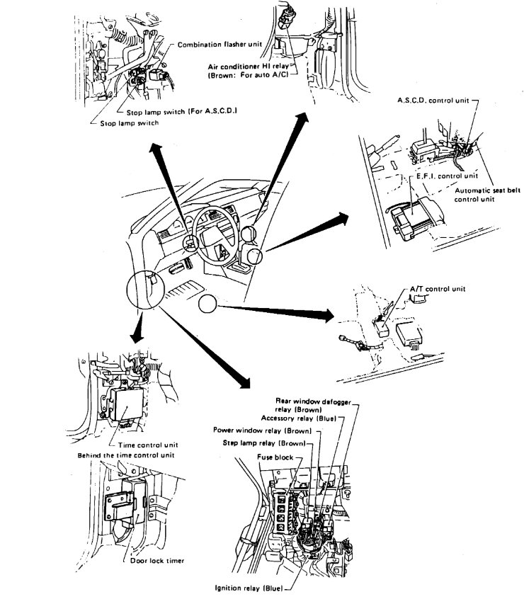

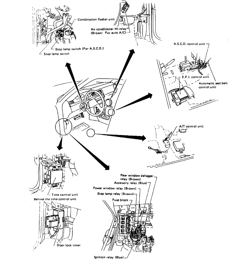

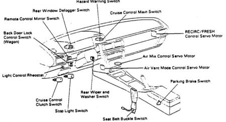

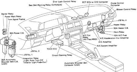

Which fuse on the fuse panel is for the automatic seat belts? What is the location on the panel?

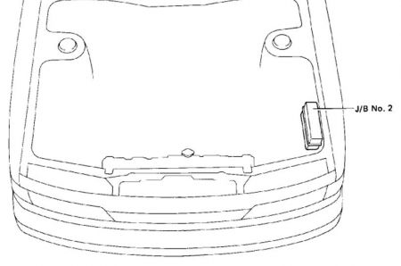

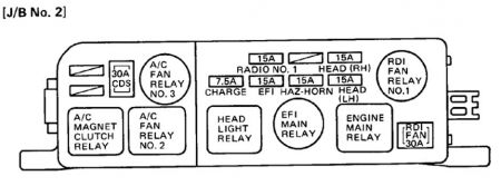

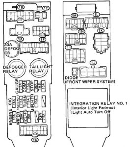

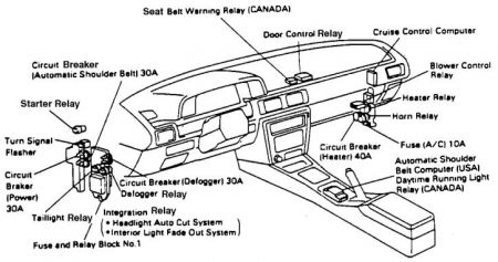

  • 75,992 POSTS
Hello

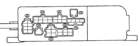

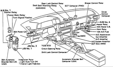

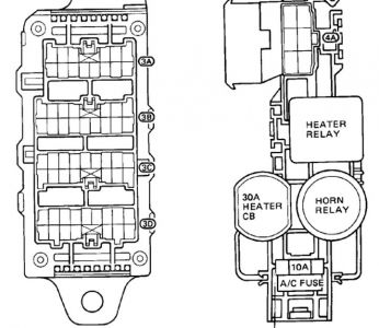

Here is a guide to test the fuses with the diagrams below
https://www.2carpros.com/forum/automotive_pictures/12900_f2_25.jpg
J/B NO.1
https://www.2carpros.com/forum/automotive_pictures/12900_f3_14.jpg
J/B NO.3 and NO.4
https://www.2carpros.com/forum/automotive_pictures/12900_f4_7.jpg
https://www.2carpros.com/forum/automotive_pictures/12900_f_15.jpg
https://www.2carpros.com/forum/automotive_pictures/12900_f1_30.jpg
https://www.2carpros.com/forum/automotive_pictures/12900_f2_26.jpg

HMAC300
  • 48,601 POSTS
There are three one is one dash left of steering column, passenger side is located behind kick panel, and main fuse box is under hood near battery.
