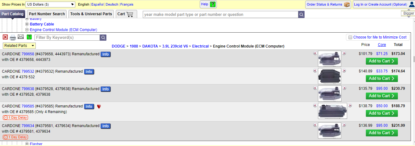

  • 52,797 POSTS
Okay. The SMEC is what controls the ASD relay. It has total control of the peration.
Looks like you need a SMEC and a relay.
I attached rock auto. You need the number off the old one to match it up.
Tuesday, November 24th, 2020 AT 8:14 AM
