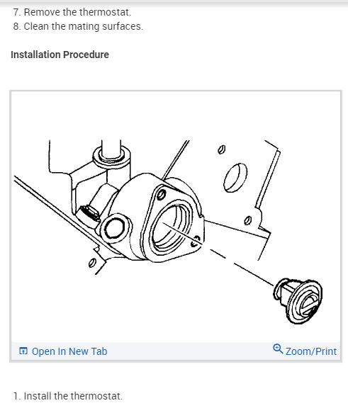

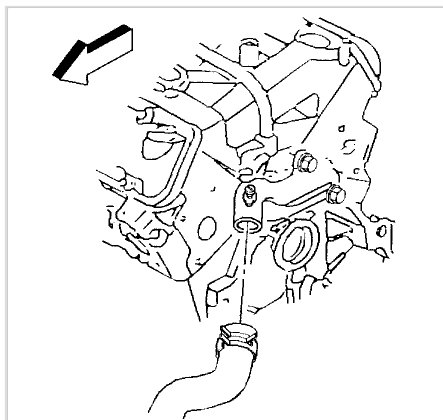

Hello, I'm Danny.

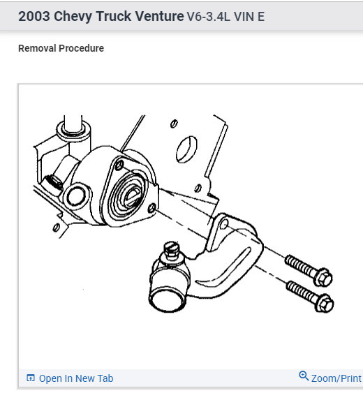

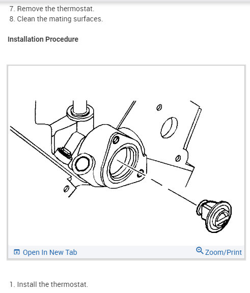

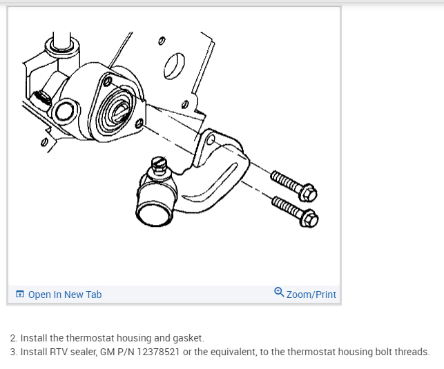

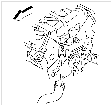

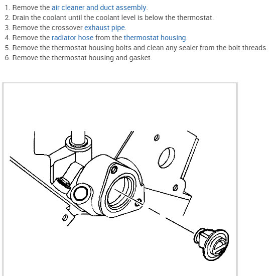

Here is a tutorial showing what is involved in replacing the thermostat:
I've attached below step-by-step instructions.Hope this helps and thanks for using 2CarPros.
Danny-

Check the thermostat and water pump. Remove the thermostat and see if that corrects the problem. If not, replace the water pump. It's a good idea to replace the thermostat when replacing the water pump, but not 100% must do.

SERVICE WRITER
  • 9,123 POSTS
IT is under the throttle body on the driver;s side. IT's a PITA. I don't know your skill level and patience. A novice should set aside 3-4 hours. I think book is around 1.3 hours.
