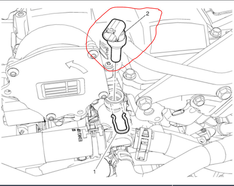

Just a few questions first. You mention the car heats up quickly but the actual temperature isn't hot? Have you checked the level of coolant in the radiator and overflow container? Get back to me and we'll go from there. If coolant level is normal you might be having an issue with the coolant temperature sensor malfunctioning.
This guide can help us pinpoint the problem
https://www.2carpros.com/articles/engine-overheating-or-running-hot
I've attached a picture below of its location.I can supply replacement instructions. Hope this helps and thanks for using 2CarPros.

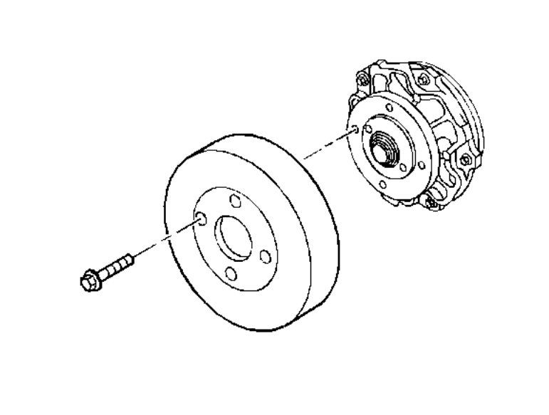

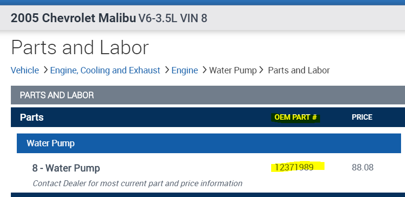

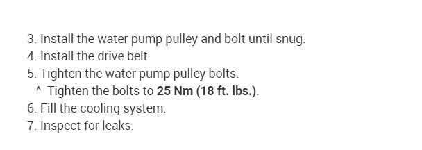

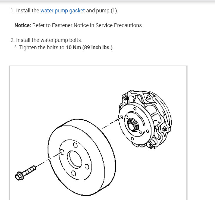

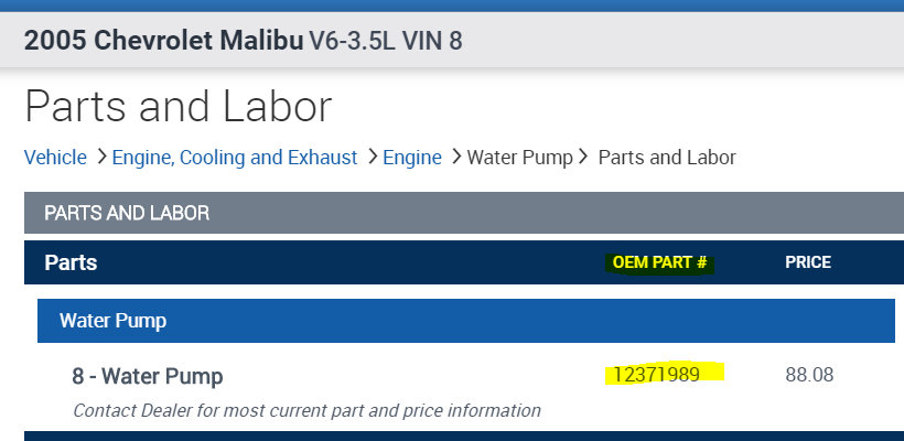

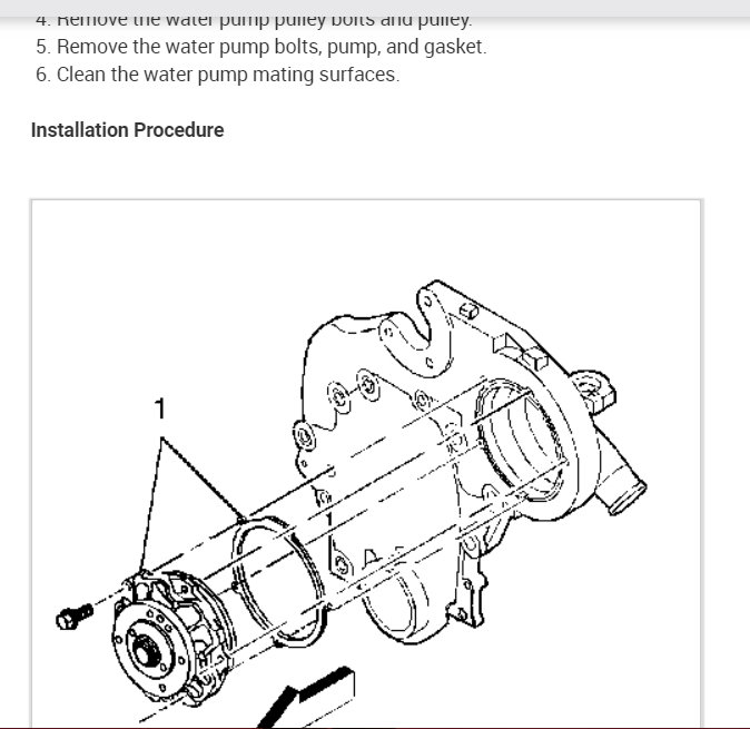

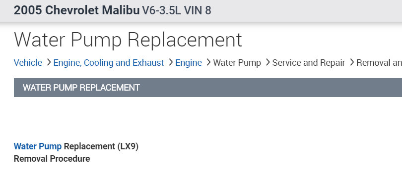

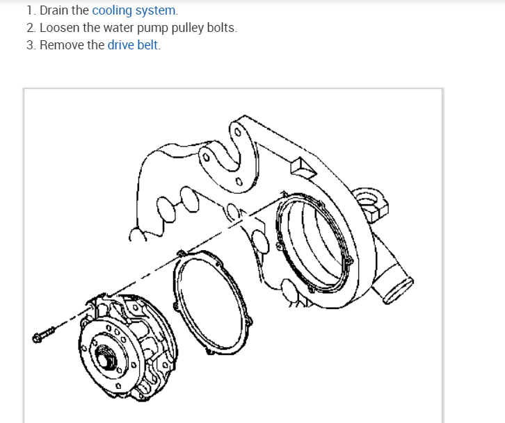

Possibly, but I would look at the water pump first. Underneath the water pump is a little hole called the weep hole. This is designed to let coolant weep out of the water pump when it fails so the coolant doesn't leak into the bearings, seizing the water pump completely. If there is coolant leaking there than your water pump is bad and needs to be replaced. It's probably a good bet that this is the problem, so I have included the Original Equipment Manufacturer (OEM) part number and the instructions for the removal and installation of your vehicle's water for you in the diagrams down below. Please go through these guides and get back to us with what you are able to find out.

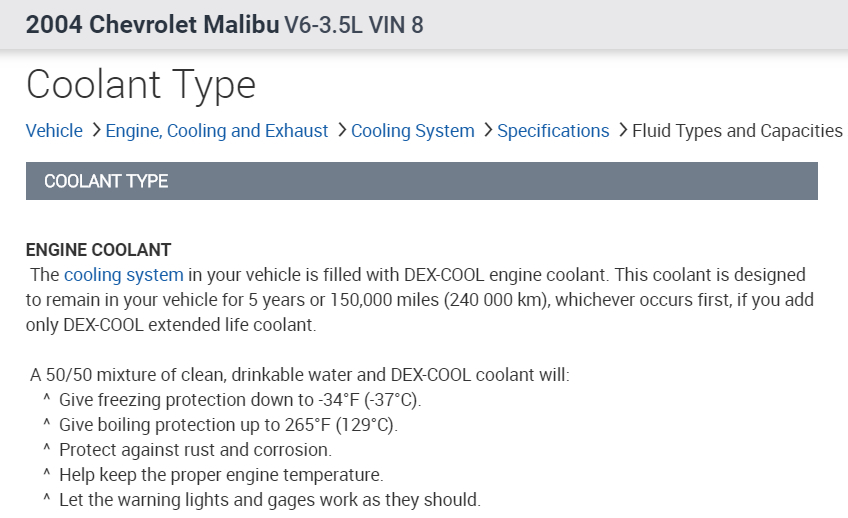

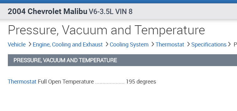

Did you physically check the opening temperature of your vehicle's thermostat by placing it in a pan of boiling water to verify that it is opening when it should? I have seen and bought thermostats that were bad right out of the box, and it is very frustrating because that part is good, it's brand new, in your mind and you wind up chasing your tail because of it. I would suggest doing that first, keep it basic, there's not a lot to an engine cooling system. I have included the specs for your vehicle's cooling system in the diagrams down below.

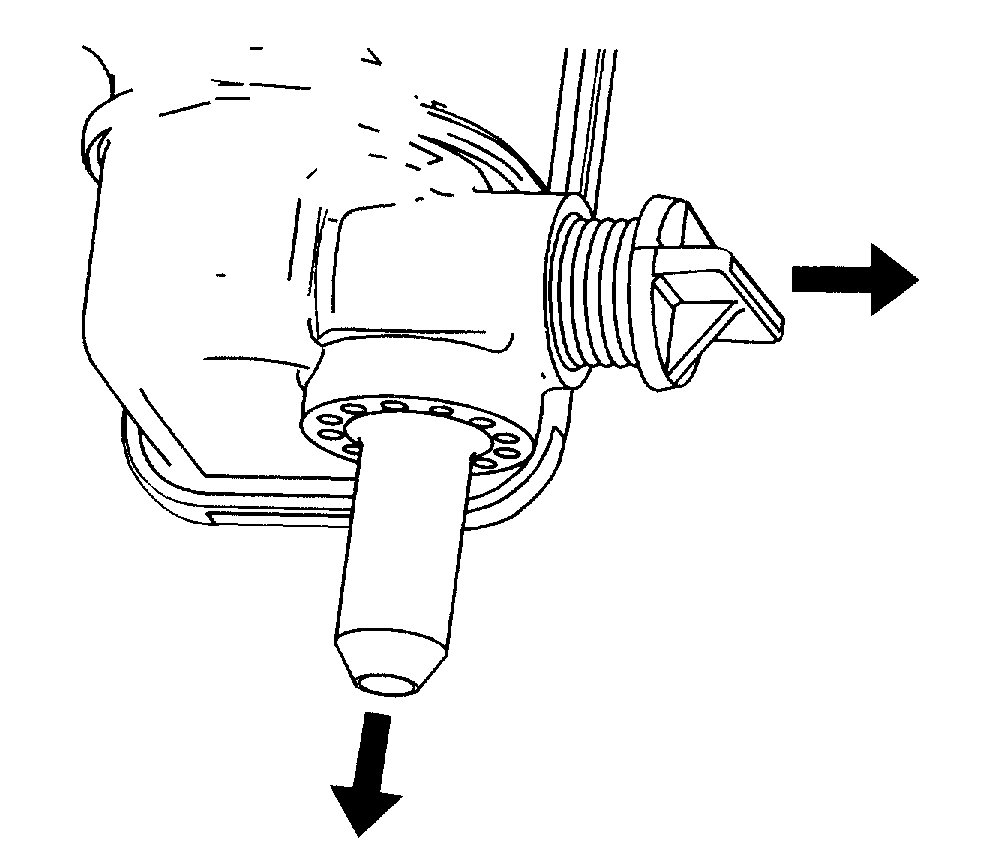

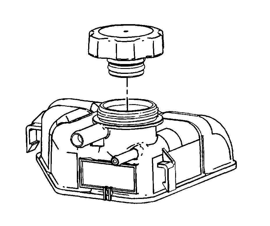

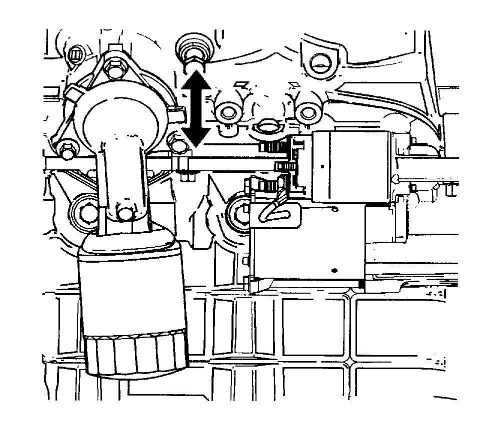

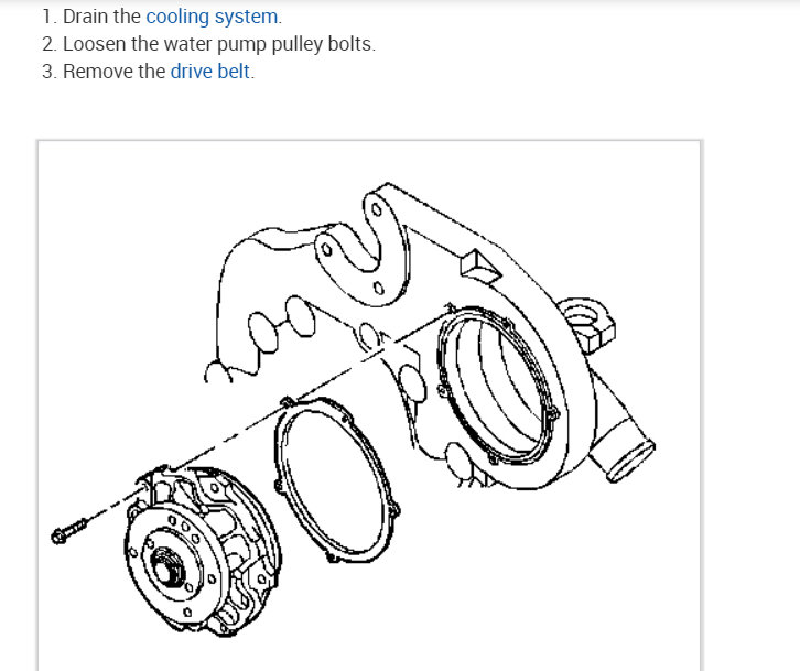

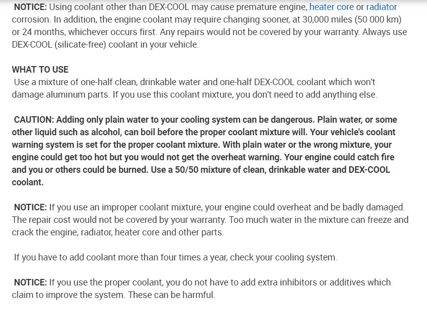

Here are the directions for draining and refilling the coolant. They include bleeding the system. The attached pictures correlate with these directions. By the way, I realize you know how to drain it because you already did it to replace the pump. I'm adding this because it discusses the refilling process too.
Draining and Filling Cooling System (LX9)
Tools Required
- J 26568 Coolant and Battery Fluid Tester
Draining Procedure

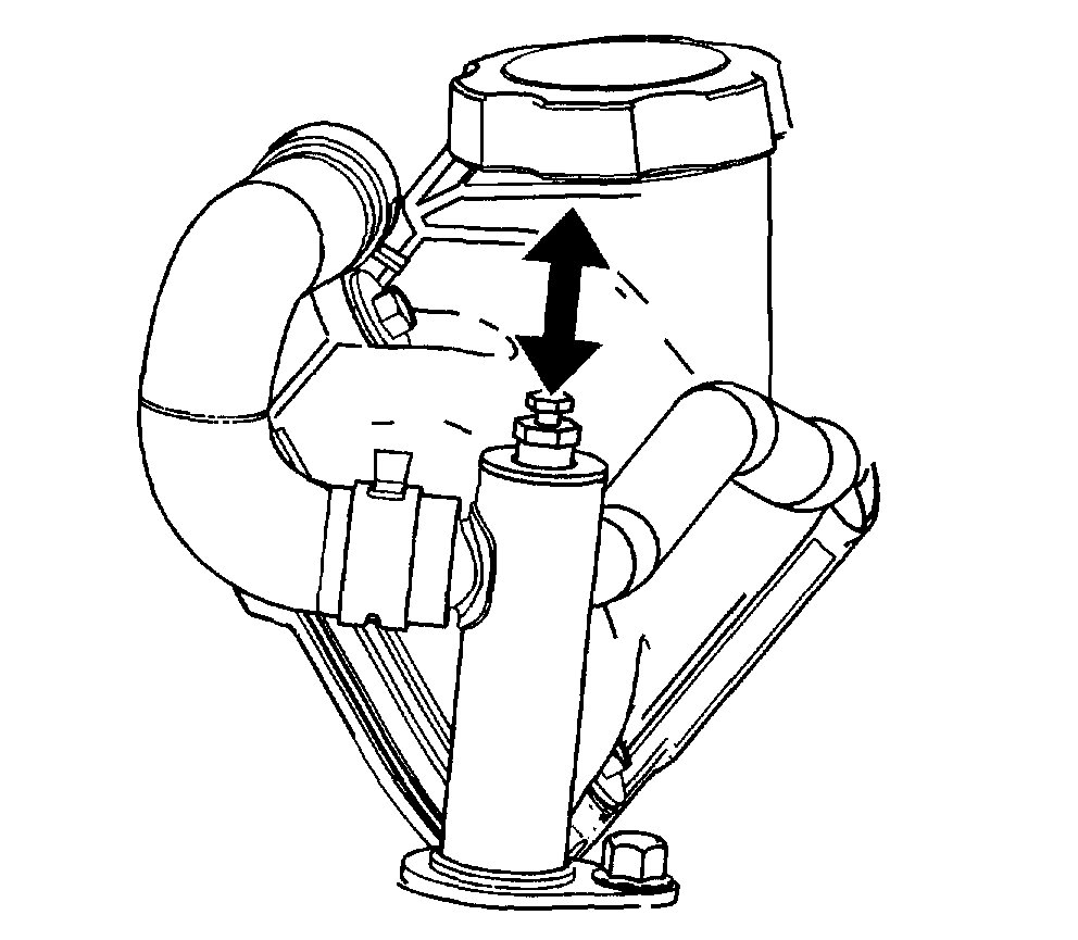

pic 1
Caution: With a pressurized cooling system, the coolant temperature in the radiator can be considerably higher than the boiling point of the solution at atmospheric pressure. Removal of the surge tank cap, while the cooling system is hot and under high pressure, causes the solution to boil instantaneously with explosive force. This will cause the solution to spew out over the engine, the fenders, and the person removing the cap. Serious bodily injury may result.
1. Unscrew the surge tank cap to remove vacuum when draining coolant.
2. Raise the vehicle. Refer to Vehicle Lifting.
3. Place a container under the radiator drain.

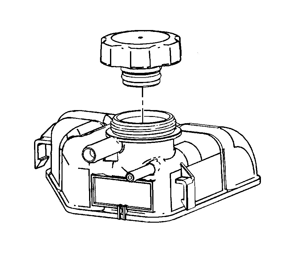

pic 2
4. Unscrew the radiator drain plug until coolant flows out the radiator drain.
pic 3
5. Place a large pan under the engine block left coolant drain plug and remove the drain plug.
6. Follow the appropriate procedure based on the condition of the coolant.
Normal in appearance-Follow the filling procedure.
Discolored-Follow the flush procedure.
Fill Procedure

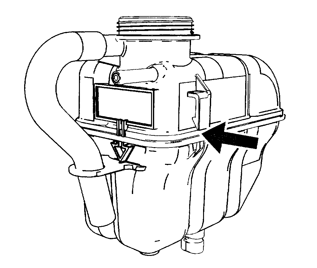

pic 4
Notice: The procedure below must be followed Improper coolant level could result in a low or high coolant level condition, causing engine damage.
1. Install the engine block left coolant drain plug.
2. Close the radiator drain plug.
3. Lower the vehicle.
4. Vehicle should be level.
5. Add a mixture of 50/50 DEX-COOL- antifreeze and clean drinkable water until the level stabilizes at the weld seam on the surge tank. Refer to Capacities - Approximate Fluid in Maintenance and Lubrication.

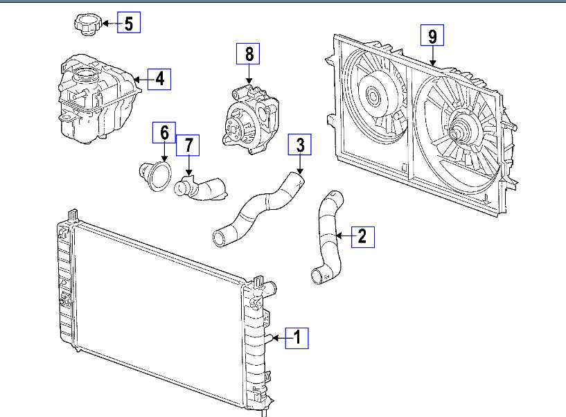

pic 5
Bleeding the system
6. Unscrew the coolant bleed screw on the engine until coolant comes out of the bleed screw.
7. Close the bleed screw.
8. Add coolant until the level stabilizes at the weld seam on the surge tank.
pic 6
9. Install the surge tank cap.
Important: DO NOT exceed 2,200 RPM.
10. Start the engine and run at 2,000 RPM until the engine cooling fans turn ON.
11. Remove the surge tank cap.
12. Refill to the weld seam on the surge tank.
Important: Coolant should be at the full cold mark when the system cools.
13. Install the surge tank cap.
14. Inspect the concentration of the engine coolant using J26568.
15. Rinse away any excess coolant from the engine and the engine compartment.
