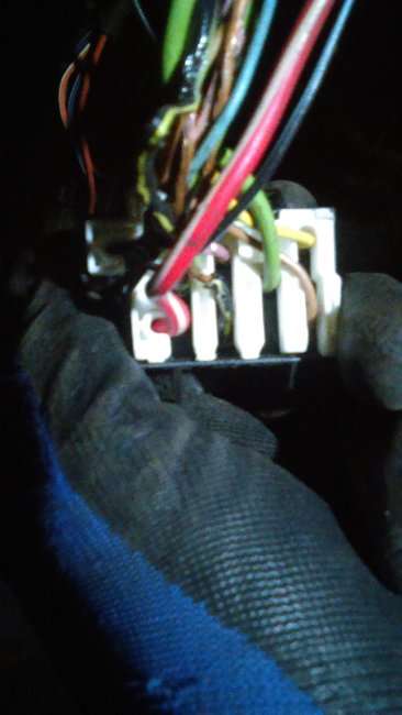

The Original Had Multiple issues then finally went completely out the pigtail(plug) had melted on The Green wire in the center of the switch.
I changed That plug as well,

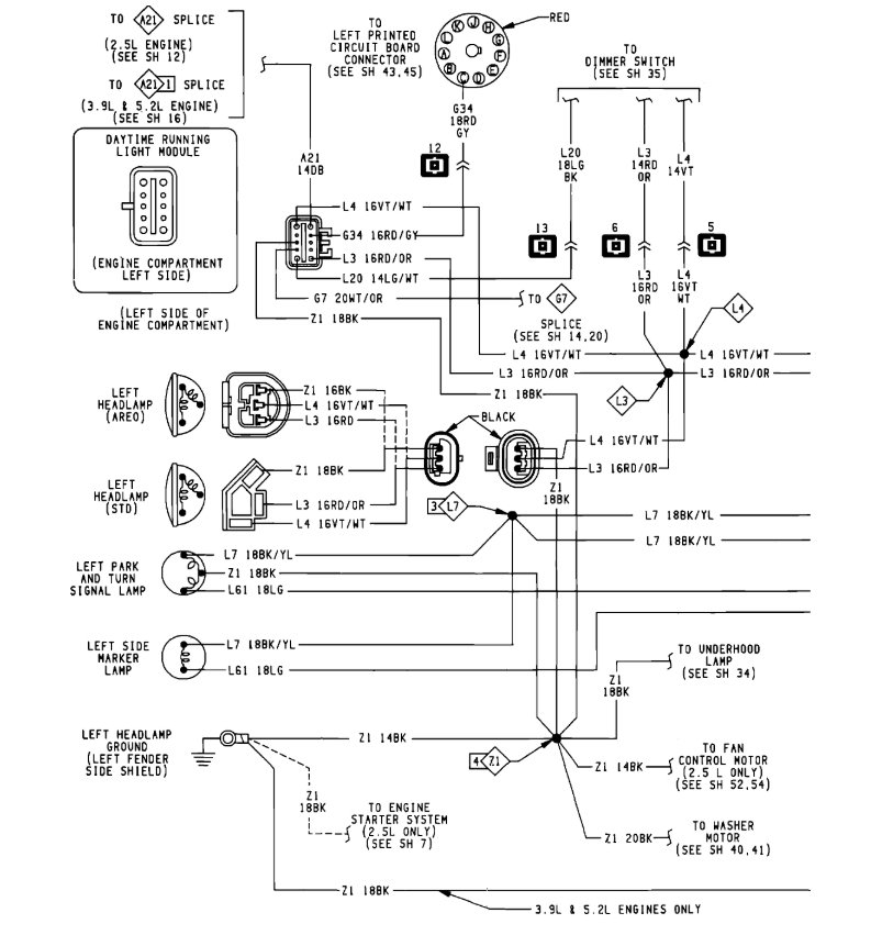

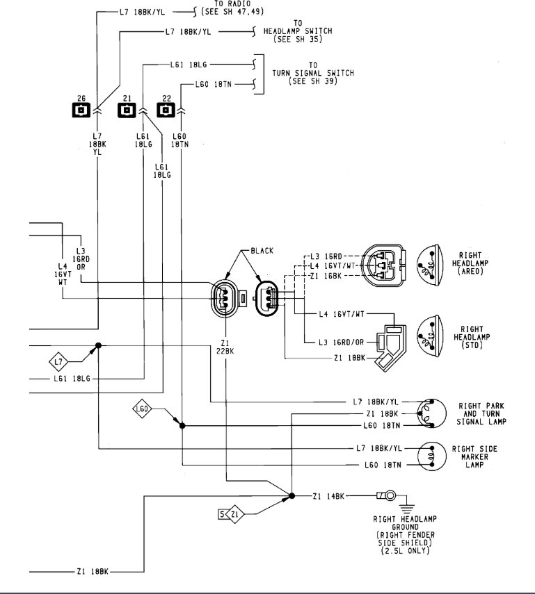

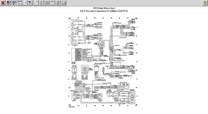

I agree with the ground issue since you said there was melting. that or there's a broken wire caused by the melting. I have sent a diagram of the circuit and a guide to help you test it. let me know if it helps or you need more.

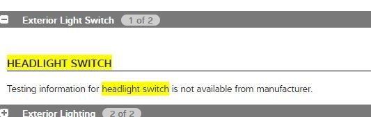

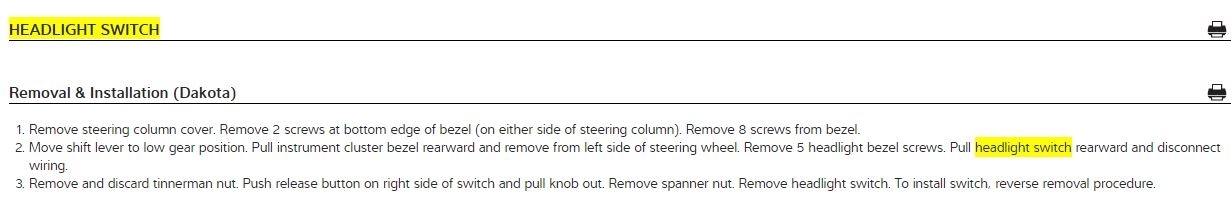

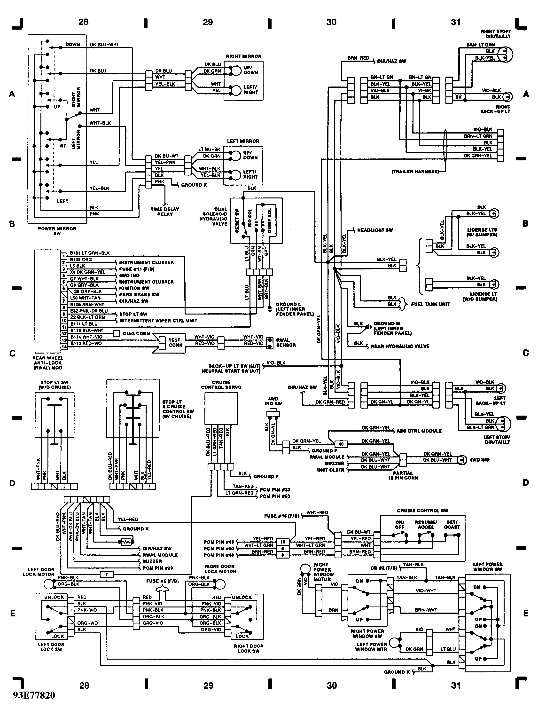

Okay, with that being said, I read through the wiring schematic for the tail lights, instrument cluster, and interior dome light. Every one of the items you mentioned tie into the headlight switch. I also check my manual for headlight switch testing, and it indicates there is no information from the manufacturer. So, here is what I have done, I have attached a wiring schematic for the tail lights and interior lights. Please make sure never to put a higher amp fuse in place of what is recommend by the manufacturer. The would be a recipe for a fire.
Next, I have no idea what knowledge you have for testing wiring, so I have listed a couple links which discuss doing so. Additionally, I have attached links explaining how to use a volt/multi-meter and a test light.
Take a look at the schematic to help guide you through the wiring. It can be a nightmare, but may need to be done. I cannot be certain, but there is a chance it could be the switch itself. But just like you are thinking, it could simply be a short. Before you tear into everything, remove the rear tail lights and make sure a socket for one or more of the bulbs is not bad and causing the fuse to blow. Those sockets pick up a lot of dirt from under the truck over the years and corrode, rust. It could be that simple. Also, remove the bulb and make sure the pins inside it are not sunk into the plastic which could create a short.
Also, if you follow the wiring from the tail lights, you will find about two feet in from the back of the bed (on each side) they wiring harness plugs into another harness. If you even question that the tail lights are an issue, disconnect both sides and see if it prevents a fuse from blowing. If it does, you have narrowed things down to the last two feet of the truck and it will make your life much easier.

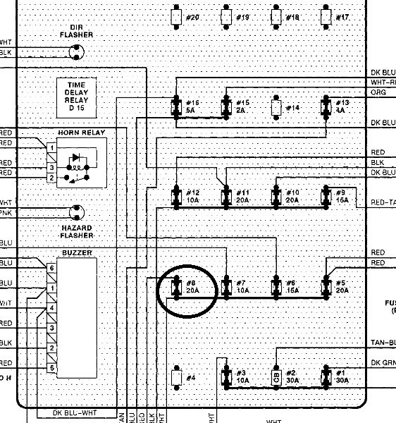

That is a good question. There is always power to the fuse on the battery side regardless if the fuse is blown. When the fuse blows, it stops the current from continuing to the component. Now, regardless if the lights are on or not, there should always be power at the fuse, on both sides of the fuse if it is good, or only on the battery side, if the fuse is blown.

Good work. You are on the right track. Since you get power when the fuse is removed, you need to check two things. First, make sure there is not a corrosion issue with the contact in the fuse box. Make sure the fuse is making good contact. Next, remove the fuse and check it for continuity. Basically, you are checking to see if power goes through the fuse. Even though the fuse may look good, it may be bad. On your multi meter, set it for continuity. There should be a battery in the meter which will provide a small amount of power in this mode. The meter battery will show continuity when you touch the two leads together. It should do the same when you touch one lead to one side of the fuse and the other lead to the other side of the fuse.

I had an afterthought. If you find that there is power which is lost when the fuse is put in, make sure the connector to that circuit is in good shape under the fuse box. It may lose power when too much is required of it.

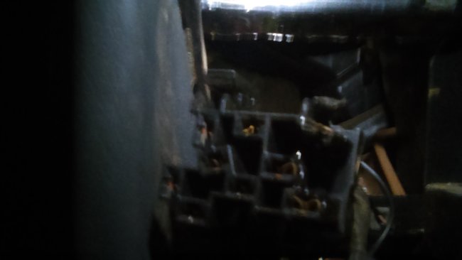

FORENSICS
  • 108 POSTS
Alright, I will check that. Is there a special way to open up the fuse box to see all the wires on the other side to check for the bad connections?

FORENSICS
  • 108 POSTS

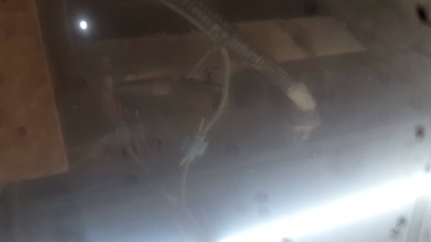

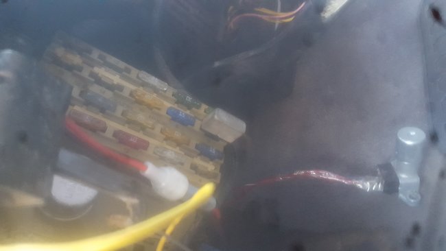

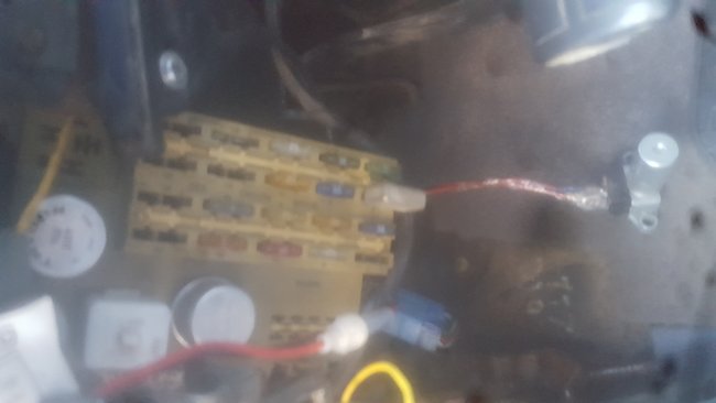

Here are some pictures and a video of my truck if any of this helps.

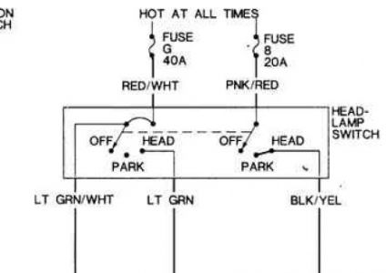

JDL
  • 16,098 POSTS
Did you check voltage to and from the headlamp switch? The black wire with yellow tracer carries voltage for tail-lamps. Use a voltage tester on the wire, head lamp switch on. If no voltage, check the feed wire to the headlamp switch for tail lamps, above in the diagram.

  • 110,192 POSTS
I watched the video and noticed there has been a lot of work as far as splices done to the wiring. Try what I said. Disconnect the rear tail light harnesses from both sides (which will also disconnect the license plate lights), and see if that makes a difference.
As far as the pictures of the fuse box, it is really hard for me to identify anything from the pictures. If I recall, the box is bolted to the vehicle.
Let me know if you have any luck when you disconnect the harnesses.
Thursday, December 3rd, 2020 AT 10:13 AM (Merged)
FORENSICS
  • 108 POSTS
So I finally did it! I pulled down the fuse box and flipped it around and found that the wire did not burn up very far and I repaired the wired connection and now everything works, the dash lights work perfect bright and dim and both tail lights come on too. I just have to get a replacement reverse light socket for my truck since it rusted to bits and pieces. But now my truck is one step closer to being road ready, well I mean it is pretty much road ready it runs and drives. I just have basic age maintenance left to do like suspension, replace as many dry rotted hoses as possible, etc. But thank you Joe so much now my tail lights come on when I turn on the headlights which is just amazing because the electrical of that truck is just a maze, there are wires, cut grounds, and even plugs that I do not even know what goes to what. One day I will probably have to go through all of those wires and organize them better so the next time there is a problem It will be easier to find. But again thank you so much for the help on the electrical.
