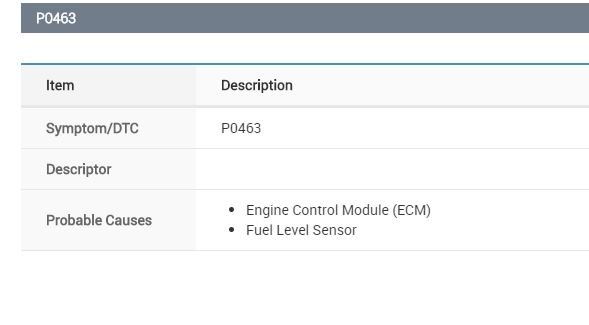

I totally forgot about something. When I purchased the car from auction 2 years ago it displayed the "hiccups" for a day or so and hasn't done it again until now. I did go to AutoZone when it happened 2 years ago and they said code P0463. Maybe that'll help!
Tuesday, December 3rd, 2019 AT 10:02 AM
  • 52,797 POSTS
I would ask them for an explanation of why they think it is the fuse block. It does not make sense at all.
Tuesday, December 3rd, 2019 AT 10:07 AM
  • 52,797 POSTS
No, that is a code for something totally different.
