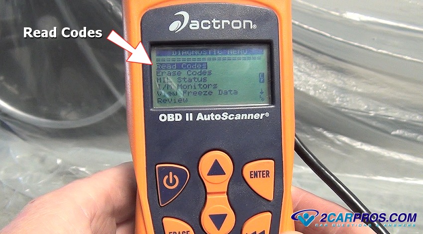

Anytime you have an issue like engine surging it is best to gather the trouble codes even if you don't have a check engine light on, this can help point us in the right direction or area that is causing the problem, the check engine light may not be on if there is a soft code.
read trouble codes

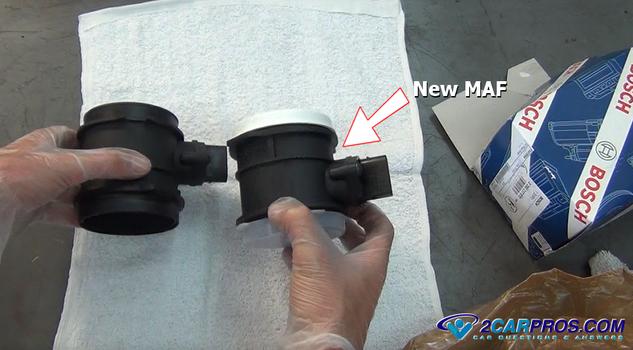

The mass air flow sensor (MAF) or manifold absolute pressure sensor (MAP) is used to send feedback data to the computer to help make timing and fuel adjustments. When these sensors go bad they can omit false information causing the computer to make incorrect adjustments which produce an engine surge. Sometimes you can clean the MAF which can help but we have found replacing the mass air flow sensor is best. This problem does not cause a trouble code because the sensor is still within its parameters, the value the sensor is outputting is just not correct for the engine's speed. This can be confirmed by reading the value using a scanner and then installing a new sensor and recording the difference to confirm the issue.
new maf sensor

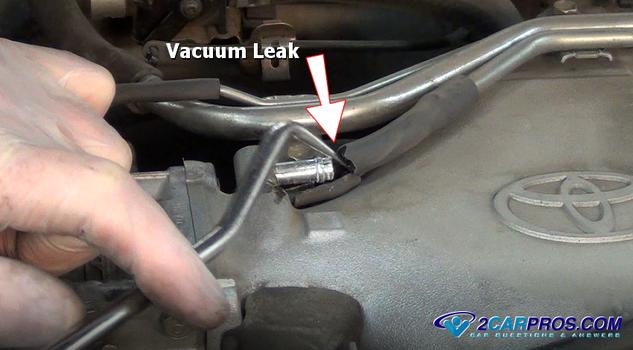

The computer system is designed to work with specific vacuum values and when there is a vacuum leak the computer makes adjustments accordingly, which can produce a noticeable surge. Most of the time you can find this issue with a visual inspection, but if not there are two main methods which involve a smoke machine or the cheaper alternative, carburetor cleaner.
vacuum leak

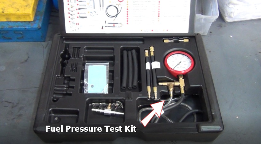

An engine's fuel supply system is designed to operate at a specific pressure, when a fuel pump starts to age this pressure can decrease causing the pressure to fluctuate, as the computer tries to compensate, causing the engine to surge. A simple fuel pump pressure test can determine if this is the problem and if the fuel pump needs to be replaced.
fuel pressure test kit
