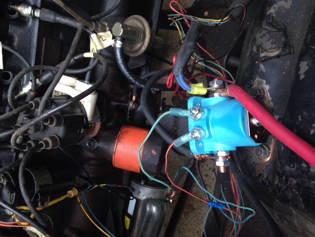

Can you test voltage on "S Wire" removed from solenoid
Static
then
Using key in "on" position, then "start" (and then release key)--CHECKING ALL VOLTAGES
Seeing if "S Wire" remains energized after key is released?

Ok! I don't know what happened but when I went to test everything this morning, it started and stopped like it's supposed to. The only thing I did was remove the solenoid from the fender wall and cleaned the mount surface really good. I replaced it and tried it and it works. Yay!

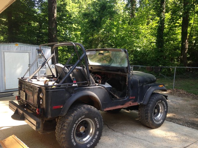

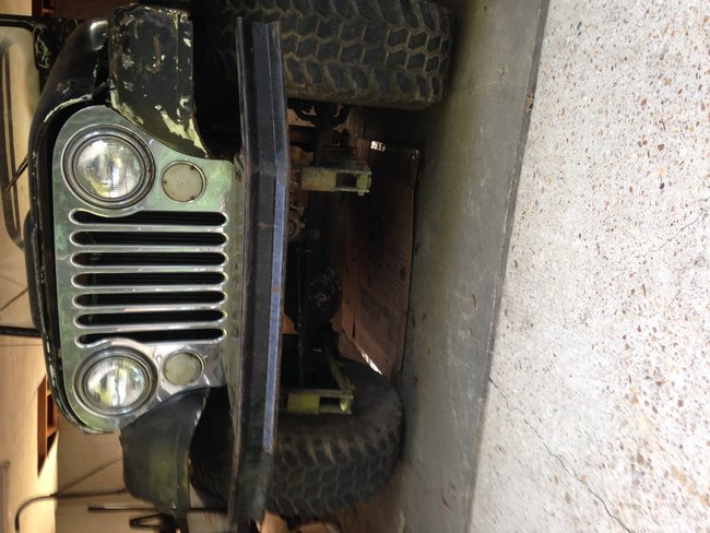

My toy! I've had it since mid April, spent the first 3 weeks going over everything. The VIN proved I had a '75 CJ5 but was originally built with a 232ci, I6. The engine code proved different, it's a 258ci, I6 from a '78 CJ5.
I think the combination of putting in the new ignition switch, new solenoid, and checking all the connections, is what it took to get her acting right.
My next question was going to be about checking the fire. The spark plugs were out of the motor while trying to get it to turn over (which was the first time starting it since I got it). Before while turning it over and the starter not stopping, I noticed there was not spark. Now that it's doing like it's supposed to, there is spark! Whew!
Hopefully later today I can connect the new fuel line to the tank, add new fuel, and get her running.
I will keep you informed on how it goes guys.

The previous owners did a pretty good job of keeping this jeep from being a total rust bucket. I think I know what changes were done to this old girl but I could be totally mistaken.
One of the PO's had homemade shackles installed, they look very dangerous to me. I plan on replacing the shackles and springs for a smoother ride. I have researched SOA lifts and full suspension lifts, I'm not sure what direction I'll go with that. I do know that this jeep has 35x12.50r15 tires on her now, I like the way it sits. I'd like to keep this look but want to do so with every aspect of safety in mind.
Thanks for your concern and input, it's greatly appreciated.
