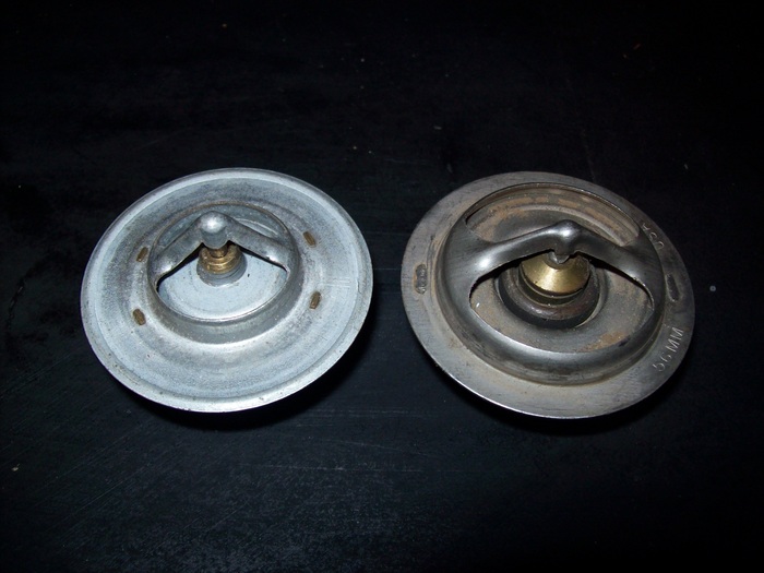

I bled the system of air several times/burped it. Tested cooling system pressure (held perfect pressure for 25 minutes without a leak). Checked oil and coolant for signs of head gasket leak (oil in water, water in oil) and both were negative. I have also installed 3 different brand new thermostats, two brands, and had the same symptoms all three times.
