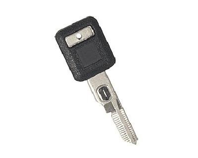

The car will not start sometimes, it has a security light that comes on. You have to wait for the light to go out, usually takes about two to three minutes. When the light goes out the car will start. Any ideas on what the problem is and how to fix it.

That's the VATS kicking in.
The cheapest and easiest thing to try is get a new key.
I'm assuming your key has a chip in the middle of it like this one.

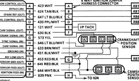

1992 Buick Lesabre 6 cyl Front Wheel Drive Automatic
car turns over but wont start. No fire, no blown fuses. No fire in wire going to crank censor or camshaft censor

https://www.2carpros.com/forum/automotive_pictures/170934_buick_1_1.jpg
If your saying there is no ref voltage to crank or cam sensor, then you need to do some testing at the module.
