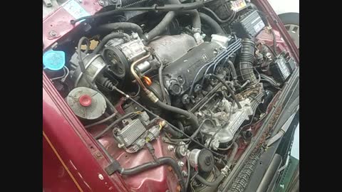

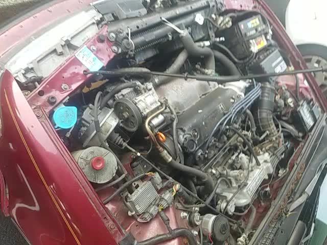

It was running perfectly, I put a new radiator after it had been in an accident it ran fine for a month then started stalling while I was driving down the road. It only happened once or twice and then it got to be more and more to where it wouldn't start. After taking it to a shop that I'm saying it's my motor mounts and battery cable still was not fixed after $250.00 charging me. So I replace the main fuel relay. I replaced the ignition switch. I replaced most of all my fuses in both fuse boxes. I tested the spark plugs the distributor it works fine. My RPM's go down to 500. When I hit on the gas and let go it stalls right away. I'm so confused of what the problem could be. Can anybody that has had this problem help me? I've looked online everywhere.

It sounds like you have a timing belt that has let go. To be sure can you please shoot a quick video with your phone so we can see what's going on? That would be great. You can upload it here with your response. I need to hear the engine crank over so I can tell. Please let me know.

Thanks for the video. The timing belt sounds okay, I would now think the engine has no spark like the distributor has gone out. To be sure lets check the system. here is a guide to help you check for spark:

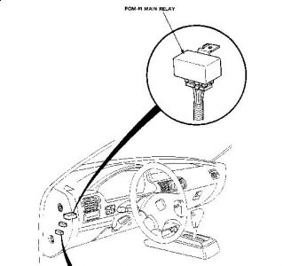

My 1990 Honda, on hot days, will not start. It will crank, but sounds like it isn't firing. If I cycle the ignition ket 4 or 5 times, then it will start. I have haeard two different reasons for the proble: 1) the fuel pump is bad or 2) there is a circuit board under the dash that controls the fuel pump relay that has a problem due to the thermal cycles of heating and cooling for the vehicles age. I'm wondering if the problem is the fuel pump relay itself possibly having burnt contacts due to the age and needs relpacement.

The cause should be the PGM-FI main relay located under dash. Quite often the soldered contacts of the circuit board of the relay cracks causing intermittent failure. Unplug the relay from its housing and resolder the contacts.

PHIL TOMLINSON
Thank you for your response. Do you know how difficult it is to get to the relay? I probably won't get it repaired for awhile, since it is working now.

Hi Phil,
It really is not that difficutt to get to it. Just have to move the seat as far back as possible and crawl under the dash and look up.
It would only be intermittent failures most of the time but sometimes it would just fire up and then stall. Under such circumstances it might not start until you wait some time. I would advise getting it done as such electrical faults are rather unpredictable and we do not know when it is going to fail or work.
