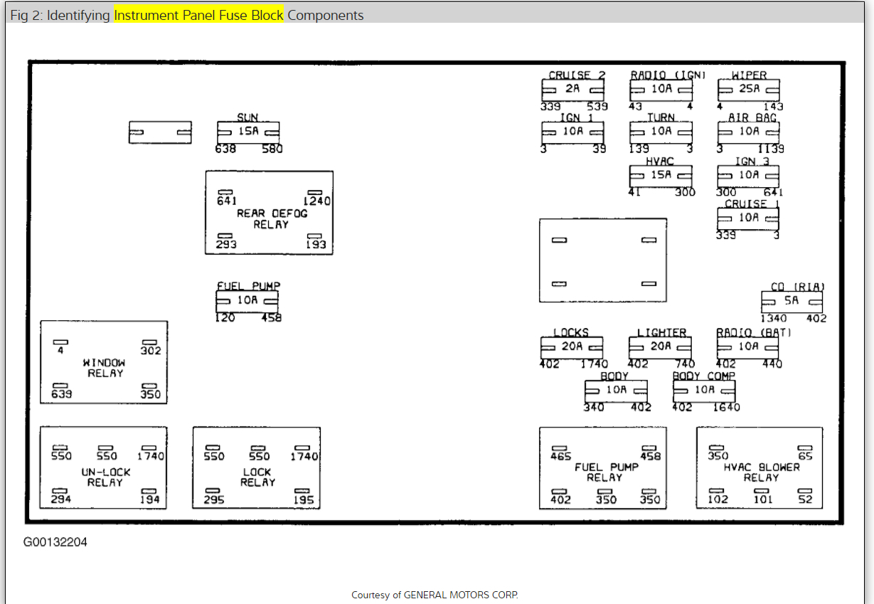

Helping my brother repair his 02 SL2. It's been sitting for several years and now he's getting it on the road. It cranks but won't start. Replaced the plugs and wires since they needed to be changed anyway, no luck. Checked and it doesn't have spark. Had the ignition coil packs checked and they're good. Tried hooking a diagnostic scanner up to it but it doesn't connect with the computer. I suspect the computer or the wiring to it. Anyone have a wiring schematic or any other suggestions. BTW I don't know if the fuel pump is pumping either. If the computer isn't powering up would the fuel pump work?

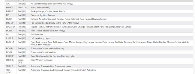

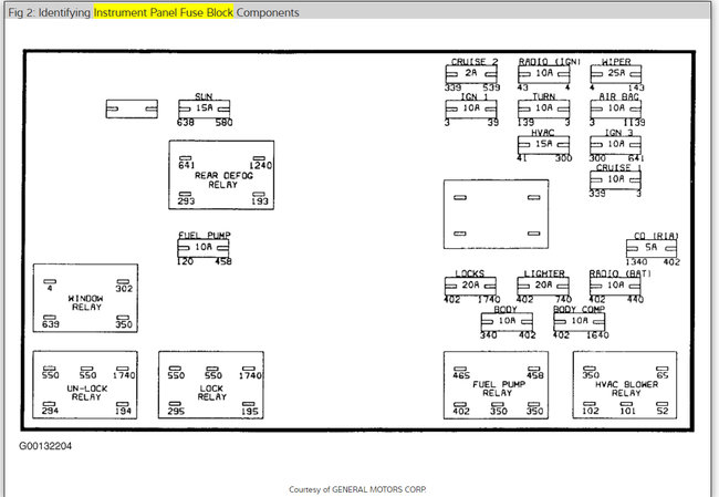

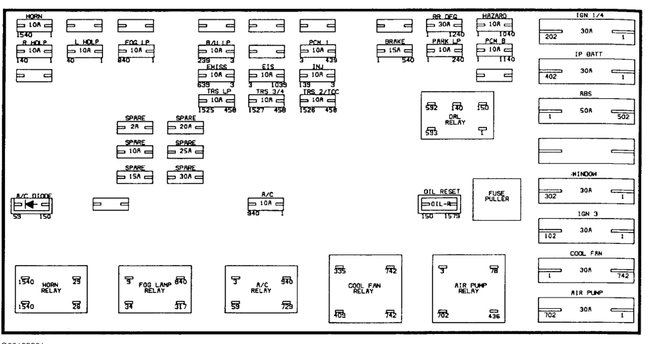

The first thing i would check is that the battery is good and charged the battery cable's are clean and tight.Make sure all the fuse's are good in the under hood fuse box especially the ecm one also check all the fuse's in the inside fuse box..
When you first turn the key to the run position go to the inside fuse box and see if the fuel pump relay click's on then off.

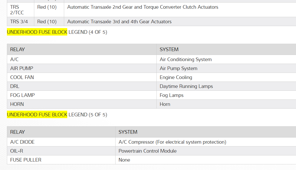

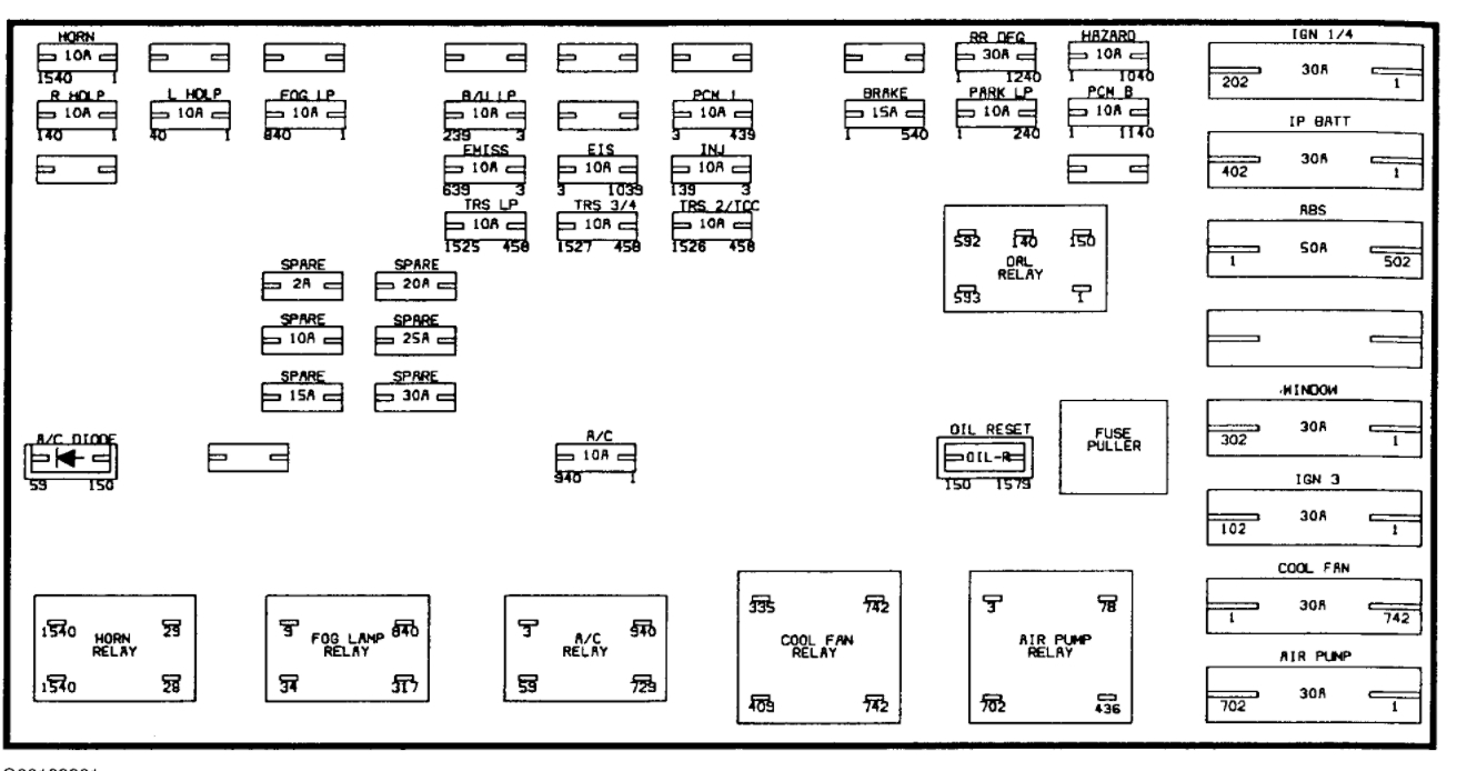

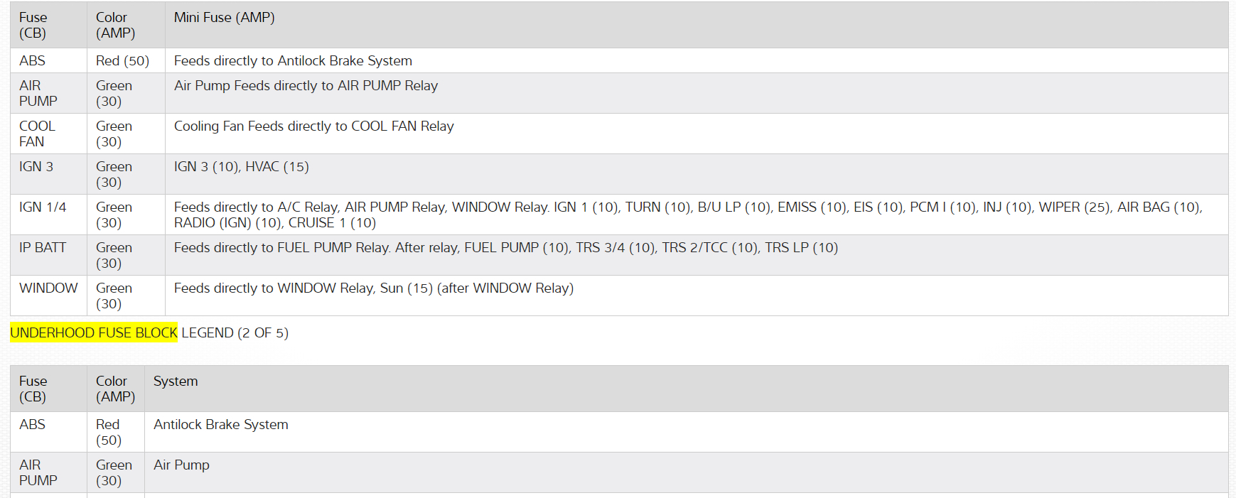

Thanks for the help SaturnTech9! The battery is charged and the connections are tight. I checked all the fuses under the hood and in the car and they are all good. I checked out the fuel pump relay in the car and it didn't click when we turned the key to "run". So I unplugged the relay from the socket and tested the relay and it's good. I'm familiar with this relay. I put 12VDC across terminals 85 and 86 and the relay clicked. So I put my meter on the socket at 85 and 86 and didn't get anything when we turned the key to "run". What controls that relay? Also, I didn't see a fuse labeled "ECM" under the hood but did see "PCM". Is that the same thing or do I need to check something else? Thanks in advance

You said the scan tool doesn't talk to the computer we need to start there with all that you describe. No voltage to fuel pump no spark. Yes you would check the pcm fuse and make sure you have power to both sides of it with the key in the run position. If your scan tool doesn't have batteries in it will the scan tool power up off the car?

Yes, checked both sides of the PCM fuse and both sides are +12vdc with the key on and go to -12vdc with the key off. I'll get my buddy's scanner and try it without the batteries tonite. Is the PCM and ECM the same thing? Does the ECM/PCM turn on the fuel pump?

Alright here's the difference if your car had a manual transmission you would have a ecm engine control module. Since you have a automatic transmission you have a pcm power train control module when ever you combine the engine computer and the transmission computer together like they did on your car then it's a pcm when they have the engine computer by itself it's a ecm. Also when they have the transmission computer by itself for a automatic it's called a tcm transmission control module. Let me know if the your buddies scanner powers up.

Also make sure all fuse's are good inside and out check and make sure the bcm fuse has power to both side's of it.

Here is a guide to help you check the fuses.

Okay I tested all fuses and they all do what there supposed to as you said except the radio fuse it stay hot at all times. There is no radio in the car at the moment. Any ideas what the problem is. Also I want to thank you for all your help.
