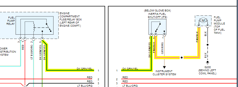

Truck will start and run fine, but shuts off after a few minutes and will start right back up. Does it have a ICM or a fuel pump driver?

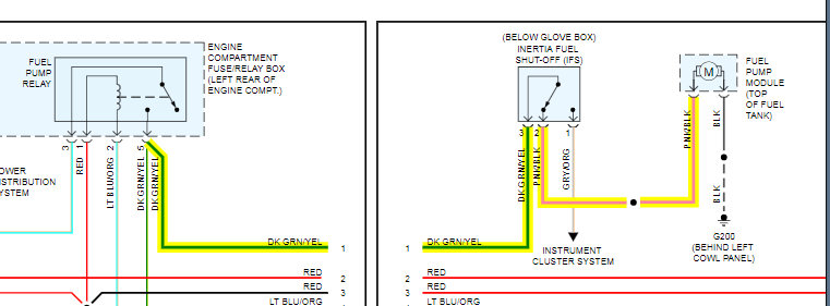

This vehicle does not have a fuel pump driver. It has a relay and the driver is part of the PCM. Basically the PCM sends the signal to close the relay and then the signal goes through an inertia switch to the pump. When this happens we need to leave the key on and check the switch just to make sure it is not opening.

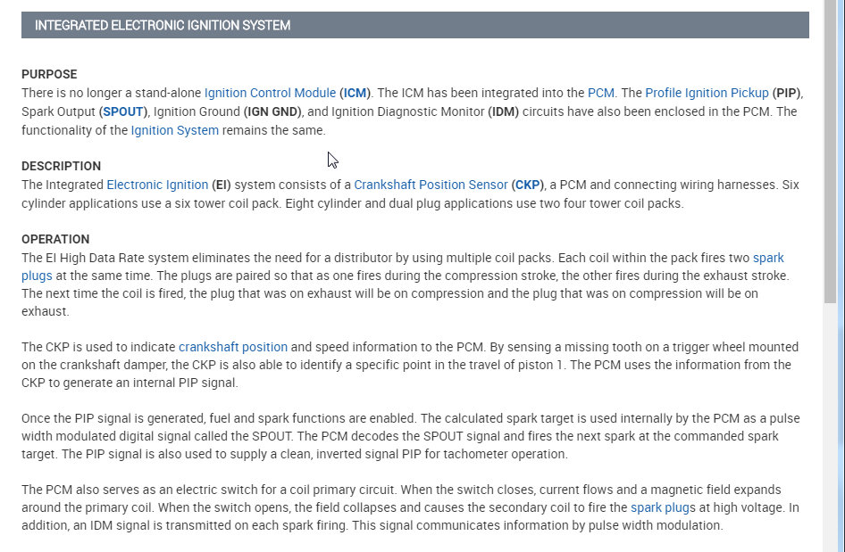

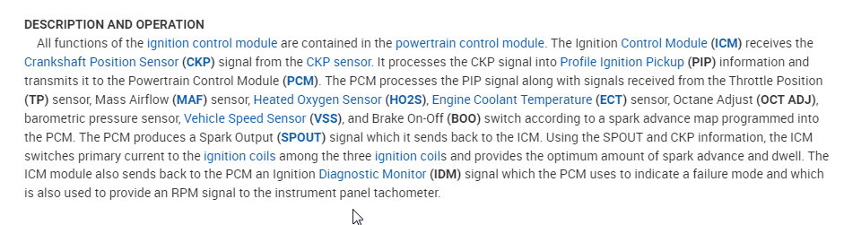

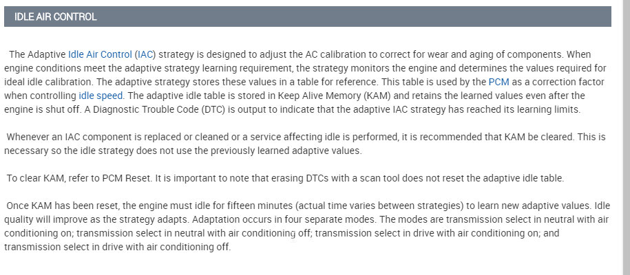

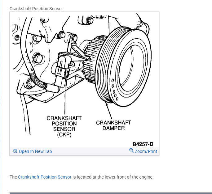

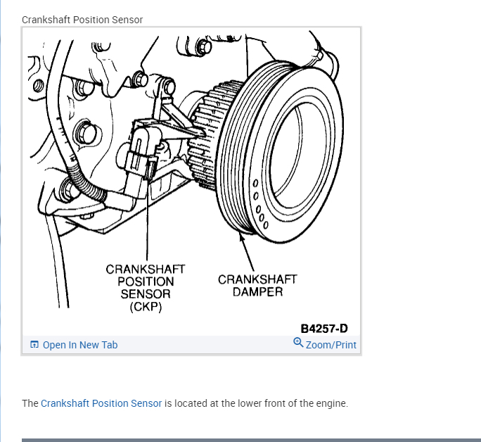

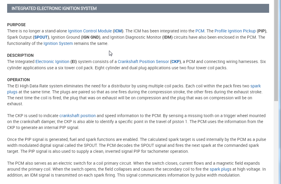

Next I attached the info about the ignition system and we need to suspect a crank sensor as the most likely cause. Clearly there are other causes of this like and idle air control valve not functioning properly.
I have attached the info on all this for your review. Let me know what you find with this and we can go from there. Thanks
https://www.2carpros.com/articles/idle-air-control-valve-service
