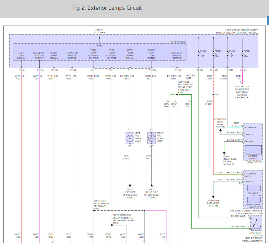

Hello. Turn signals will flash fast like that when there is a burnt bulb or broken wire somewhere in the system. The easiest thing to do would be to turn the left signal on and check and see which lights flash. Then do that for the right side and compare to what you saw on the left side. Then simply replace the bulbs of any lights that are not working, even if they appear okay. Check the guides linked below:
Turn signals blink fast: https://www.2carpros.com/articles/turn-signals-blink-rapidly
Turn signal bulb replacement: https://www.2carpros.com/articles/turn-signal-bulb-replacement
If replacing the bulb(s) does not fix it, then we will go through checking the wiring (anyone can do that with a little guidance). Let us know what you find either way.
Read the guide below on testing wiring, it will help
The wiring diagrams for your exterior lights are attached below

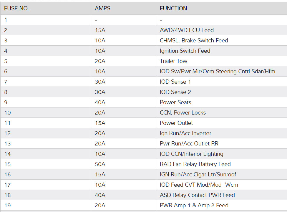

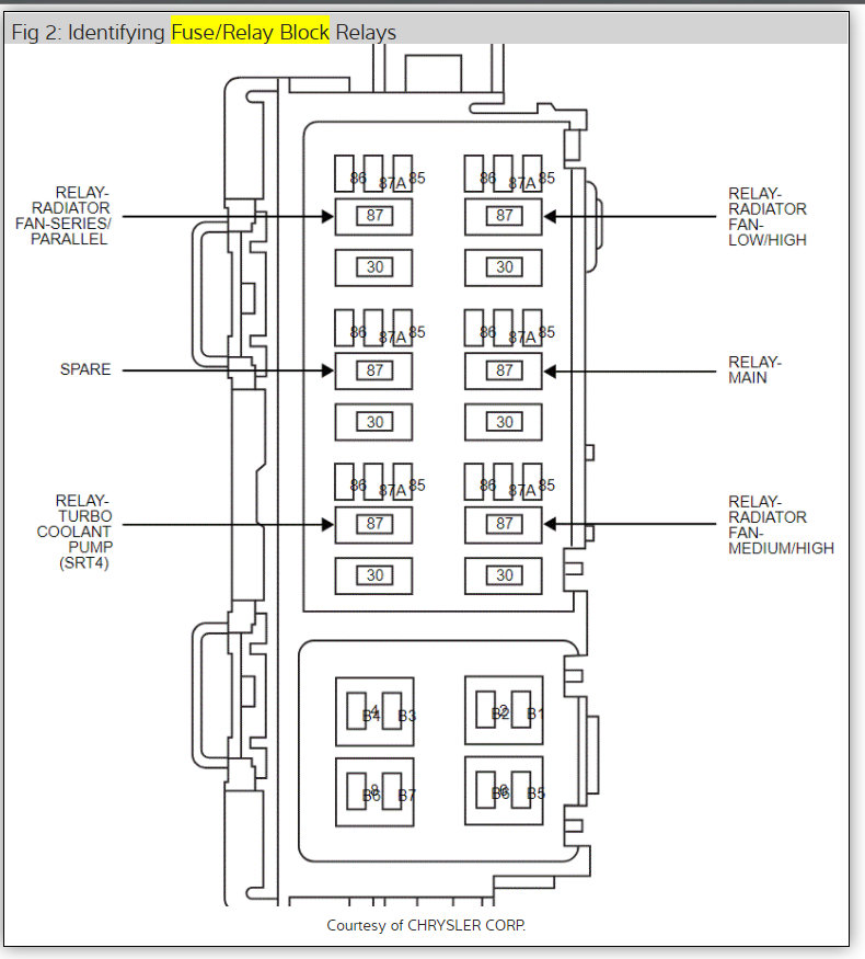

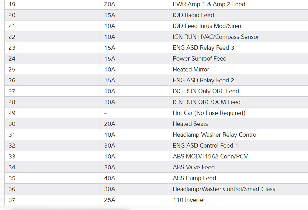

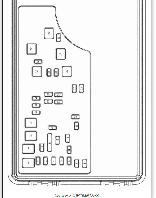

Looking at the wiring diagrams there are several fuses that need to be checked first here is a guide to help you with that.

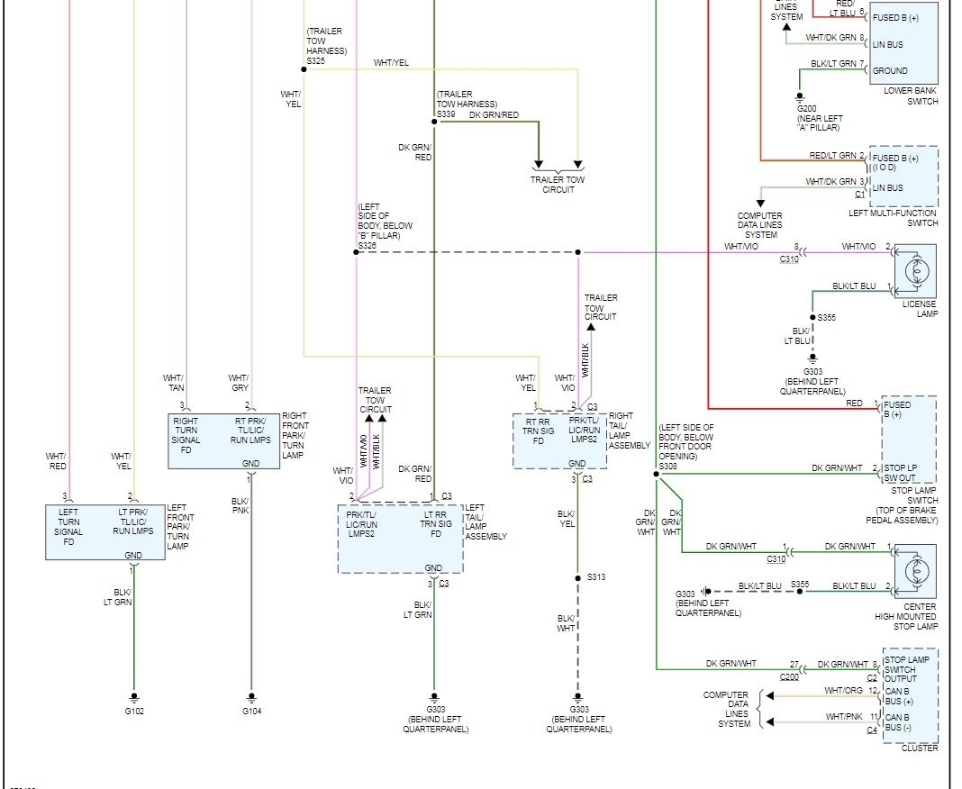

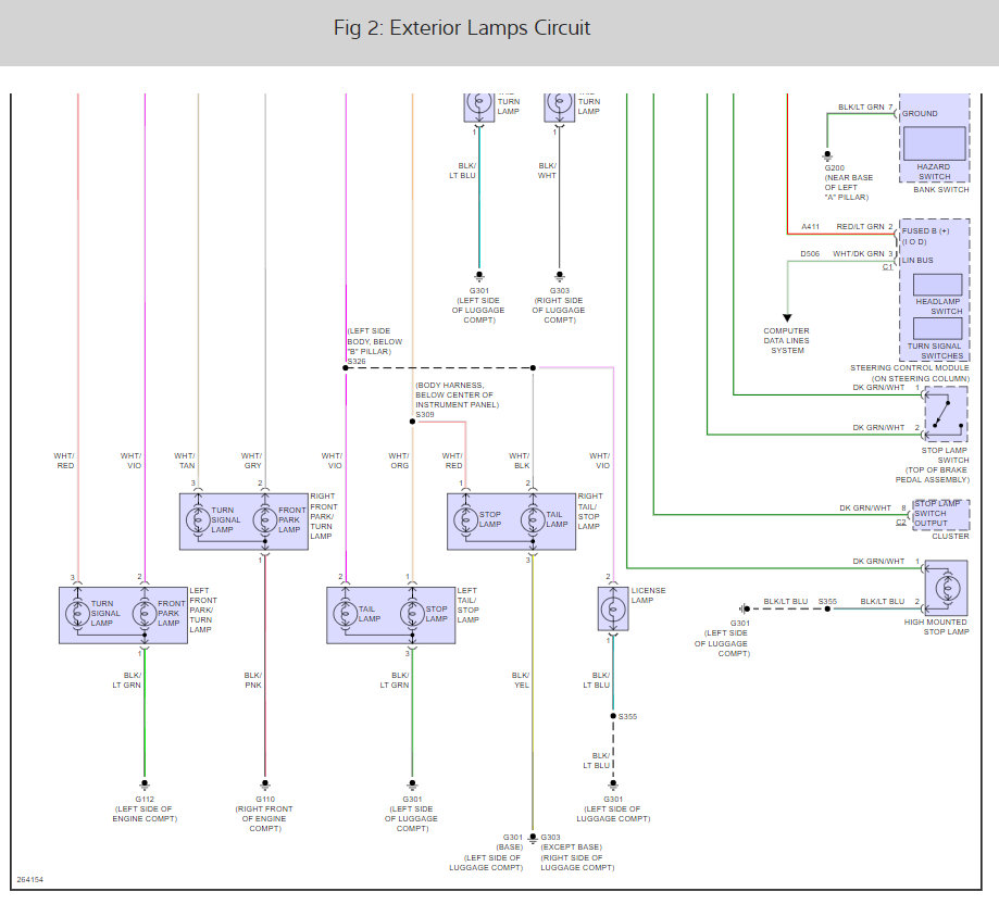

Here are the turn signal wiring diagrams so you can see how the system works and the fuse panel locations and identification. It could be the TIPM I have seen where they have problems.

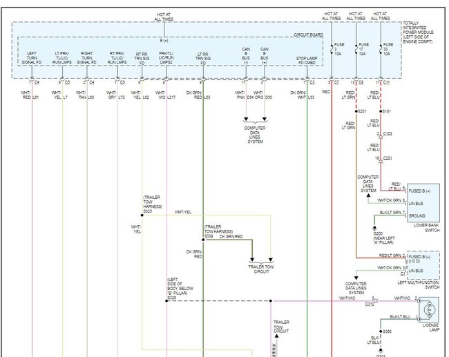

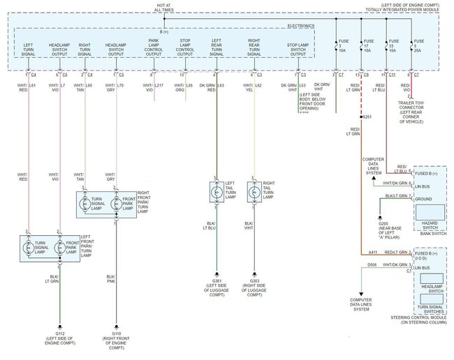

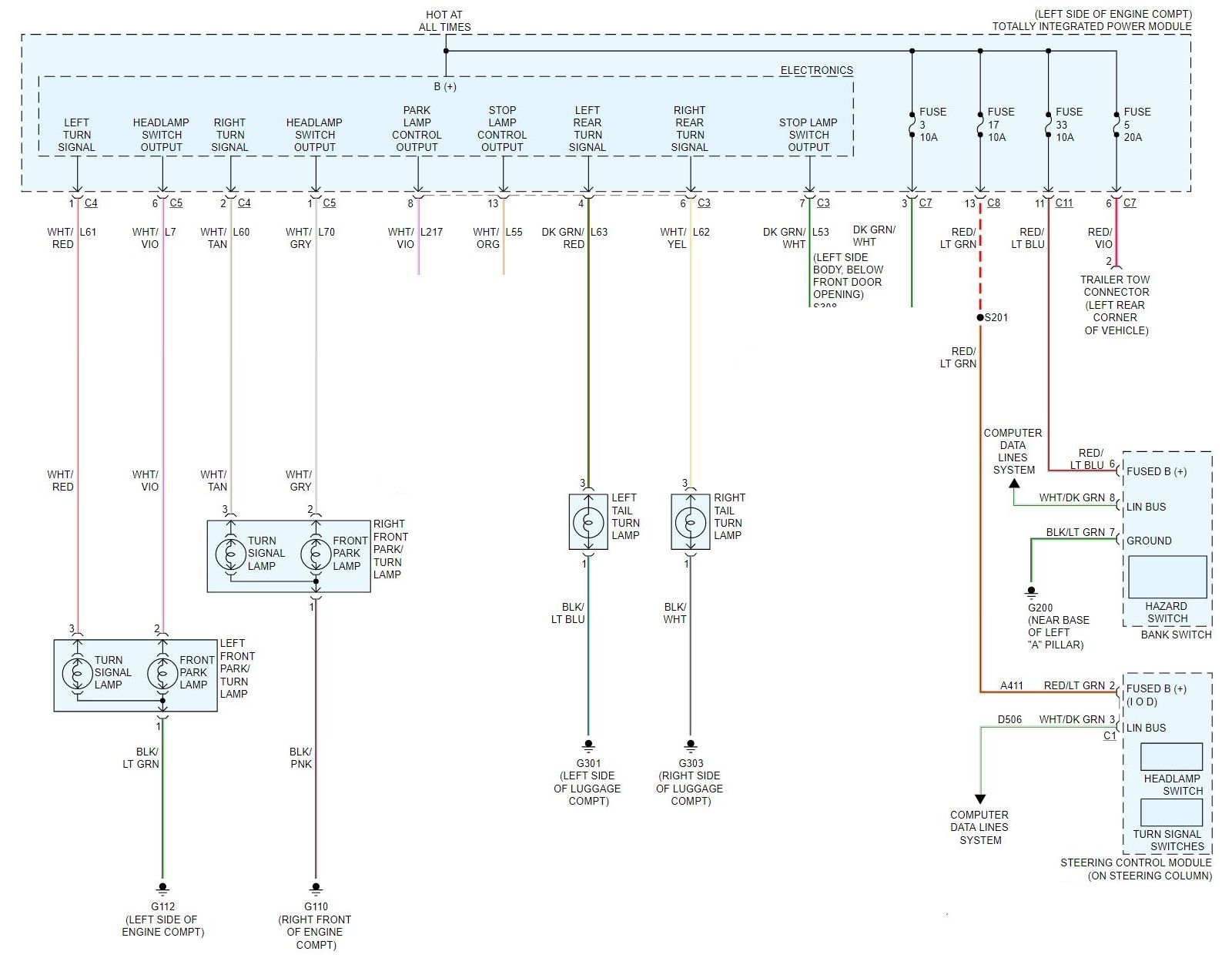

A common failure on this year is the TIPM module, it is the smart fuse box and controls most of the electronics in the car. Each turn signal lamp is an individual output from the TIPM. If the other turn signals all work you can eliminate everything except the TIPM, bulb and it's ground wire.
In your case I would start at the lamp in question. Verify the lamp is good, then use a test light connected to ground and, with the turn signal on check to see if one of the terminals shows battery voltage pulsing on and off. If it has that then the issue is likely a ground. The ground wires for the turn signals are all black wires with a colored stripe depending on which corner. To test those you would connect the test light to battery power and then probe the ground terminal in the socket. If it lights then the circuit should be good.
The diagram is cropped a bit to show just the relative circuits and ground colors. If you trace the output for the signal in question back to the TIPM and find no output on it, the repair is to replace the TIPM and have it initialized if it is a used or rebuilt module.
