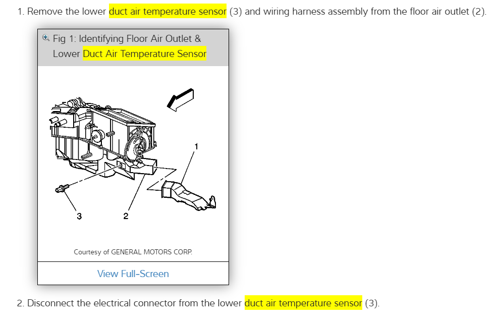

There is an air temperature sensor in the lower left duct (inside) I think is bad, let's unplug it to see what happens and see if the -44 changes. This is the problem and why the heat stays on. Check the image below. Please let me know.
