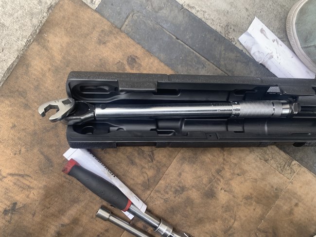

Thank you. Luckily the ones I had to replace weren’t too bad to do; got them from the junkyard for $3.00 a piece. Yes, I got rack in fairly quick and believe I have it centered. I got a torque wrench for when I install lines. I was reading that for the torque wrench I have to make sure the wrench is at a 90 degree angle when torquing the lines, is that correct?
Saturday, April 18th, 2020 AT 8:57 PM
  • 110,192 POSTS

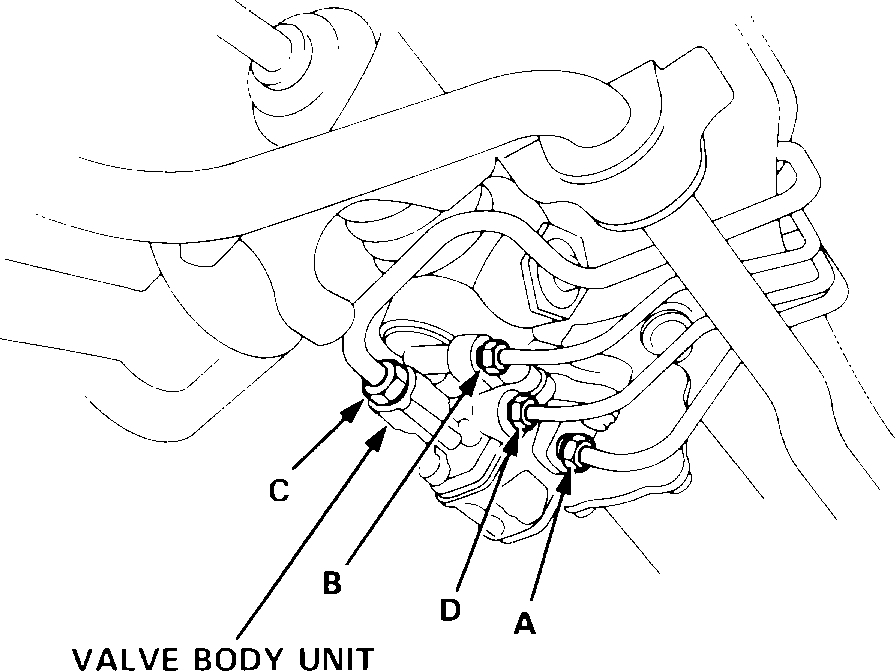

What type of torque wrench did you get? Is it something that can go over the steel lines and onto the nut? If possible, could you take a pic of it and upload it so I can see what you are working with?
Here are what I have. Nothing as far as 90°.
6. Connect the four lines to the valve body unit, using flare nut wrenches.
A: From pump: 14mm wrench 38 N-m, 3.8 kg-m, 28 lb-ft
B: To oil cooler: 12mm wrench 13 Nm, 1.3 kg-m, 9 lb-ft
C: To reservoir: 17mm wrench 29 Nm, 2.9 kg-m, 21 lb-ft
D: To power steering speed sensor: 12mm wrench 13 Nm 1.3 kg-m, 9 lb-ft
Saturday, April 18th, 2020 AT 10:13 PM
JORDAN013
  • 55 POSTS

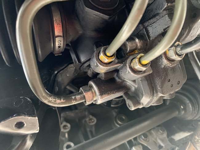

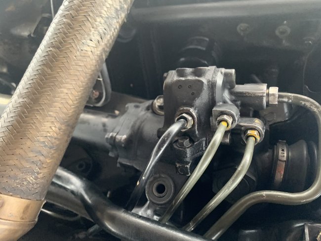

Here is the torque wrench and set of flare that I am using; I got the lines hooked up for the most part but don’t want to force anything; tried to get torque wrench onto the lines and flare nut but very difficult to get onto the flare but itself. Any tips? I don’t want to over-tighten.
Sunday, April 19th, 2020 AT 12:27 PM
JORDAN013
  • 55 POSTS
The lines currently.

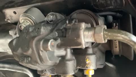

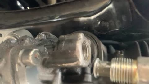

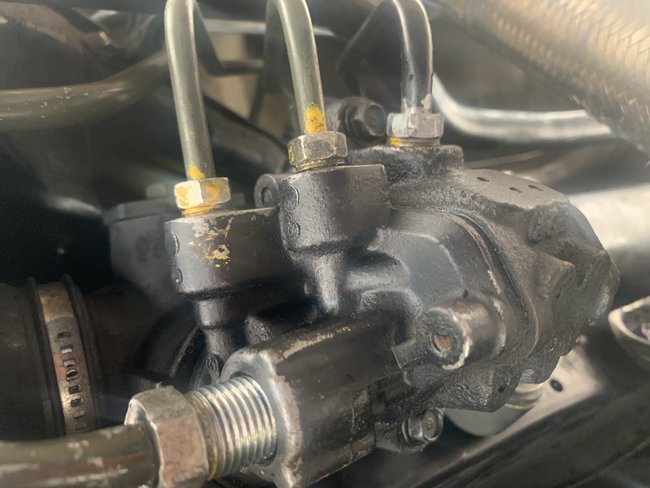

Waiting until tomorrow to get the 17 mm line installed, for some reason it was giving me some trouble as it didn't line up directly with hole where it threads into like the other lines, kind of have to pull on it a bit and hold it straight to start threading the flare nut. Any tips? I don't want to mess up anything.
Sunday, April 19th, 2020 AT 2:13 PM
  • 110,192 POSTS
That looks great so far. As far as the one you are having trouble with, what I do is this. Take the fitting and push it so the pipe (flare) is touching and none of the steel pipe is pushed through. Then try to start the threads. When the pipe goes in first and you try to then start the fitting, it is real easy not to be straight.
I did watch the video and it is slightly on an angle. Try what I said above while you try to angle the threaded fitting so it's straight. You'll get it.

I believe I have gotten the line to thread in and have been able to turn it with the flare nut wrench, but it does take a bit of force to turn it. Can you please confirm I am doing this correct? Everything appears fine but I want to double check before continuing.

In the video there is a little bracket with rubber that holds this 17 mm line, should I remove it? Because I believe it is putting pressure on the line in one direction. In the video before this last one, you can see the line is angled a bit down and I believe it is due to that little bracket.

Got the line in more and I made sure to release the pressure on the bracket then once it was in, I tightened the bracket; working on getting tie rods on but need new fitting for zerk.
Monday, April 20th, 2020 AT 1:44 PM
JORDAN013
  • 55 POSTS
I believe the lines are good to go. Tightened them and made sure there was no pressure against them, installed the outer tie rods, then filled the system, turned from side to side, ran the car and continued the turning from lock to lock. Checked the lines at the time, no leaks. Let the car sit, went back to check, no leaks again, lines are dry as a bone which is awesome and looked at the reservoir and fluid is clear, no bubbles.

Excellent job! I wish I had people that worked as neatly as you. Everything looks great. Is everything back together and working properly now?
