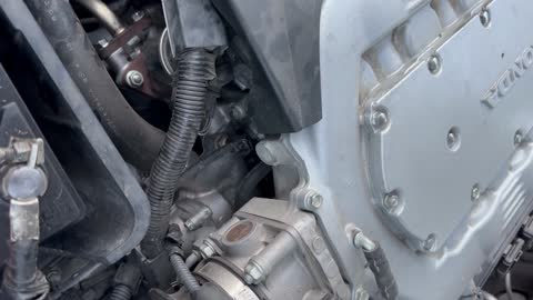

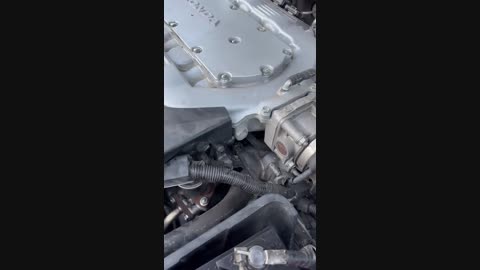

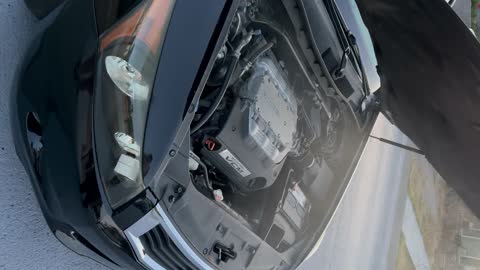

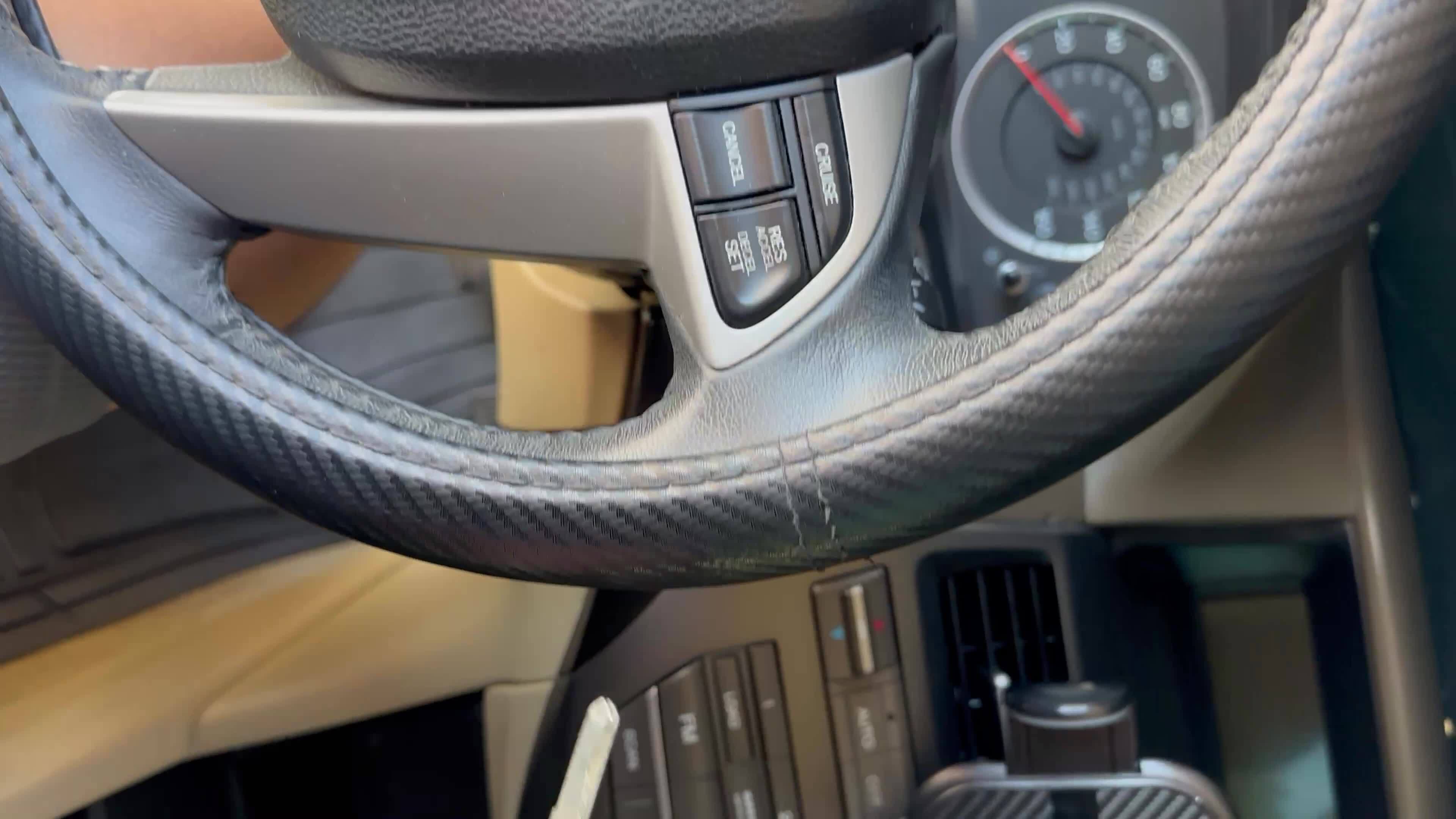

Back again with another potential issue. This morning I woke up to an absolutely dead car while yesterday it was driving perfectly fine. As you can see from my most recent post, I replaced the alternator and battery at the end of March this year. I had someone give me a jump and the car started right away but as soon as I turned it off and tried to start it, it did not turn on. After a few times of doing that the car was able to stay on but later started throwing what seemed like vapor. I let it run for about 10 minutes and it turns off and on just fine, but I am worried about driving it to work now. Any guesses?

Another thing I wanted to add is this weird sort of whining sound that seems like it is coming from the dash inside the cabin, not sure if the video did a good job of capturing it but I do not remember hearing this noise before. The car is not overheating or anything like that either.

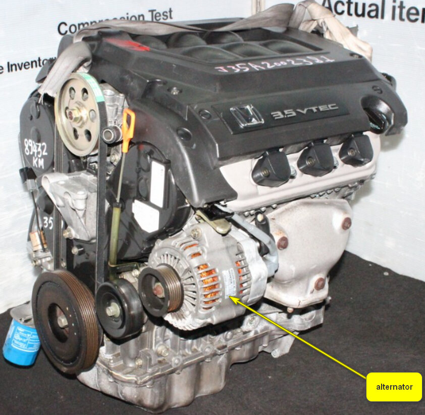

Looking at the first video the "vapor" seems to be coming from the back of the engine.
This would exclude the alternator as this is located to the lower side front. See image 1 below.
Perhaps an exhaust leak?
Your issue seems to be either a faulty battery, yes new batteries can get faulty, or a parasitic battery drain.

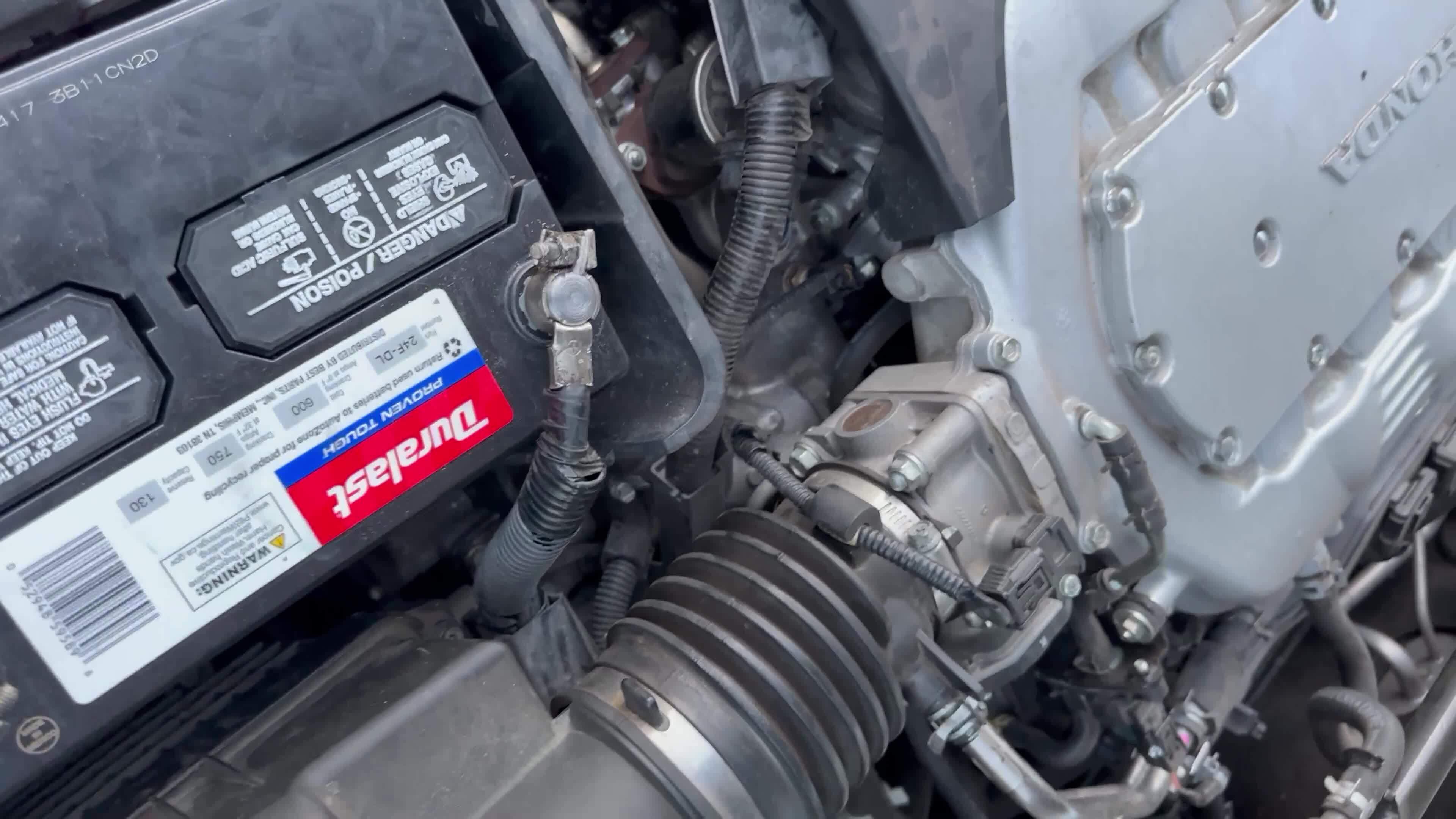

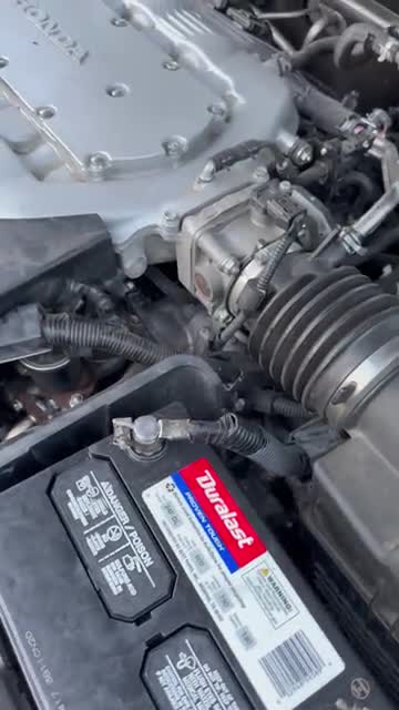

It’s funny you mentioned that, when I had the car running, I managed to scan it with the Bluetooth OBD scanner I have and a “PO134” code came up, indicating some sort of a issue with an oxygen sensor. Before that, as in the last couple months, my check engine light would occasionally come on and off in its own with a “PO430” code, indicating the catalyst system below threshold Bank 2. Should I replace the cat converter or the o2 sensors? Also, I dropped the battery off at AutoZone for charging and testing, I will be picking it up this morning so I will let you know.
Thursday, May 25th, 2023 AT 6:54 AM
JGONZO2398
  • 409 POSTS
Just went to AutoZone, guy told me battery did not charge at all overnight, so it is bad. Just got a new one and about to install it.
Thursday, May 25th, 2023 AT 7:43 AM
JGONZO2398
  • 409 POSTS
Car started right up and drives well. A second issue now, the A/C is blowing room temperature air, no longer cold, my luck never stops, I guess. I also dropped the car off at a shop, they will be replacing the Bank 2 cat converter.

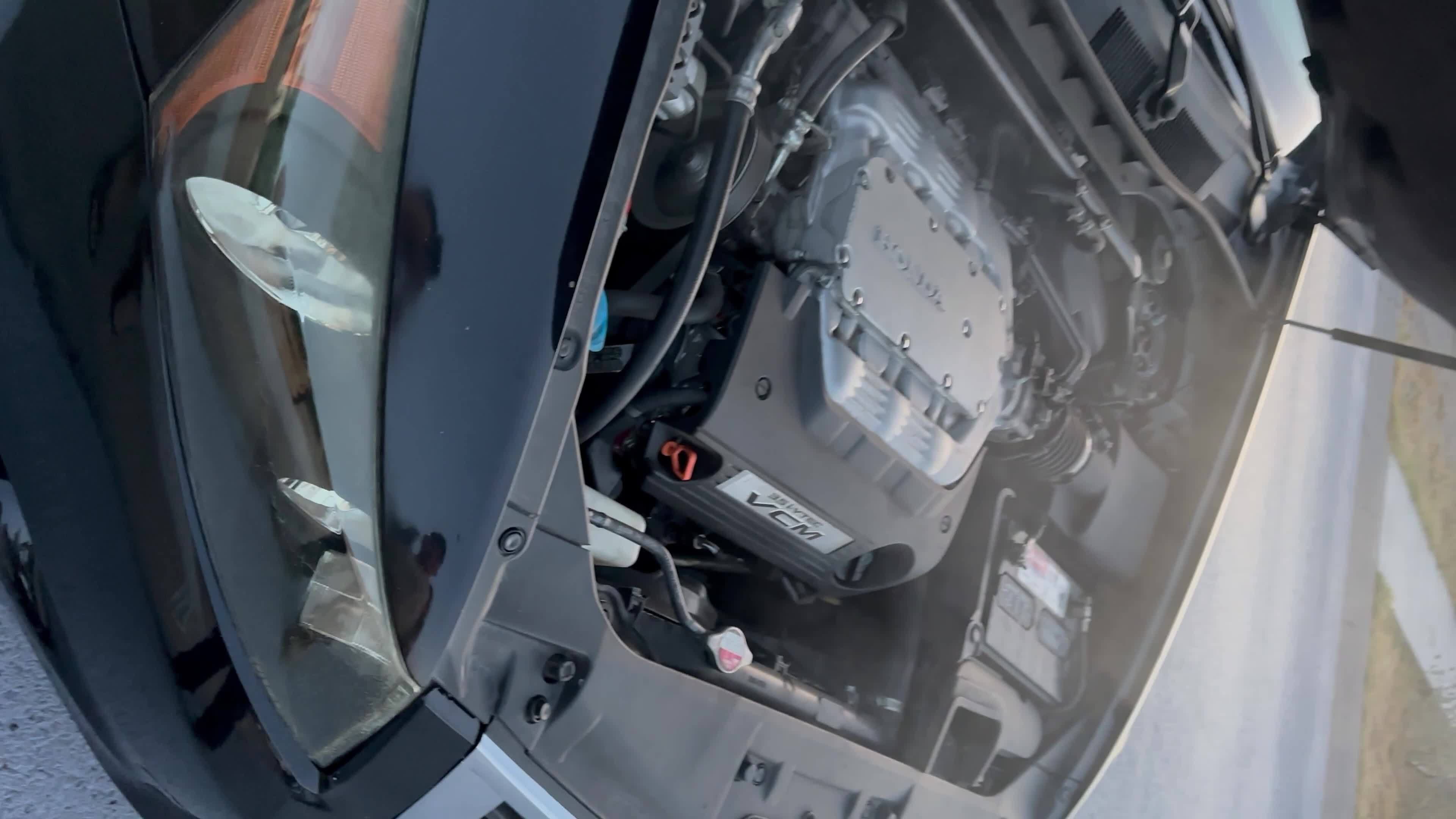

No noticeable odors coming from the vents but now I am starting to wonder if that vapor or smoke that blew from the back of the engine was possibly a refrigerant line that blew? Because I had no hissing noises or A/C issues up until that very moment just two days ago. Also, I am not sure if I simply do not know how to use a refrigerant refill bottle or the A/C system had no freon at all because when I plugged it into the low-pressure hose line, the valve remained in the same spot even after squeezing the bottle a handful of times.

Another thing I noticed yesterday that I wanted you to take a look at is this sound that seems to be coming from within the engine when the car is turned off. It sounds like air pressure is released followed by a couple clicks. Any guesses?

So, I ended up replacing the front cat converter in bank 2, that seemed to get rid of the check engine light I kept getting. The AC issue was a bad AC compressor, it wasn’t spinning so I had that replaced on Saturday and now I have cold air. However, that air pressure release sound that seems to come from within the engine is still there. It happens when I turn off the car, there’s a sound similar to air being released and then two clicking sounds. I posted a video of it so you can get an idea.

It sounds like the A/C system high pressure pop off valve it letting go, does the A/C system have too much refrigerant?

So, it turned out that I had a short circuit issue because my new battery died once again. The A/C clutch relay was short circuited and kept running as if it were still on, so I got that replaced and no issues anymore, no check engine light at all since I've replaced the cat converter and my A/C is blowing cold. So far so good.
