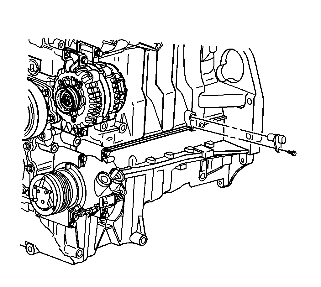

Here are directions specific to your vehicle. The two attached pics correlate with the directions.
_______________________
2006 Chevy Truck TrailBlazer 4WD L6-4.2L VIN S
Crankshaft Position Sensor Replacement
Vehicle Powertrain Management Sensors and Switches - Powertrain Management Sensors and Switches - Computers and Control Systems Crankshaft Position Sensor Service and Repair Removal and Replacement Crankshaft Position Sensor Replacement
CRANKSHAFT POSITION SENSOR REPLACEMENT
CRANKSHAFT POSITION (CKP) SENSOR REPLACEMENT
REMOVAL PROCEDURE
1. Raise and support the vehicle. Refer to Vehicle Lifting.
pic 1
2. Disconnect the crankshaft position (CKP) sensor harness connector.
3. Remove the CKP sensor retaining bolt.
4. Remove the CKP sensor from the engine block.
INSTALLATION PROCEDURE
IMPORTANT: Inspect the sensor O-ring for the following conditions:
- Any wear
- Any cracks
- Any leakage
Replace the O-ring if necessary. Lubricate the new 0-ring with engine oil before installation.
pic 2
1. Install the CKP sensor into the engine block.
NOTE: Refer to Fastener Notice in Service Precautions.
Tighten the bolt to 10 N.m (89 lb in).
2. Install the CKP sensor retaining bolt.
3. Connect the CKP sensor harness connector.
4. Lower the vehicle.
5. Perform the CKP System Variation Learn Procedure.
