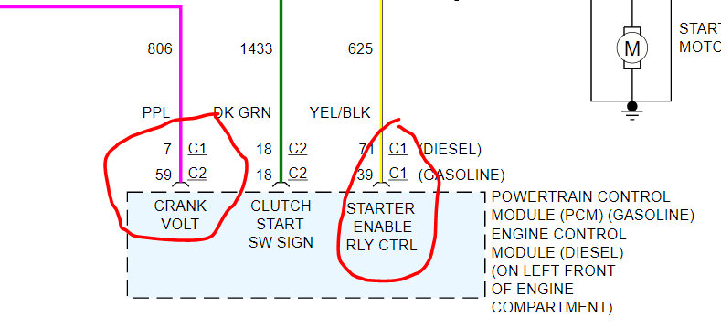

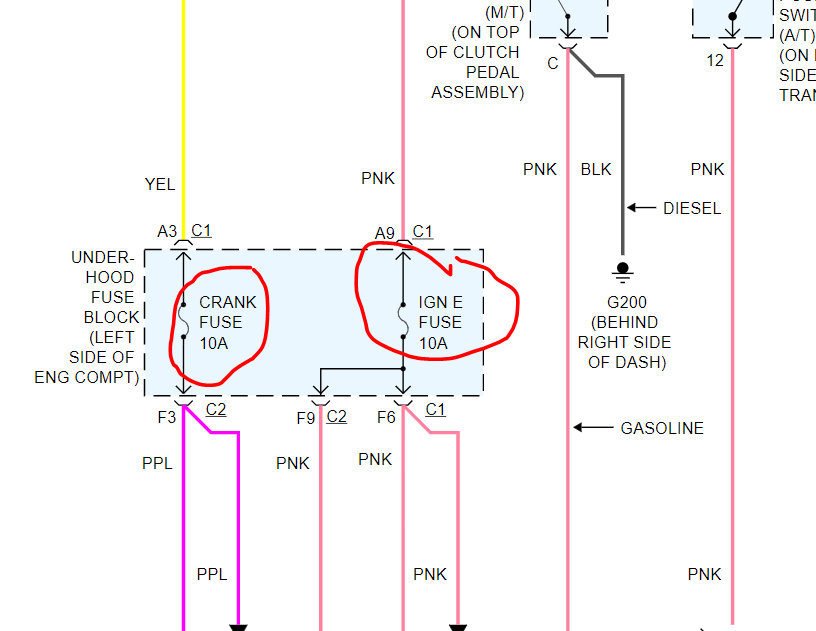

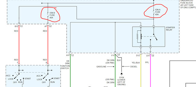

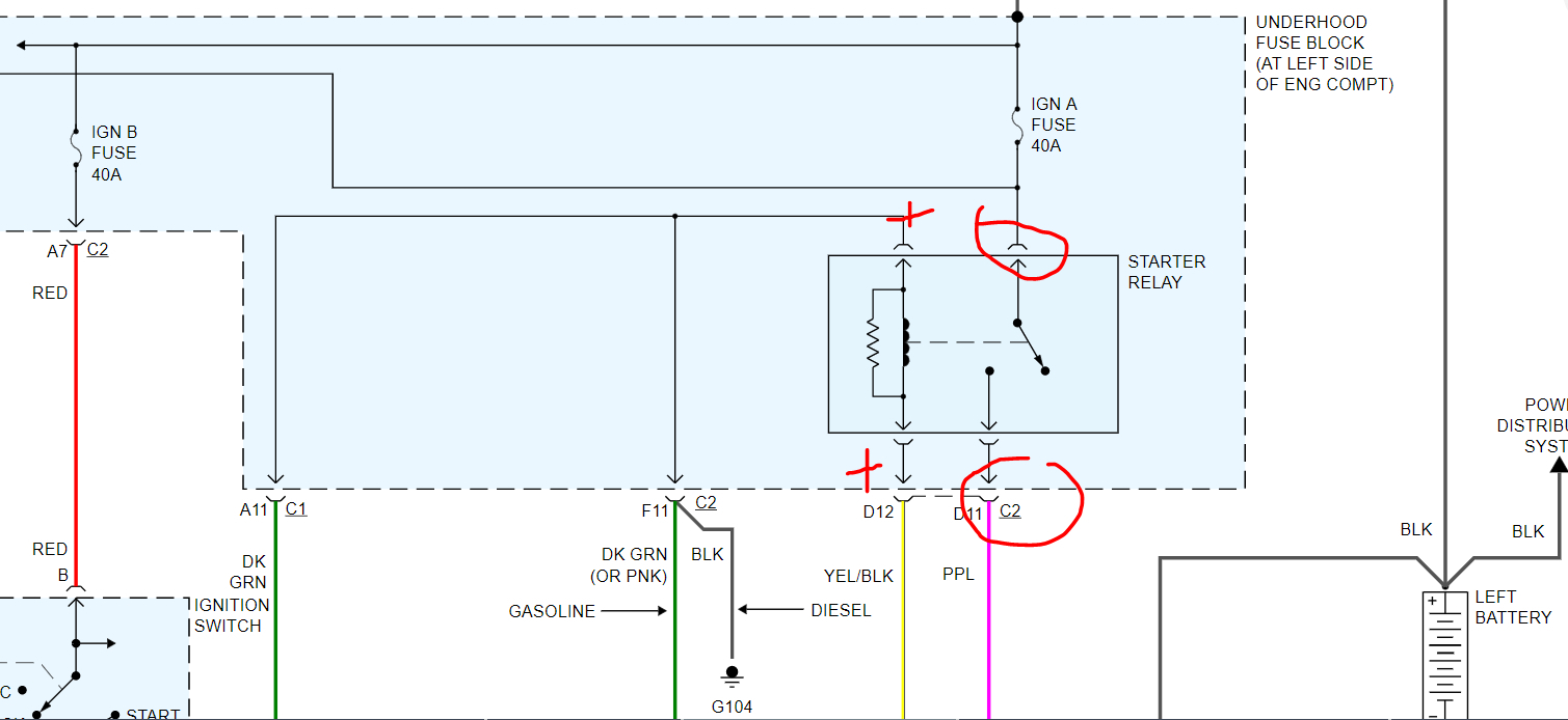

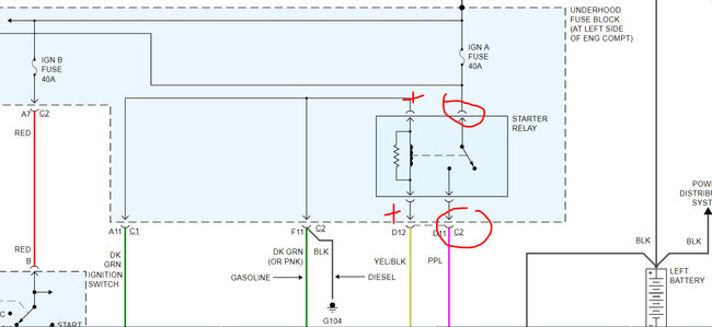

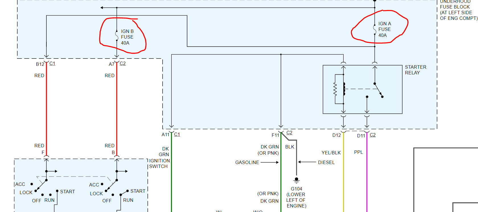

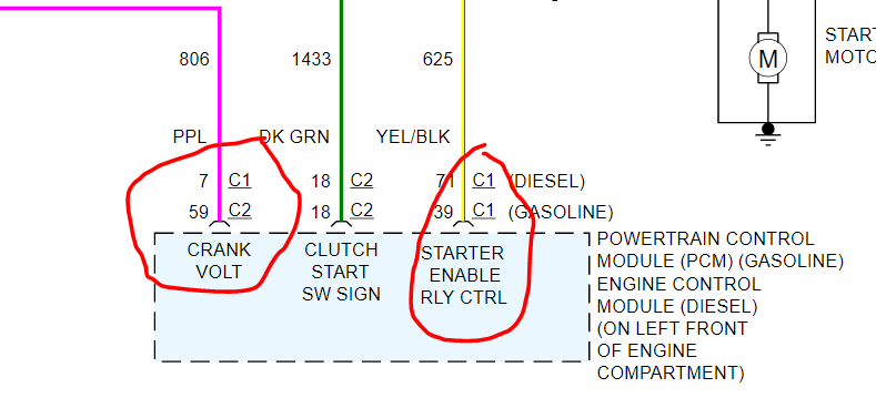

I have attached a few pics below. Before going to the relay sockets, check the fuses I circled in the pic.
Look at pic 4. I placed a + where there should be power when the key is on but not in the start position. The two sides of the relay that I circled power when the key is in the start position and allows power to flow to the starter relay.
One other thing. Confirm the wires on the PCM in pic 3 are not damaged. I have seen them fail.

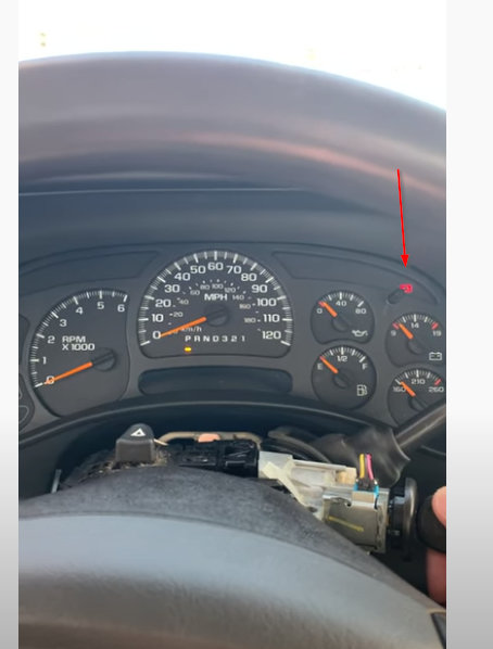

Truck listed above is the Classic model. The truck cranks, starts then shuts off. When this happens there are no gauge warning lights when the key is in the on position. Sometimes the truck will go for a week with no issues, then it decides to do this issue. Or I wait and keep trying to start the truck and the issue goes away. Other times, I let it sit for a day and the next day it starts and runs like there was never an issue. This has been goin on for eight months. Please see attached video for the issue.

While reading this I figured this was a fuel issue but that cluster is shutting off like the key was switched off. This is exactly why we love it when we get videos.
Just looking at this since it shuts off right away, that points to a theft issue. I can't remember but is that the theft light in the upper right corner of the cluster?
I attached a picture below. I am pretty sure that is a red lock which is the theft light. If you notice it stays on the entire time so we need to check for codes. Then we need to use a spare key because maybe the resistor in the key has failed.

The red light in the upper right is the battery light. The anti theft is in the upper left and it is amber. There are no codes coming up on the scanner. These are new keys with a new ignition cylinder.

It is odd that this light stays on the entire time so we should cross off the basics and load check the battery. Let's make sure it doesn't have a shorted cell. Here is a guide that talks about this:
You can just take it out and take it to a parts store and they will load check it for you. Let us know if the batter checks out and then we can figure out other reasons for that to stay on but all other lights in the cluster go off.
If the vehicle was just stalling then I would expect all the normal cluster lights and center message center to stay on as well but everything shuts off but that light so it is being shut down and a shorted battery would cause this.
