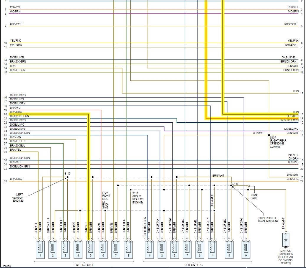

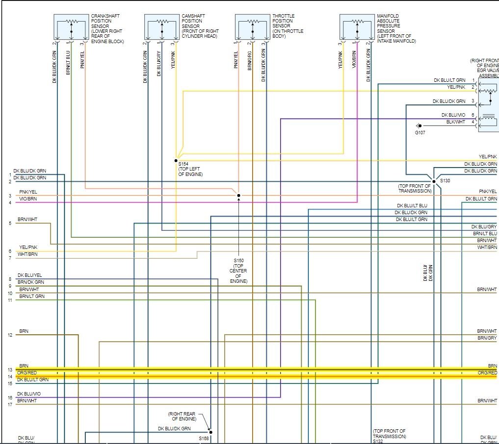

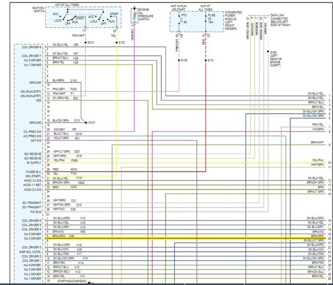

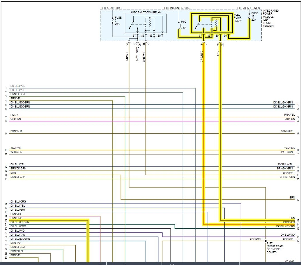

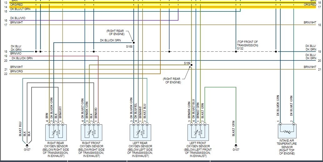

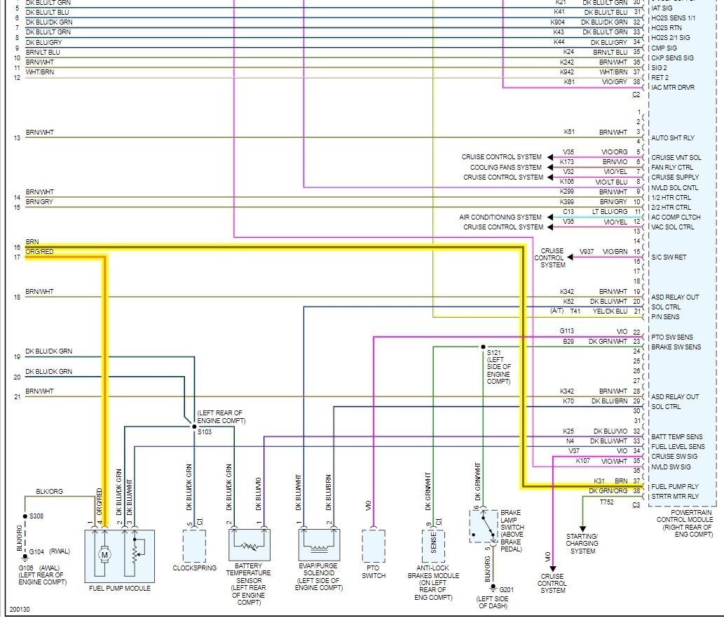

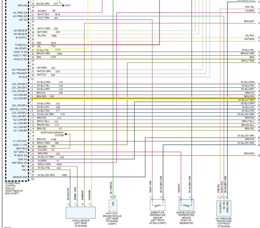

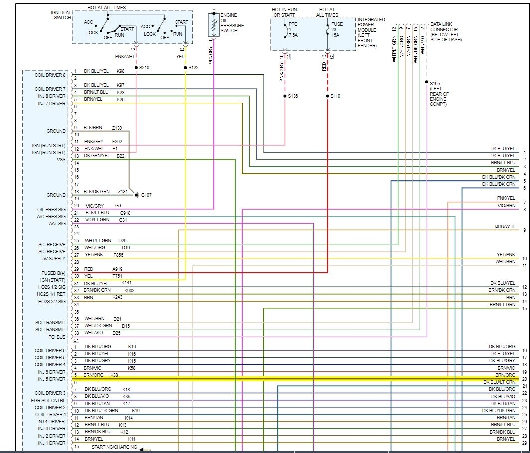

Changed fuel pump, no start.
Sunday, April 4th, 2021 AT 4:02 AM
MECHANIC
52,796 POSTS
Good morning,
Did you verify fuel pressure when you have finished the repair?
FUEL SYSTEM PRESSURE
58 psi ± 2 psi
Do you have spark? I attached a guide for checking spark.
Check the compression as well to be sure the engine is still good.
