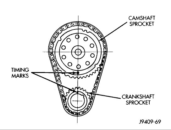

I finally bought a timing chain set. Have removed timing chain and camshaft sprocket. Having difficulties removing the crankshaft sprocket. Went to O'Reilly's auto and rented a puller. Looks identical to the harmonic balance puller, 3-jaws. I cannot seem to get the 3 jaws to hold onto the crankshaft gear. Keeps slipping off. Please can you help. I need ideas as to properly removing this gear. My truck has been down for a while now.
-1
Sunday, July 30th, 2017 AT 8:29 AM
KEN L
  • MASTER CERTIFIED MECHANIC
  • 55,291 POSTS
Here is what I do. First with the puller installed the best you can fasten a large hose clamp around the jaws and secure firmly. Next take a butane/propane torch and heat the gear slightly. This will make the gear come off easily. Next, heat the new gear in the over to about 200 degrees use a glove and it should slip onto the crankshaft with little force.

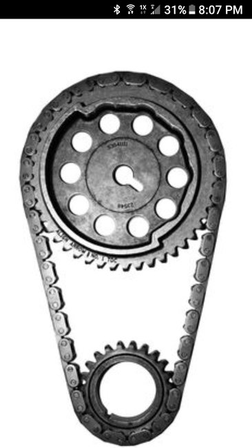

You say you replaced the timing chain and sprockets, with which year engine parts did you use? The picture shows the 99 cam sprocket, does the one you have look the same?

No, dont believe the sprocket pictured is the one I just installed. I did order a timing set off ebay. Came with cam and crank sprockets and chain. Stated it was one that was for 1996 thru like 2002. Thats the one I ordered. I did however time it according to the picture. No spark at plugs. Was informed that my issue was not installing the cam sensor correctly. Was told something about using a paper spacer between the cam sensor and the block then tighten the bolt. Is that so? Or if not true how do I test the cam sensor? I am mechanically inclined and do have a meter. Please please help me.

Here is the gear the top one
Wednesday, August 2nd, 2017 AT 5:11 PM
JOETRACYJOETRACY
  • 25 POSTS
Here is the gear the top one. Cam gear part number S798. The entire timing set part number 73153

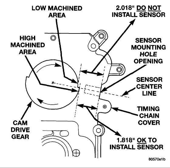

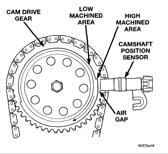

To set the air gap on the cam sensor the easy way is to take a single thickness piece of cereal box cardboard, put a dab of grease on the end of the sensor. Look into the bore to verify that the high side of the sprocket is in the hole. Then you slide the sensor in and LIGHTLY hold it in place. Now tighten the bolt. When you turn the engine over the first time it will slide the cardboard off and the clearance is set.

The best way is to install it, then mark the location and remove the sensor, then reinstall it to the mark. But I have done it both ways with no ill effects. I've also used two pieces of 3M post it notes when the system was being fussy. Basically the sensor reads the leading and trailing edge of the ring. The paper just sets a gap so the ring will turn and not hit the sensor. If it's set in the wrong spot the sensor will get wiped out the second it gets hit. New sensors come with plastic on them, you install them and the plastic gets shaved off after a couple rotations.

Your choice on the paper/cardboard. It is thin and won't hurt anything, but if it worries you, you can easily use some sticky paper or even a couple pieces of duct tape on the end, then make a mark where the sensor sets on the cover. Remove the sensor and remove the tape, reinstall the sensor. Line it up with the mark and tighten it down. The "special paper" that the dealers use isn't anything special, just a.030 shim of paper with sticky glue on it.
The image matches the one I have for the gears for a 99. So it should be correct.
