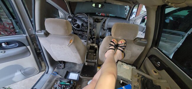

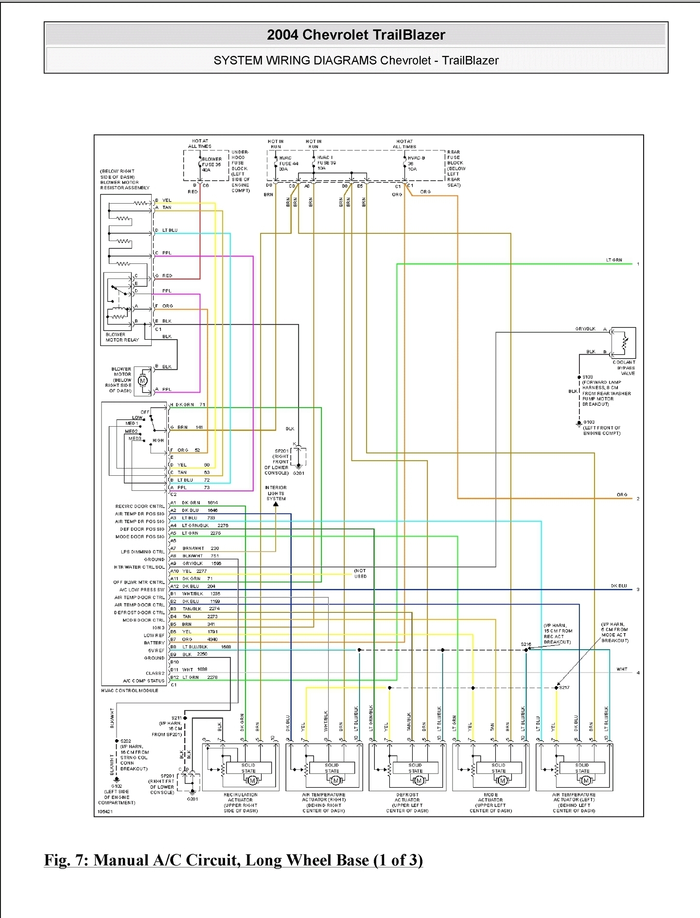

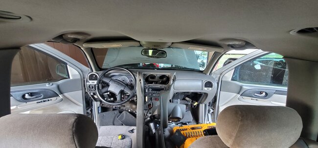

So, I checked voltage on the orange wire at c201 and at the ignition switch with the car running and got 0 volts (no light on the test light). I've already got this car half gutted and am trying to avoid any more carnage. In your best guess, do you think the issue is at the ignition 3 wire going into the fuse box? If so, do you know which orange wire it is? I have found nothing that appears burned so far but his vehicle is starting to look like I'm trying to find a hidden treasure, which, I guess, technically I am. The pic of the day is just so you can have a hearty laugh at this gal's expense.

Sorry to post back to back again, but if I'm looking at this right, ignition 3 wire becomes a brown wire at the fuse box?

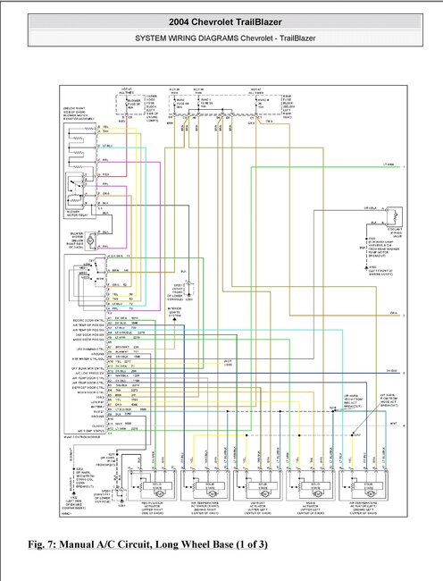

Your diagram does show different wire colors, but it's for a different model too. Don't know how similar they are in other respects.

Regardless of color, look again at the connector view for the ignition switch. There's three terminals in one row and four in the other. Terminal ""G" is at one end of that row of four, and terminal "F" is right next to it. Jump those two together with a piece of wire or a stretched-out paper clip. I bet the fan motor runs. Be aware the paper clip is likely to get hot.
If you check on terminal "F", you're going to find 12 volts all the time. I know that because that circuit feeds two other parts of the ignition switch, one being the starter relay, and that works. The 12 volts is not showing up on terminal "G". There's only the internal contacts inside the switch, and the connector terminal for "G" that can be causing the missing 12 volts.
If jumping "G" to "F" makes the fan motor run, and you don't see any signs of overheating in the connector terminal, pop a new switch in.
